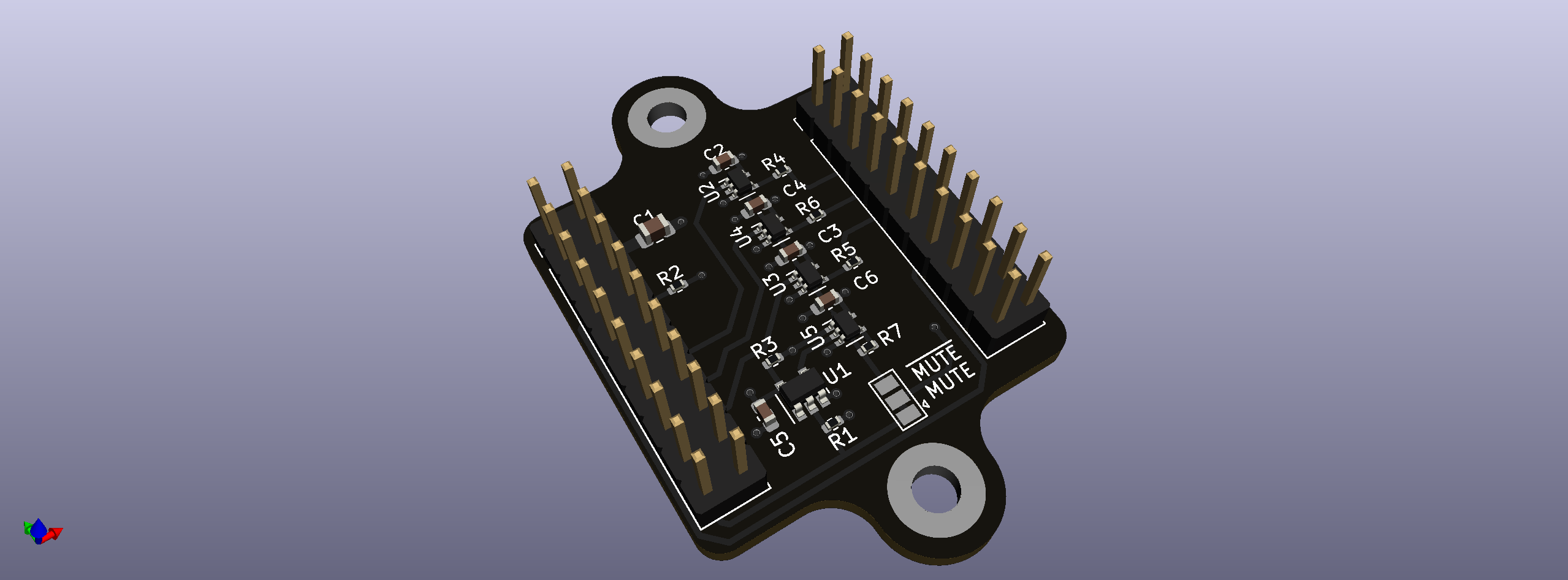

my problem is only implementation-wise for my current setup... as many people pointed out, should be only a problem for my personal non-senses... hence why i needed to design a "gating" board for the outputs.
