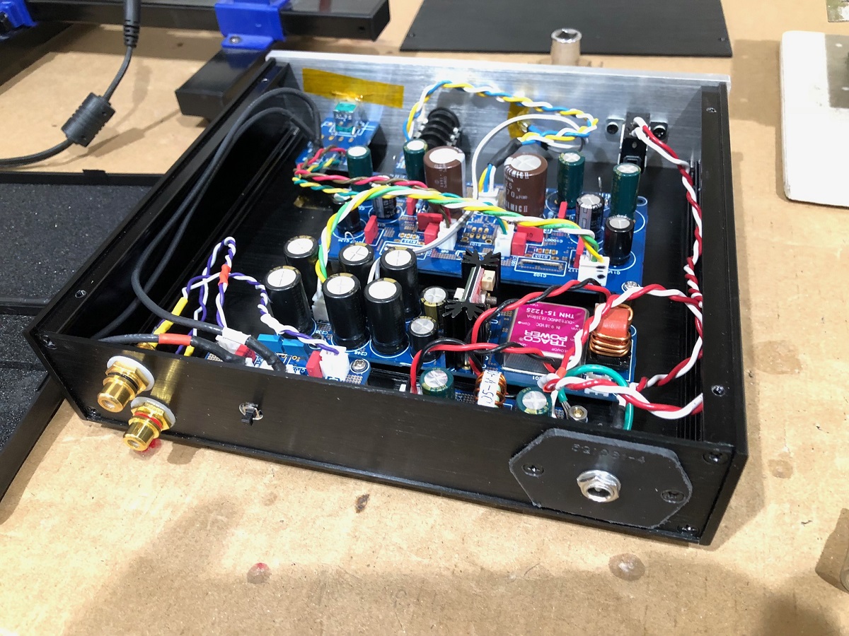

I finally got around to making an EIC cover plate out of a black piece of polyethylene plastic (organizer tray divider as stock). I basically followed an actual EIC mains cord socket that came with the case for the template. I then installed the 5.5mm barrel jack to allow a clean way to get 12vdc from a wallwart into the amp. You can also see the Xfeed defeat switch on the back.
