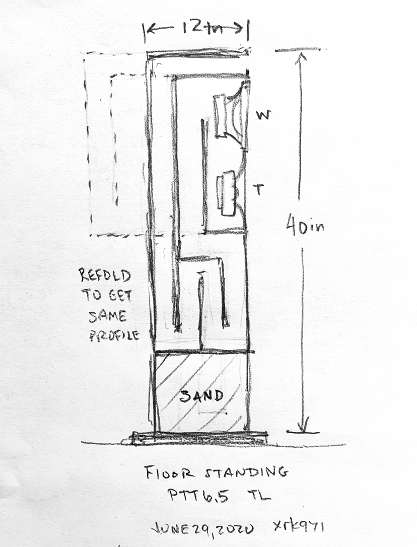

Perhaps of this was reformatted as a tall floorstander than only half as deep?
I’ll let you work out the details, but I think something like this gives the correct pleasing aspect ratio, keeps the vent at the same spot on top, and provides room to adjust the folding to keep a similar taper ratio. The sand ballast at the bottom improves stability and reduces vibrations too.

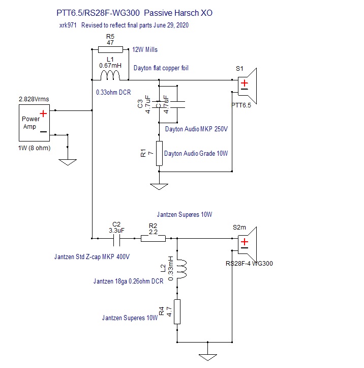

Very cool to see others trying this out! You have a premium T34A tweeter there - I am not sure if it will be the same crossover - only way to know for sure is to measure the response and model in Xsim. I don't think it is going to hurt to try it as is and see how it works vs the RS28F. Is the Bliesema 4ohms?
Regarding my inductor - 0.68mH and 0.54ohm is the temporary one, I used a 0.33ohm flat copper foil in the final inductor. If you have a lower value, it will increase sensitivity of PTT6.5 and compensate by using higher resistance on tweeter.

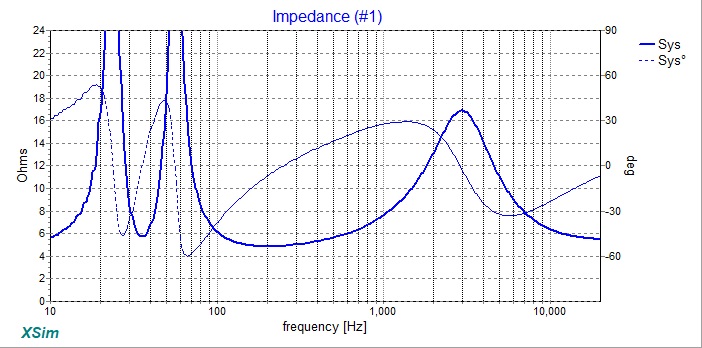

What I mean is that after the speaker is built, use a DATS or similar device and do an impedance sweep of the TL. You will see two peaks typical of a vented cabinet. The dip in between the two peaks shows the cabinet tuning frequency - about 30Hz or so. The two peaks on either side will be high without any damping (fiberglass or polyfill in the chamber from closed end to the first turn). Add a small wad of polyfill loosely pulled apart in this rear chamber and you will see the height of the impedance peaks drop and the height of the dip in between climb. Add enough to make the impedance look like a cat's head with two ears (maybe longer ears like a caracal). The shorter the ears, the drier the bass will be - tight and low group delay, but at the expense of bass extension and bass SPL sensitivity. The taller the ears and the looser and more bass reflex sloppy sounding like it will be. Although never as bad as a pure reflex cabinet because all those turns naturally provide aeroacoustic damping. The other place to play with damping is to add a piece of very porous reticulated open cell foam like used in fish aquarium external flow filters. Pores are circa 1mm to 2mm (not the dense stuff) to the final vent terminus. Another place to play with damping and it is very very sensitive is to add a very light wisp of damping polyfill loosely teased out (maybe 2 grams) worth in the final vertical channels at the back - accessible through the speaker terminal binding post cup. That will really flatten those cat ears on the impedance sweep. So do changes slowly and listen and measure. Pick what sounds best. Some people will used these near a back wall and have loads of room bass reinforcement - in which case, more aquarium foam on the exit helps to control room boominess.
Here is the impedance sweep from my RS225 TL for the 10F/RS225 FAST speaker. It is much bigger but shows you the power of this diagmostic:

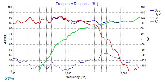

I should have posted my final as-built crossover as shown in the photo.
847366d1590432418-simple-passive-harsch-xo-using-ptt6-5-rs28f-waveguide-pcb-xo-speaker-02-jpg
attachment.php
Here is the associated predicted frequency and phase:
