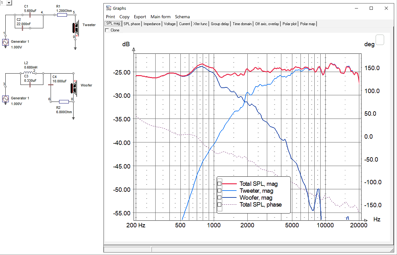

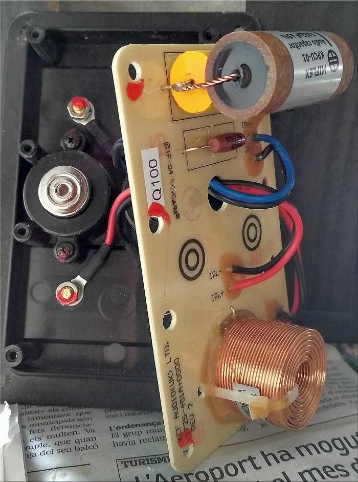

In my modified KEF Q100 I did the bypass first and the sound change was overwhelming, between the modified box and the one that did not. Hotel California (Eagles). In stereo was AMAZING.
Weeks later, with the new sound already memorized, also the cemented resistance of the tweeter by a Mills. Great change again, undeniable, but not as spectacular as the previous one.
The tweeter deserves quality components. Nor is it necessary to spend a fortune.
PS: Always the same two people present to check for improvement. I have to decide whether to change the original yellow capacitor or redo the crossover.
  • KEF-Q100-crossover-Miflex-KPCU-01-001uF-capacitor-Mills-06R8-5-watts-resistor.jpg

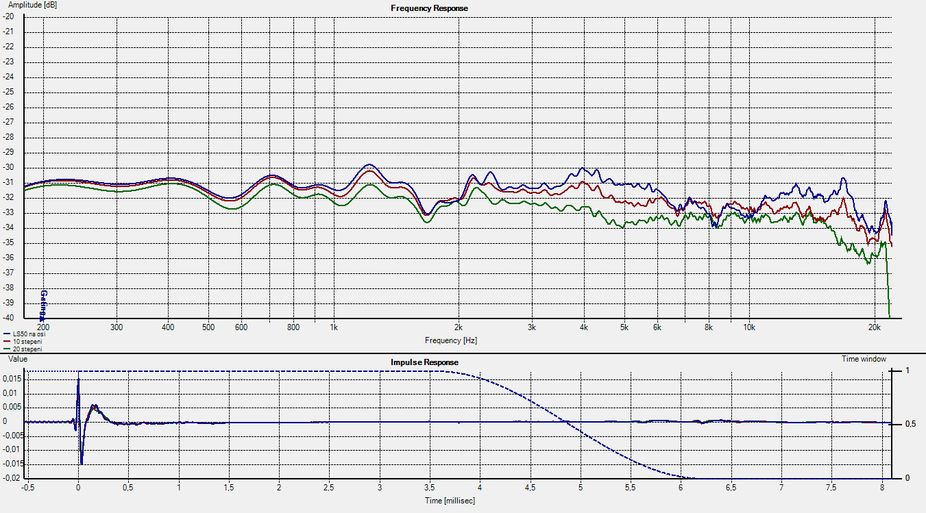

With a 2kHz crossover frequency, the delay required is 1/2 of XO frequency period. Or 0.5ms/2 or 250usec and physical delay to accomplish this is x speed of sound. 250usec x 342m/sec is 8.55cm. I don’t think the tweeter voice coil on the KEF coaxial is that far behind woofer. Maybe in a PA coaxial where the CD is mounted way in the back. But I don’t know. You will need to measure it using acoustic interferometry to know exactly. That’s where you record 3 sweeps: tweeter only, woofer only, woofer and tweeter in parallel. Changing only wire connections and do not touch mic or speaker. Then use software to simulate the combined signal until the ripples and dips all match by adjusting delay. Use that delay x 2 as basis for Harsch XO frequency.

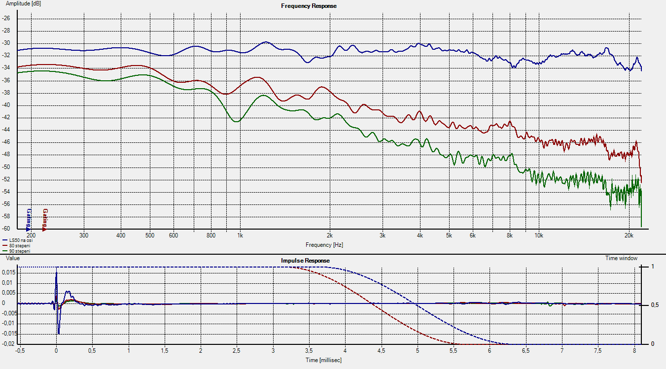

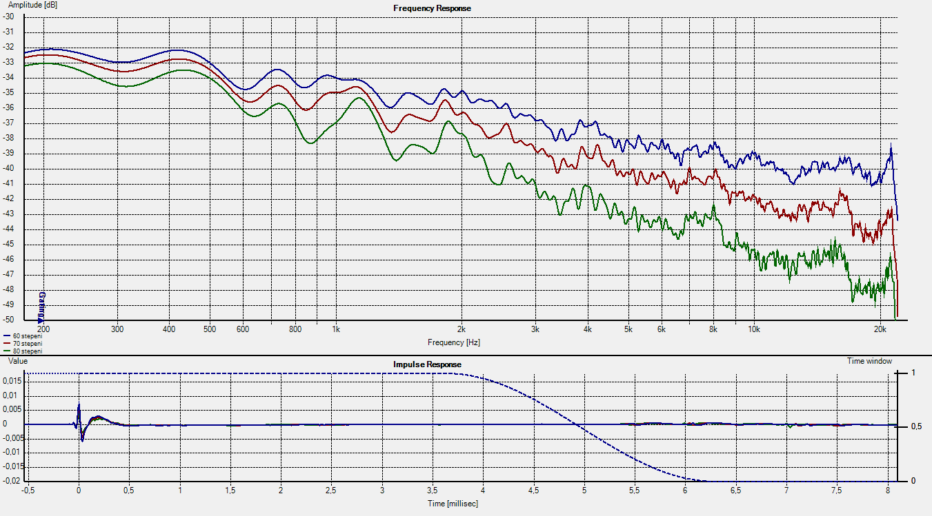

BTW, yours and KEF Q100 (measured by Zvu). And I no longer rave on the thread.

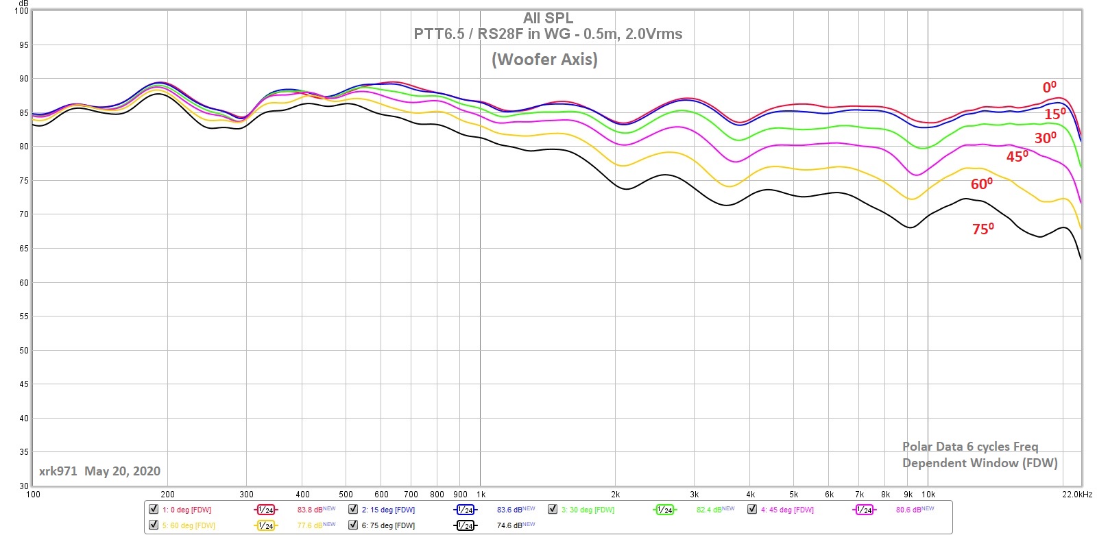

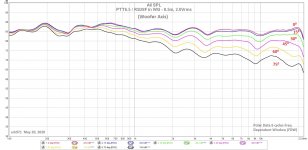

No worries, Maty. For the polar data from Zvu, what are the angles of the measurements? They look real nice though.

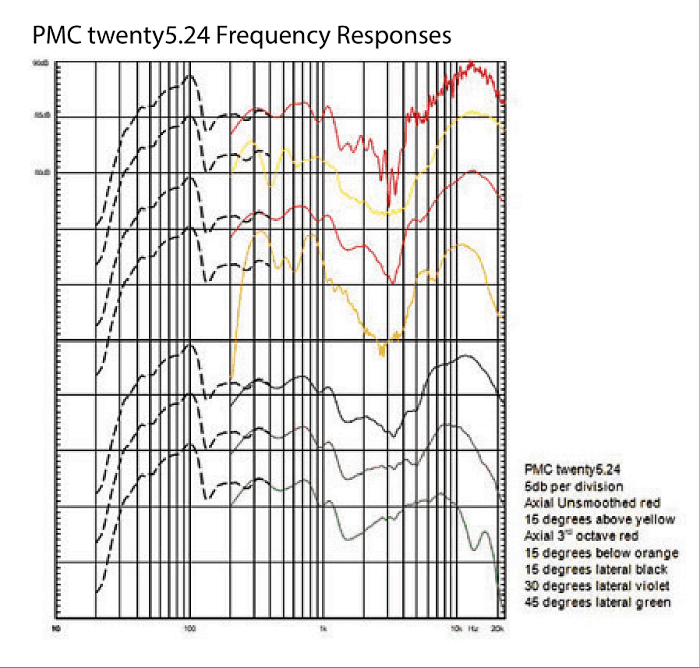

I just did a search from PMC's website and their dealer locater says NYC is the closest one. The PMC doesn't have a waveguide, and I am pretty sure doesn't have a transient perfect Harsch XO. However, the 89dB sensitivity figure intrigues me. It looks like they did a slanted baffle to get some time alignment (that could have been achieved with a WG which also gives killer polars).
