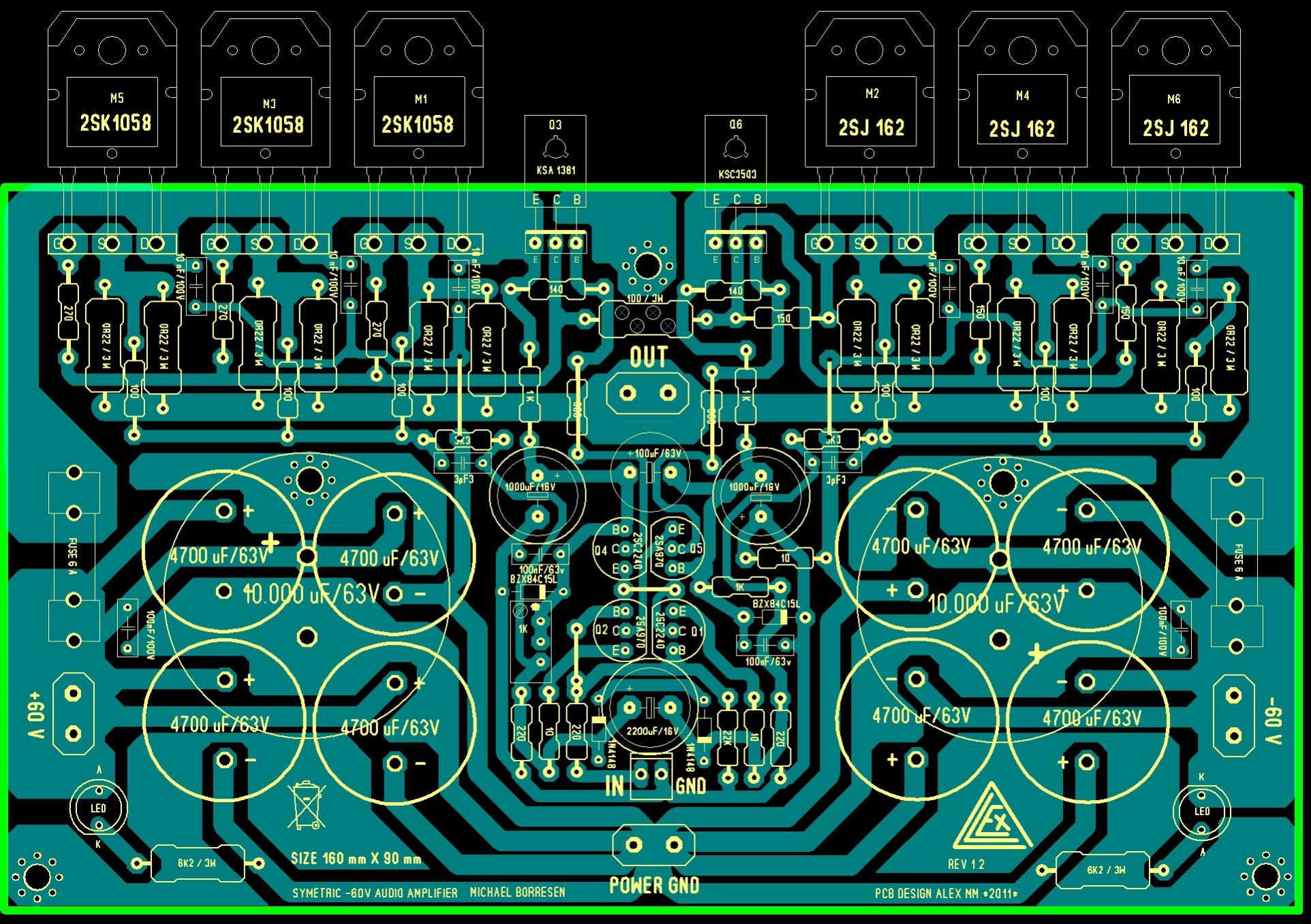

PCB rev 1.2 for MiiB and not only ...
....... I have done requested , hope to not forget something :) Space between input transistors are for small heatsink ....:D

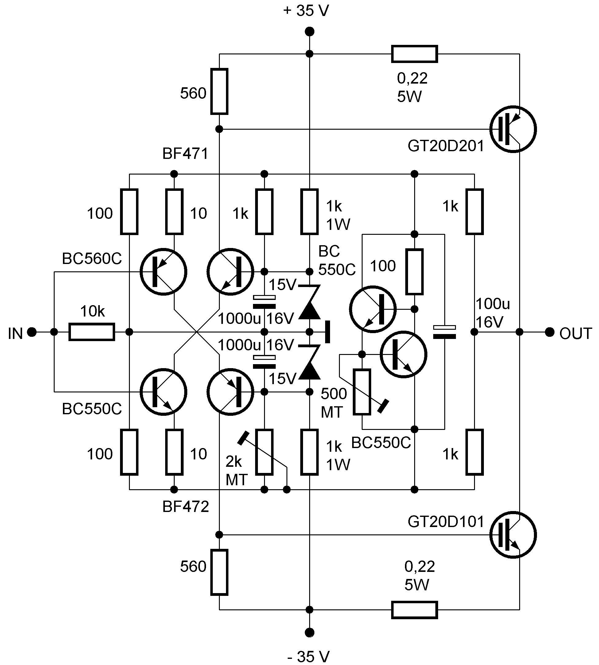

SSA IGBT version
To put another version to DIY maybe sombody will find this IGBT as the most suitable for him, lets see. :rolleyes:
Another comment to my yesterday test with real PWS is about PSRR. I am impressed how good the +/-15V DC rails are in real SSA amp. They completelly serve the purpose without any need to have regulated or other kind of +/-15V supply whatsoever.
The result is impressive, at the speaker's tweeter there is absolutely nothing, no sound, black silence. So we really need PCB LEDs to show power on operation. :D

DC offset stability
On more good thing about the SSA in any version, is DC offset stability. Once it set to 0V at the ouput, it is stable within +/-10mV regardless to thermal conditions of the output's heatsink. The only condition is proper thermal connection between input pair BJT's, so no need for any kind of DC servo circuits whatsoever. :cloud9:
Hi buzzforb ;)
It all depends to rail's voltage potential, if it is 35V like on this last sch, than you would have only 0,1W power on thermal dissipation + 0,07W max extra dissipation at full signal present. So for +/-35V BC550C/BC560C are OK. :)
For higher rail voltages and thus power dissipation you would need TO-126 case for cascodes BJT's, like BF471/BF472 etc. ;)
The most important thing to maintain quality of this symmetrical SSA design is gain factor equality for all complementary semiconductors in the circuit. The input pair is the most critical and it is recomended to choose current gain more than 600 +/-0,5% tolerance between NPN/PNP device, and similar to the other semiconductors. ;)
In simple designs like SSA is, it is allways very important to choose the best parts possible. :cool:

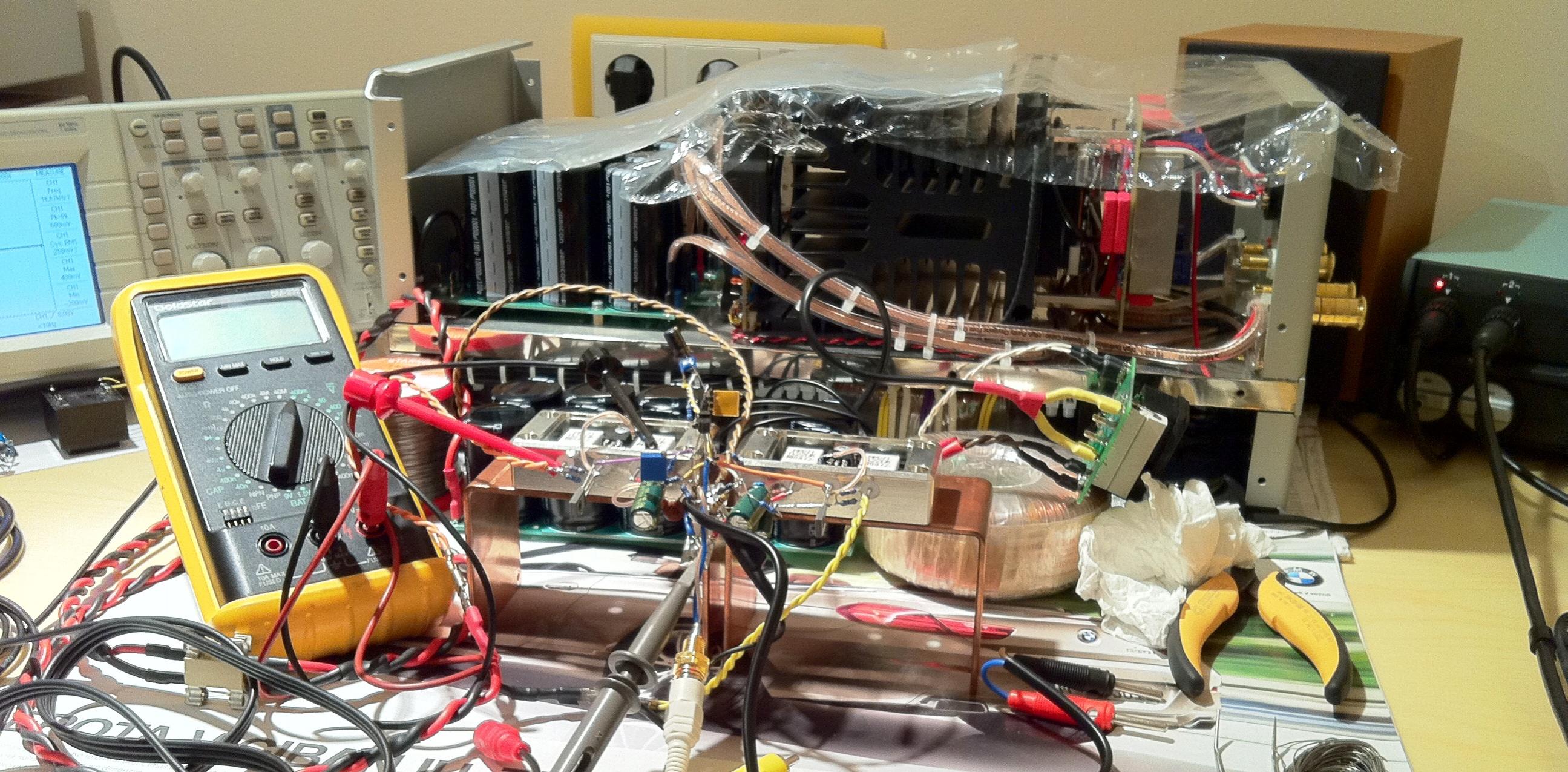

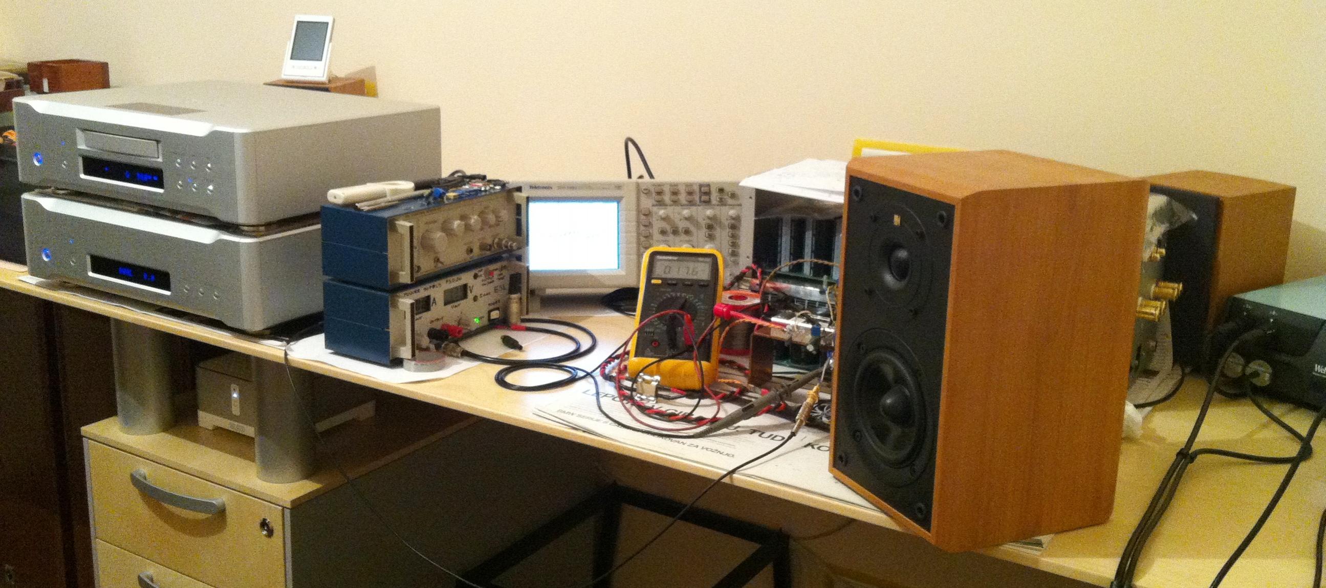

Later this evening I connected a sch from the post #217 to a real 200W power supply, +/-35V, 60mF caps bank to perform some more tests, at least that was the plan. At the end I only managed to make some small changes to Vbe multiplier but for an almost two hours I have listened to a music instead of doing some more measurements/experiments. Situation that happened so rarely in my DIY career - the sound was so good that I forgot to do anything else. The only explanation I can think of, to understand the sound quality presented, lie in the amp's phase-time-frequency characteristics. Sound was so naturally live when I went outside the lab, one could easily think it is the real stuff going in. :)

Hehehe ... right now I am listening to the SSA "spider network", can't stop cause it sounds better than any of my amps in the house, so my lab is now the place to enjoy the music. :D
P.S. In these days I found out one really important, very crucial info to me, that SSA's diff-amp CF stage is my favourite front-end ever ... will never go back to LTP !!! :cool:

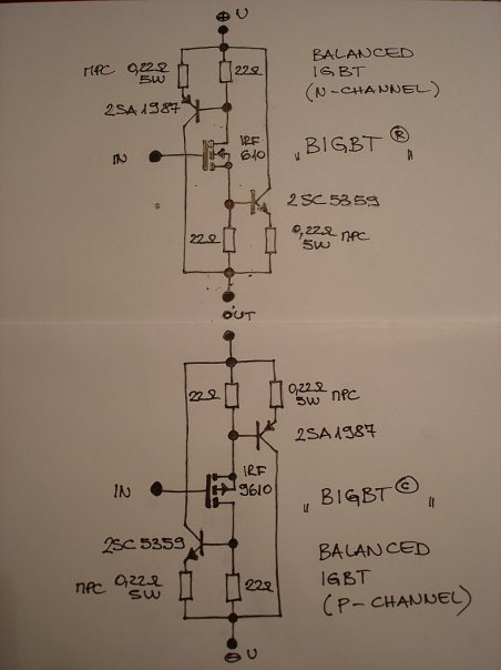

Are you using the same B-IGBT configuration on your current SSA amp setup or are you currently using bipolar transistor?
Hi Lazy Cat,
I am listening (also right now :D) to exact sch from the post #217. As you can see there are two BIGBT's on the output (shining copper cases, each having three connection pins), runing on +/-35V. ;)
There is 0mV at the output at cold turning on (this morning), no turn on bump whatsoever, and still 0mV when hot. With these improvisational copper U-shape heatsinks (on the pic) it goes up to 70°C and more, but it is good to have overheating test as this is beeing performed to find out the best Vbe multiplier version to hold bias nearly constant. :)
