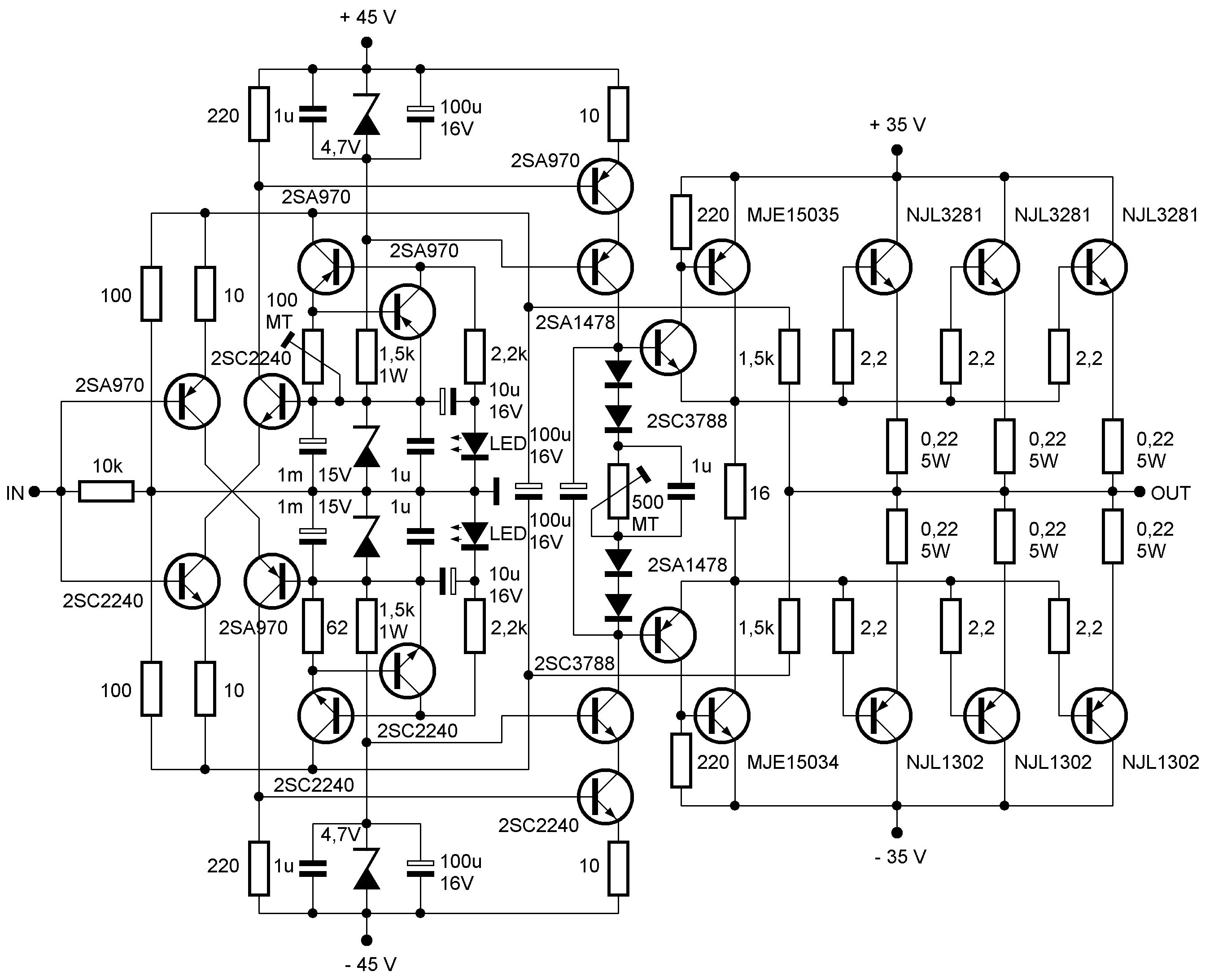

SSA High Performance
If someone would like to make high performance SSA, here is my proposal. Of course I could make it even more complex but I think this one would have enough zeroes for minimal THD lovers. ;)

Normally with thermal track BJT's, integrated diodes are used to compensate the thermal drift, how many diodes will be in the bias loop depends on two factors:
- correct DC voltage to set the output stage quiescent current
- thermal drift cancellation
So if Roender used five TT diodes in this output stage than you could do the same. For the DC bias voltage purposes four of them plus 500 ohm trimmer are enough.
If someone would like to use regular BJT's as output devices, than Vbe multiplier should be implemented instead of serial TT diodes. This solution also requires some fine adjustments to cancel thermal drift to minimum. ;)
As I understand it, if the diodes had the same characteristics as the transistor junctions, then one diode per transistor diode drop, plus a small amount of series resistance, should be enough to bias the outputs and also compensate for thermal drift. But it appears that the tt diodes are not an exact match for the transistors. Or perhaps the mismatch is with the cfp junction. Hence, five diodes instead of four for Roender's output buffer.
Perhaps your schematic with a single output pair would be adequately compensated.
Sheldon
For six TT outputs like in present topology all six diodes would overcompensate thermal drift, four serial TT diodes would fulfill voltage criteria, but five are according to Roender's experiences just right. This is the least critical part of the design and can be made as selectable on PCB. ;)
The Roender style output stage had a variable temp co.
He chose the diode current to fine tune the temp co. to what the triple required.
If you go for a 2pair output stage then only 4diodes are available.
I think you will find that the temp co. @ Roenders diode current will be under-compensated. However, I seem to recall that increasing the diode current (more VAS current) brings the temp co. back up again.
Actually, I want a single output pair. With LazyCat's single pair version, it may be slightly undercompensated. I guess that one could experiment with an additional diode of various types to dial it in. If the diode is mounted to one of the outputs, it might be good enough.
My experience with Roender's amp, is that the compensation is fine. Little drift during warm up. The VAS current (2mA) was not changed from the original schematic (he did give an option for higher driver current).* In fact, the added series resistance, when adjusted for about 18mV at the emitter, is only about 50R. I built two amps. The tt diodes do show some variation. In one channel, I had to bypass a particular diode out of the six to be able to set the bias.
*In LazyCat's single pair version, the current through the diode string is significantly higher, so perhaps two diodes may be adequate there. And for the same reason, maybe 4 diodes for the cfp version would be fine.
Sheldon
Has someone checked the output offset stability in respect
of temperature variation ?..
So far, the sims say that the shift is about 100mV/25° , that is 4mV/°C.
A servo can be necessary.
At this case simm is wrong. :D
I extensively push hard the temp of the whole amp stages and there is none offset temperature dependency. I measured max deviation of +/-10mV DC at output pin, also explained this in some previous post already, so no DC servo required. ;)
