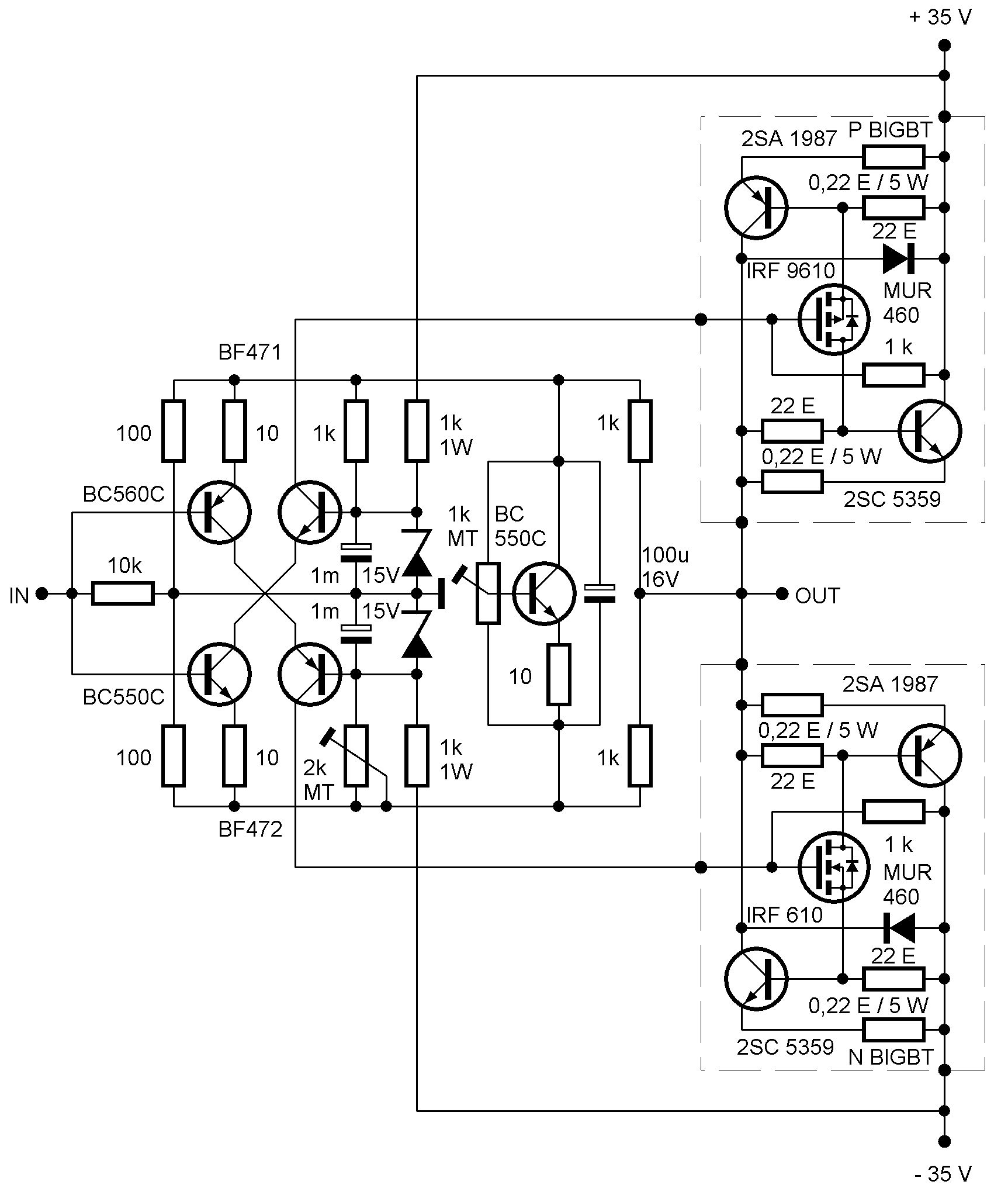

This PCB will enable anyone to check the sound of the SSA BIGBT Basic version. 😉
I will detaily check the PCB and let you know about all remarks soon, latest tomorrow. Thanks again Alex 😉

I added the 3.3 pF FB capacitors only to band limit the amp in case of spurious pick-up from the speaker cables. Some FM tuners 10.7MHz can radiate IF and the amp can still operate at that frequency.
Regards
Nico
Hi Nico,
You posted this a while ago - Post #320.
Did you change the C12 & C13 from 12pF to 3.3pF?
You also said that you would implement some of the MiiB's changes, can you please post your latest schematics?
I plan to build the SSA with one pair of L-MOSFET running with 38V DC rails.
I will change AlexMM's layout a bit so that I can use 30mm (10000uF/50V) caps.
Best regards, Stanley

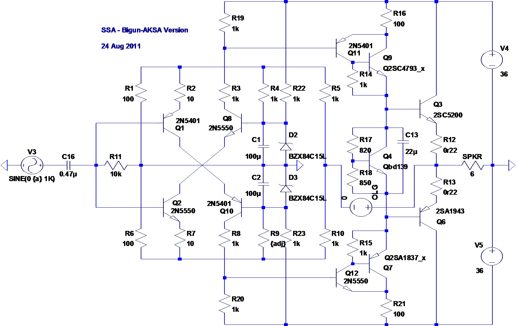

Alex, so this is now schematic from post 217 ?
Alex mm, well done!
By which schematic this was done PCB?
Regards
The upper one, from post #401, that is the SSA from my latest listening test. 😉
It is almost the same as from #217, only emitter resistor is added to Vbe multiplier to track tempco more accurately. Otherwise the same sch. 😉
I like your approach, Bigun. Very elegant, and the emitter driver output will have low impedance and drive the output stage very well.
Let's see, base to rail resistor for predriver would be 1K, we could run the driver quiescent at around 30mA, and this means, assuming cascode current is 2mA, the predriver emitter to rail resistor would be 47R. With a Zout at each driver emitter of around 1R, you'd have enough drive to propel the USS Nimitz, and of course nice local feedback around the driver circuit. One change, however; I'd put a 1K resistor from emitter to base on each driver to ensure residual current at all times through the predriver.
Hugh
PS I'm not dead sure of the cascode current, but 2mA seems about right to me.
Hugh
Thanks Hugh for that input, it does indeed need these things to flesh out the design and it's good to know that you also have some confidence in this version.

Hi Lazy Cat (Hi Slovenija)!
I have a few questions about this amplifier.
Is it can replace the bias transistor BC550C with BD139 (better is to mount the fridge) or some are needed changes?
For the output transistors can be used ate MJ15003/MJ15004?
In the end, I ask you in a few sentences if you are able to explain how this amplifier?
It will be interesting for electronic amateurs!?
thanks and cheers !
Is it can replace the bias transistor BC550C with BD139 or some are needed changes?
thanks and cheers !
Hi there 😉
I will check both Vbe/temperature curve dependency and if OK, than we could use BD139 because of an easier fixation to the main heatsink. 🙂
MJ15003/MJ15004 are "strong" enough, have small hFE + gain bandwidth but it would work, though I have never used them in fast CF amp as SSA is. 🙄

MJ15003/MJ15004 TO-3 devices are conditionally acceptable, if you have them, you can give them a try, but I suggest to use more modern semiconductors for SSA design, because of its essence comming from the bandwidth. 😉
