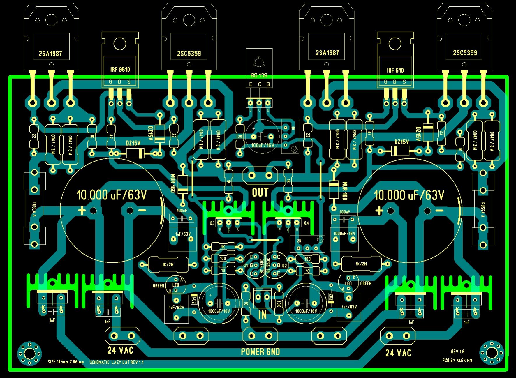

PCB SSA BIGBT BASIC 1.1
..... acording to new schematic SSA BIGBT BASIC 1.1 I have layout something but i will finish tomorrow , it's late :)
Alex.
