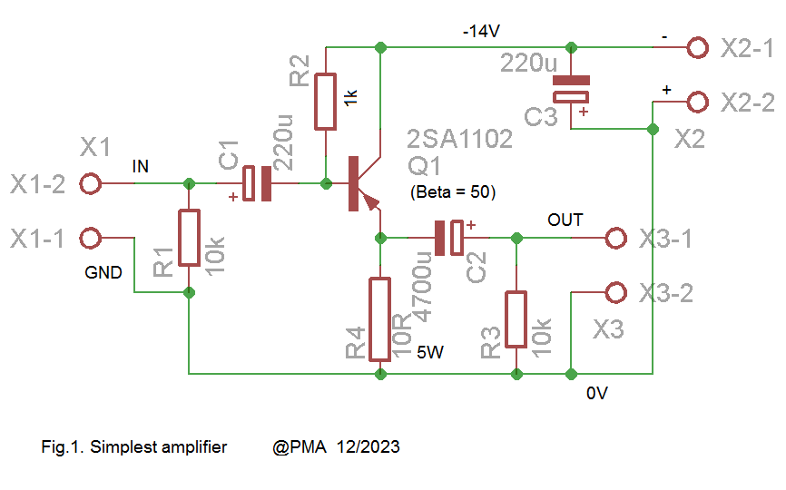

The circuit is a class A emitter follower with a BJT power transistor. It has voltage gain close to 1x, so it makes no voltage amplification. But it has current gain, thus also power gain, so it is a power amplifier, though with very low power, if we do not want to build it big with large heatsink. Emitter follower has almost 100% series voltage feedback, so it cannot be called “no-feedback” amplifier. Such qualification would be misleading. Due to this strong negative feedback the emitter follower has quite low output impedance, between 0.1 – 1 ohm, depending on the transistor used and also on signal source output impedance. The drawback of BJT follower is quite low input impedance, for load 4 – 16 ohm and transistor h21E about 100, we can count with input impedance 300 – 600 ohm approx.
The real circuit
Erratum: C2 = 6800 uF
C1 is an input coupling capacitor. R2 is a base bias resistor that sets the idle current of Q1 transistor. Q1 is PNP Sanken 2SA1102 transistor, just for the reason I had them in stock and they fit into my heatsink used for the amplifier. NPN transistor can be used as well in case that all electrolytic capacitors would be reversed in polarity. R4 is an emitter resistor that defines idle current and also limits the maximum current and power into the load. C2 is an output coupling capacitor. R1 and R3 are the discharging resistors to prevent loud clicks when speaker and signal source are connected. C3 is a power supply bypass capacitor. Idle current is set at about 450mA, which makes about 4W idle power loss of Q1 when supplied from 14V. Power supply voltage may be between 12 – 15V. Heatsink used is Fischerelektronik SK409/25, Farnell #4621293.

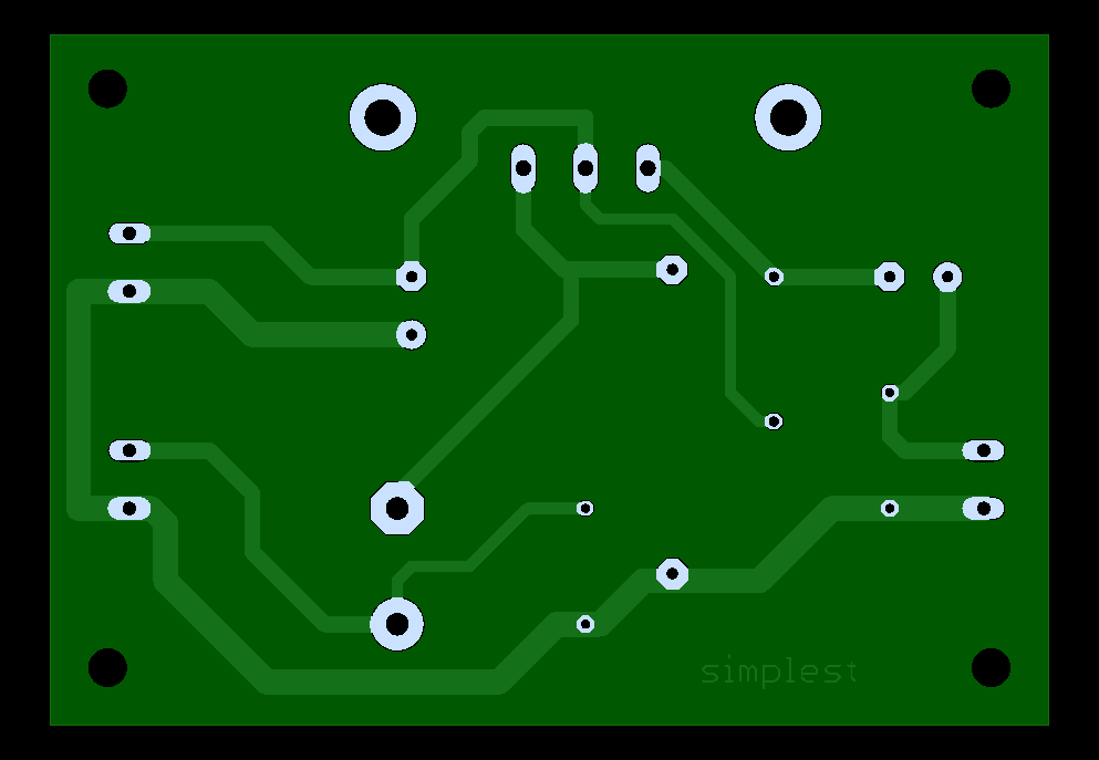

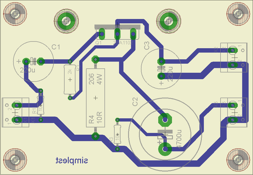

PCB board
The amplifier was built on a 2-layer 87.6 x 60.6 mm FR4 PCB. Produced in China, 5 pcs of PCBs cost 5.00 USD total + shipping cost. Incredible. 2-layer board is only for the reason of reliability, the solder joints would not peel off even if overheated.

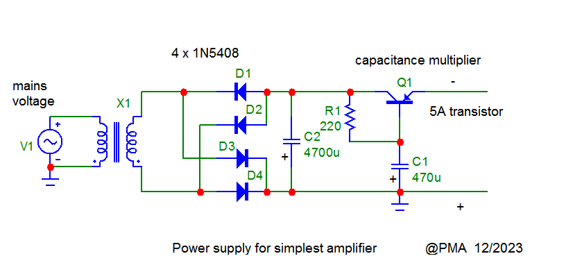

Power supply
Due to not great power supply ripple rejection of the circuit, a small sealed 12V accumulator is an option. That's how I started to test it. Then I built a traditional bridge rectifier followed by a capacitance multiplier. As the current consumption of the amplifier is almost constant, the capacitance multiplier is a good choice that grossly reduces PSU ripple.
Setting Q1 idle current
Please have a look at schematics above, Fig. 1.
R2*(IE/(Beta + 1)) + VBE + R4*IE = 14V (PSU voltage) (1)
R4 = 10 ohm and we want IE = 0.45A, so R4*IE = 4.5V; VBE = 0.6V; Beta = 50
Calculate R2 from (1) as 1009 ohm, rounded to 1k
So we have R2 = 1k and R4 = 10R.
The capacitors C1 and C2 are chosen not to restrict low frequency response extension.

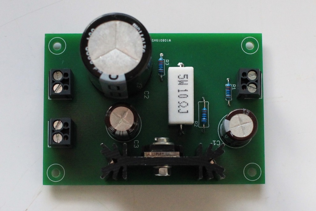

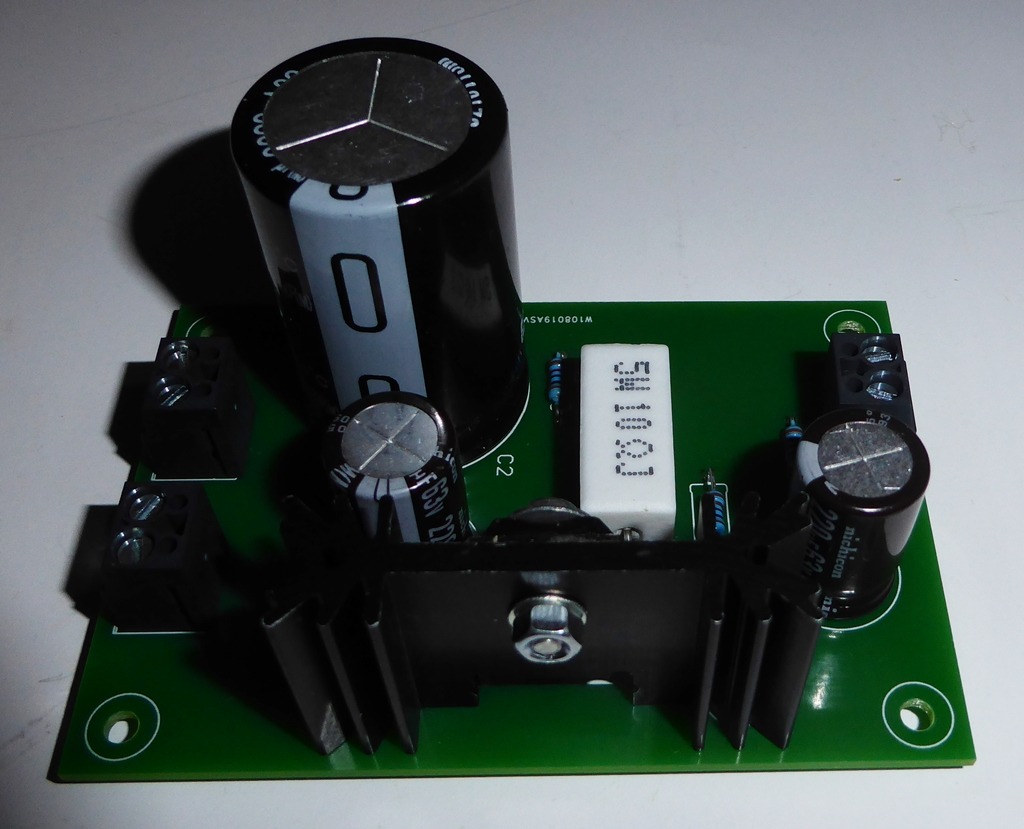

Real amplifier sample
Looks like this:

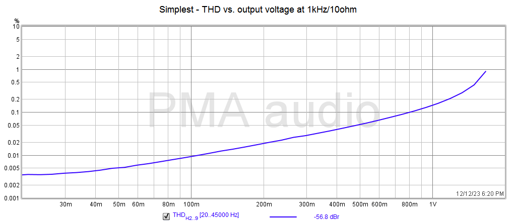

THD at 1V/10ohm ….. 0.2%
THD vs. level and frequency ….. see plots below

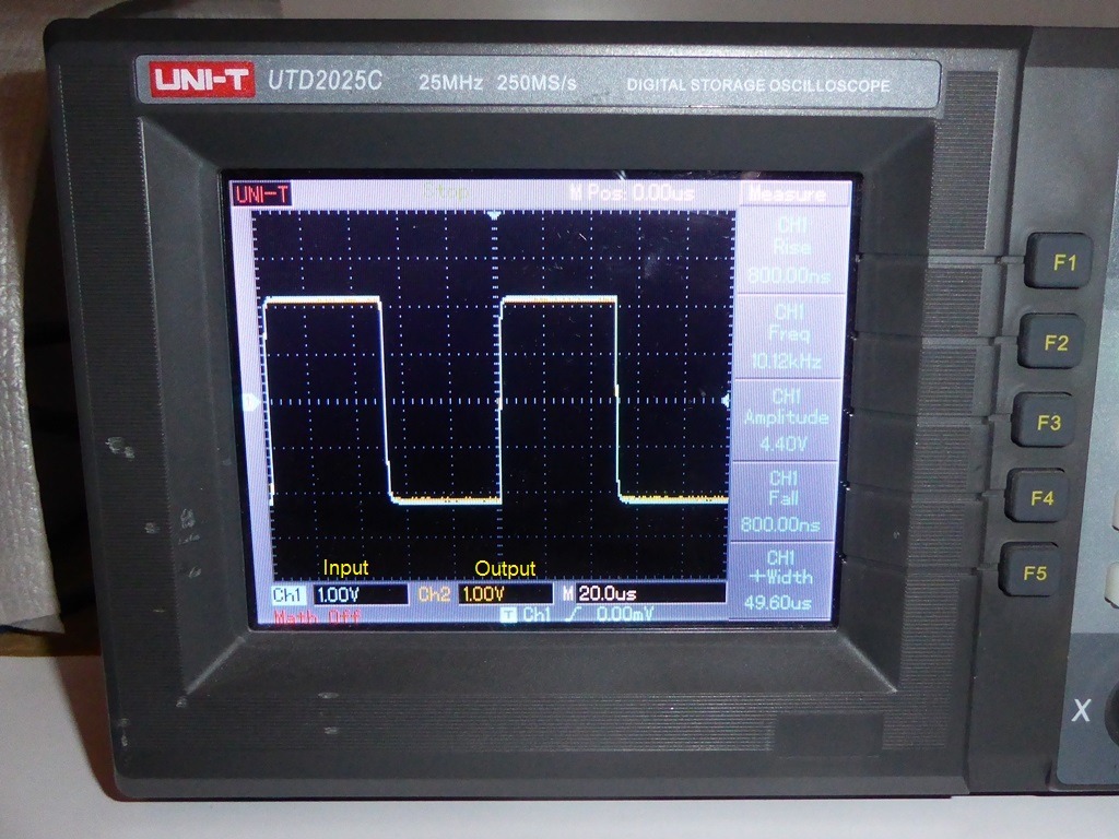

10kHz square input and output

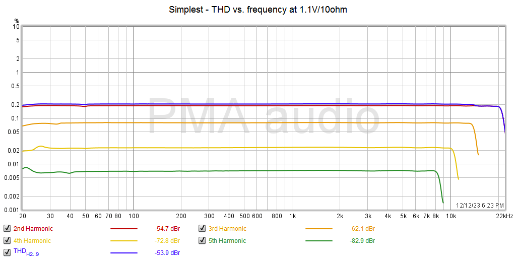

Distortion measurements
THD vs. frequency
THD vs. level

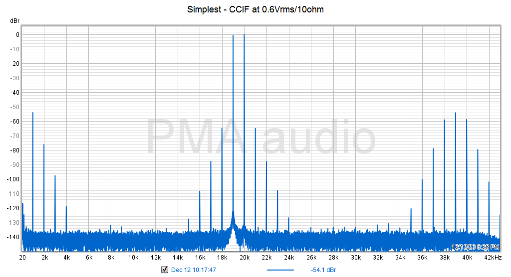

IMD 19+20kHz

PCB board
![Fig2_simplest_PCB_toplayout.png Fig2_simplest_PCB_toplayout.png](https://www.diyaudio.com/community/data/attachments/1153/1153772-cc1e95190a9d648d6008e5776d3b682a.jpg)
![Fig3_simplest_PCB_bottom.png Fig3_simplest_PCB_bottom.png](https://www.diyaudio.com/community/data/attachments/1153/1153773-78fdf715e9bf6f62b013660781853358.jpg)

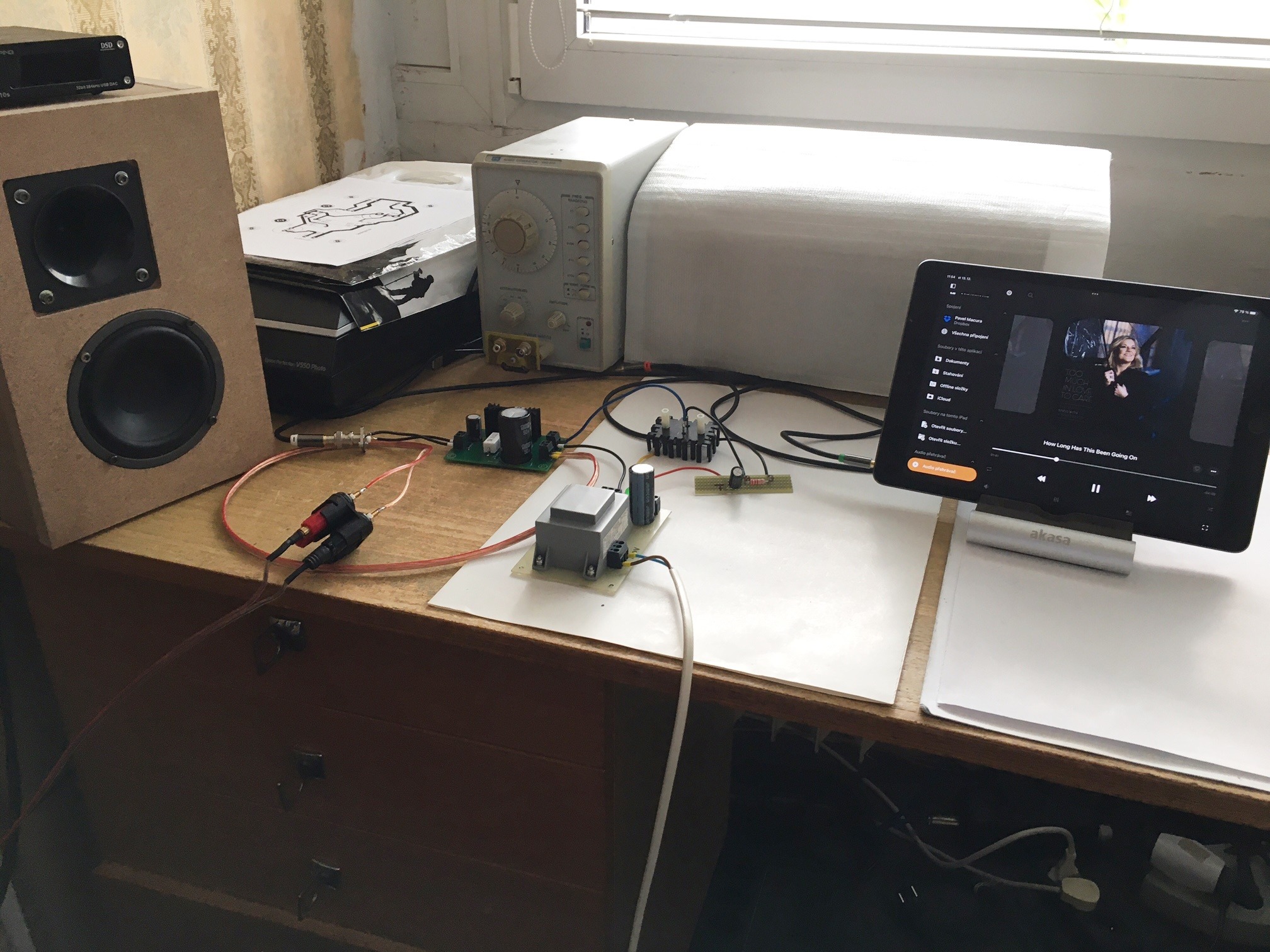

Looks like this:
![Fig5_IMG_4577.JPG Fig5_IMG_4577.JPG](https://www.diyaudio.com/community/data/attachments/1153/1153775-252be889cba11571bd940dd60b89b01e.jpg)
![Fig6_P1050621.JPG Fig6_P1050621.JPG](https://www.diyaudio.com/community/data/attachments/1153/1153777-0eea4b4ba65e82167f29b766807d3334.jpg)

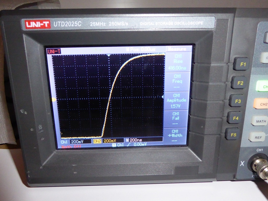

Frequency range ….. 20Hz (-0.5dB) – 10MHz, not limited by slew rate
Rise time of step response ….. << 100ns

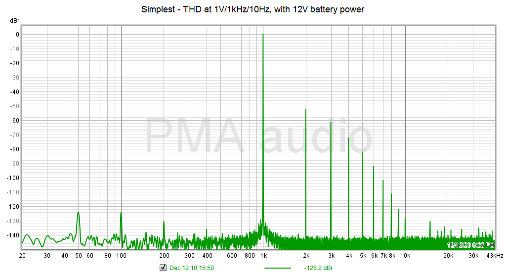

![Fig8_10kHzsq.JPG Fig8_10kHzsq.JPG](https://www.diyaudio.com/community/data/attachments/1153/1153778-7c9c5ba38ea3e45a6db7c73f1c228044.jpg)
Fast rising edge of step response, input and output
![Fig9_Step_I_O.JPG Fig9_Step_I_O.JPG](https://www.diyaudio.com/community/data/attachments/1153/1153779-b11572e1697687500543a1d2955db4b2.jpg)
THD vs. frequency
![Fig11_Simplest_sample_thdfreq2.png Fig11_Simplest_sample_thdfreq2.png](https://www.diyaudio.com/community/data/attachments/1153/1153781-00870b53fd14d5c1c2723d333e851014.jpg)

THD 1kHz
![Fig13_Simplest_sample_thd1k_bat.png Fig13_Simplest_sample_thd1k_bat.png](https://www.diyaudio.com/community/data/attachments/1153/1153783-33c918e2d11e17e73b4b6ed09f620534.jpg)

![Fig14_Simplest_sample_ccif_bat.png Fig14_Simplest_sample_ccif_bat.png](https://www.diyaudio.com/community/data/attachments/1153/1153784-2e0a636266441f12e006224e75f1d4d2.jpg)

This is how I test it by listening. Sound source is iPad headphone output. iPad is a very good sound source, BTW, with good recording. The speaker is 2-way with usual sensitivity of 87dB/W/m. Its impedance is 5ohm and more (dep. on frequency). It plays loud enough for a desktop listening. The follower starts to clip only at highest volume setting of the iPad. My usual listening level with this toy is up to 0.5V.

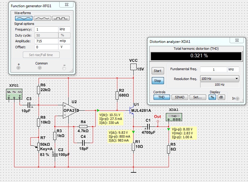

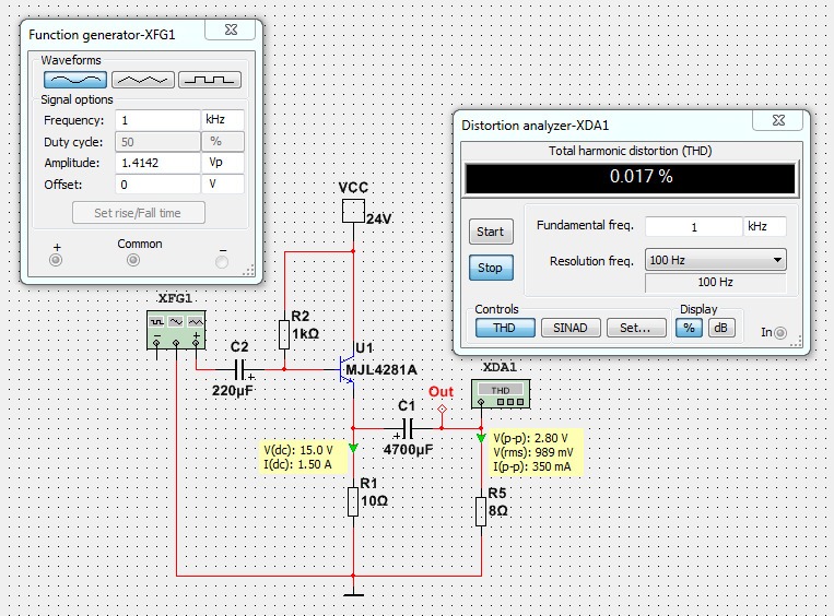

Here is a circuit using MJL4281A. Has high gain. >80
What I did was using power supply 24V.
To produce 1 Watt for example you will need an input >4.0Vp.
We need a preamp to do this. Which make it a more complex system.
But with an input of 1Vrms it will be okay if your speakers have high sensitivity.
@lineup , with 24V and 1.5A idle current you will have power dissipation of U1 equal to 13.5W. This would need big heatsink. My SK409/25.4 heatsink has 8.2K/W thermal coefficient. Maximum transistor case is TO-3P. MJL4281 has TO-264 case, too big. With your setting the heatsink would be warmed of 110.7 deg Celsius. Final temperature would be more than 130 degrees Celsius. This is too much. In my design, the heatsink is warmed of 37 degrees Celsius. Quite a difference.
