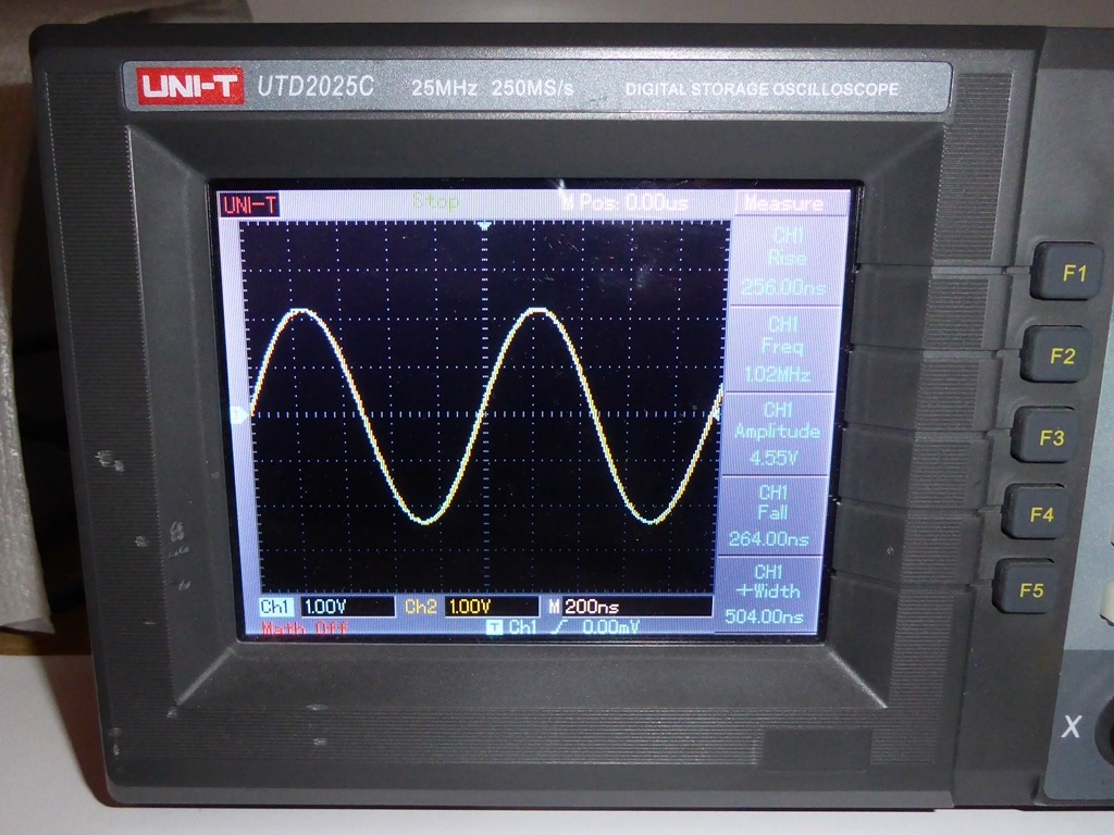

Again, voltage gain is not the same thing as beta. At 1MHz, output is still a copy of input, no sign of phase delay. From post #1 :fT divided by beta is up around 200 kHz. There is just nothing to cause roll off.
https://www.diyaudio.com/community/attachments/fig10_1mhz_i_o-jpg.1245879/
When I use my fast impulse generator with 10ns rise time, there is still not much difference between input and output rising edge.

fT is defined as the current gain - bandwidth product (Technically where |h21| falls to unity, but close enough for government work). Divide by beta, and it roughly gives the bandwidth (where roll off starts as a unity gain follower). Where you are taking full advantage of the transistor’s gain, that’s the achievable BW. If fT is 30 MHz, and beta 150 you can expect 200 kHz BW. The real bandwidth is more determined by the forced beta of the circuit - if full current gain is not needed, it simply goes out further before rolling off. Driving off a 32-ohm capable headphone out with an 8 ohm load is only a forced beta of 4, or from a 50 ohm output of a sig-gen would be about 6. You can easily see a 5 MHz roll off point. Pretty damn flat. Drive it from a higher impedance source and you’ll see the breakpoint creeping in on you.

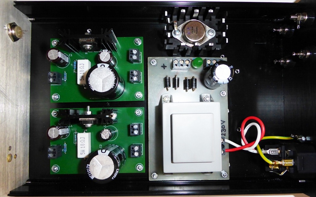

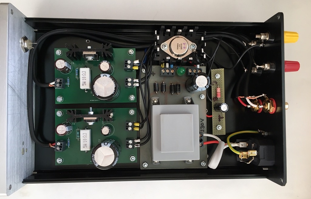

So, the stereo version has been completed, in the Al metal case, with all wiring, power supply, capacitance multiplier and connector.
It is now happily playing in my workshop.

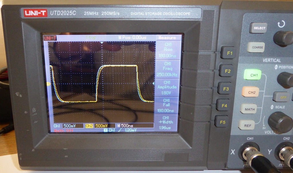

Almost everything has been already said in post #1 together with necessary measurements, so one more that shows 250kHz square response, both input (blue) and output (yellow), and we can read some small delay in the middle of the rising and falling edges, remember the time base division is 500ns/div, or 0.5us/div. So definitely negligible for any kind of audio or bat frequency signal. The load was 8ohm.

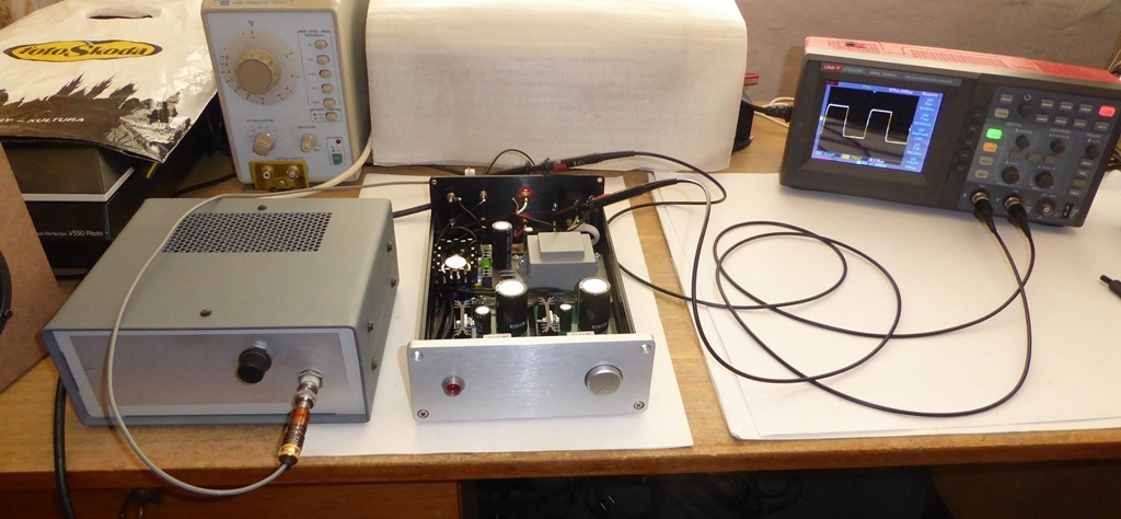

The last one is a view to my test bench, with the amp running, on the scope screen we can see 100kHz square response, I/O

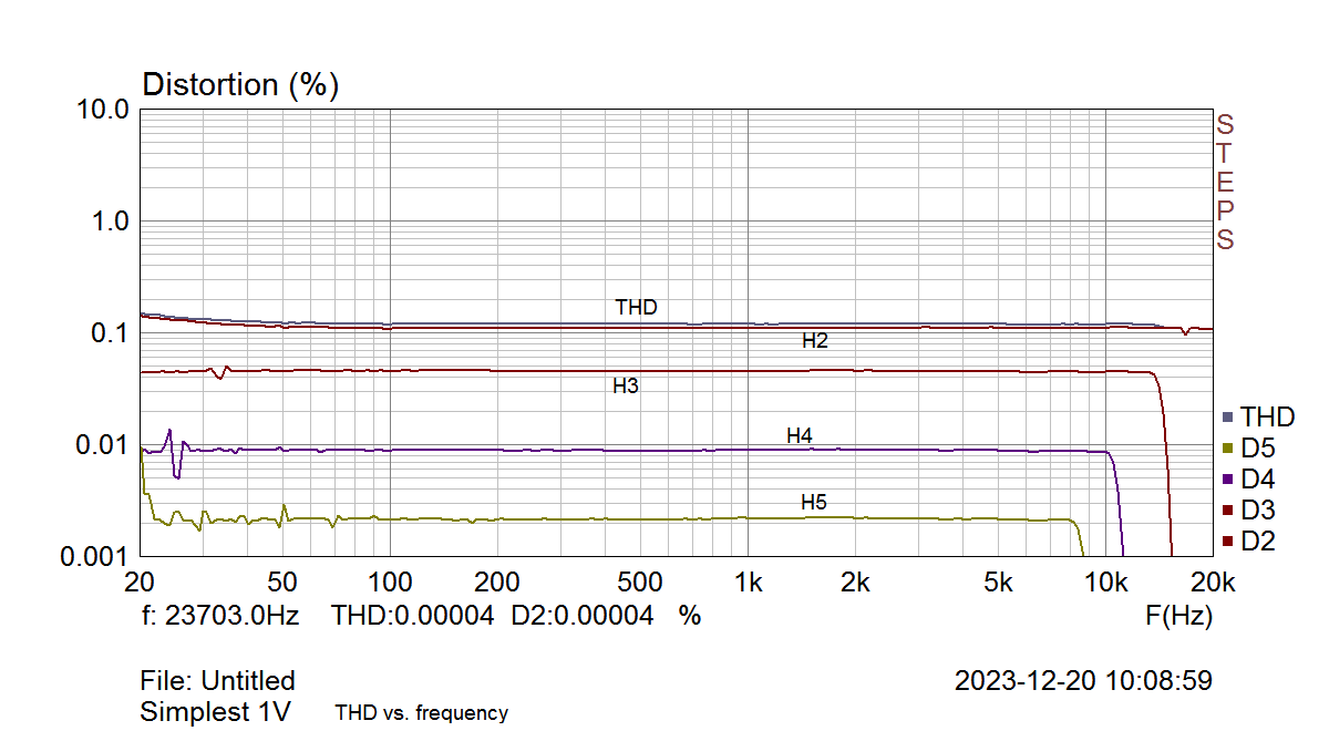

The nonlinearity of this circuit is a textbook, frequency independent (in audio band) transfer function. Below please see THD vs. frequency plots of total harmonic distortion and H2 - H5 harmonics.

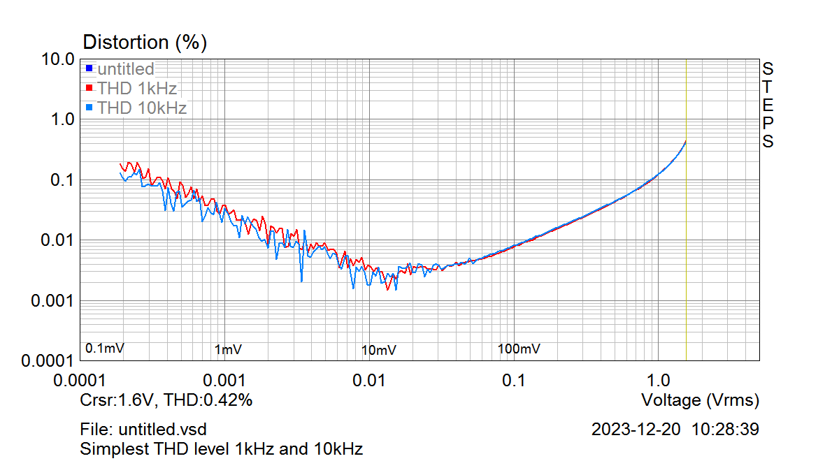

Another way to show that distortion is independent of frequency is THD vs. output voltage plot, for 1kHz and 10kHz frequencies, you can see that they do overlap. This is quite unusual, right.

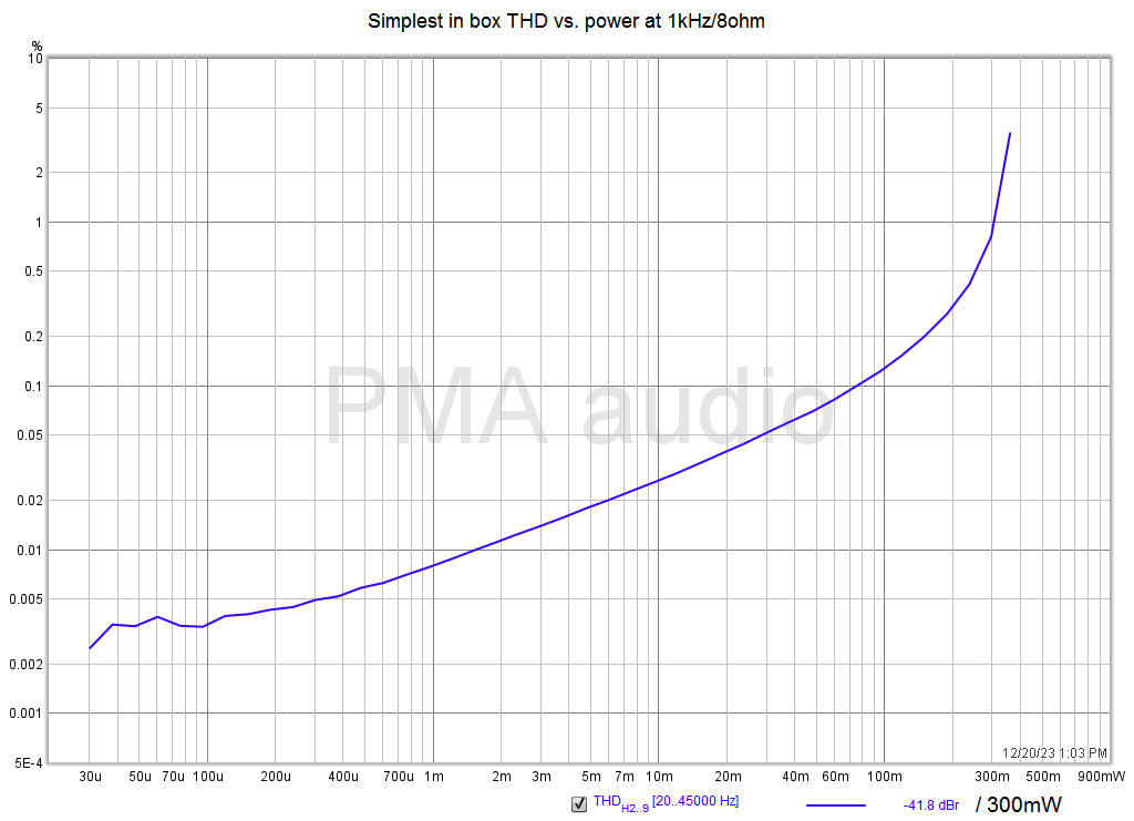

Both measurements were done on a completed amplifier in the box, idle current is 500mA and transistor beta is 151 at 150mA. Load was 10ohm this time. With 8ohm, we get exactly THD=1%/0.3W into 8ohm with 500mA idle current, as seen in the next plot.

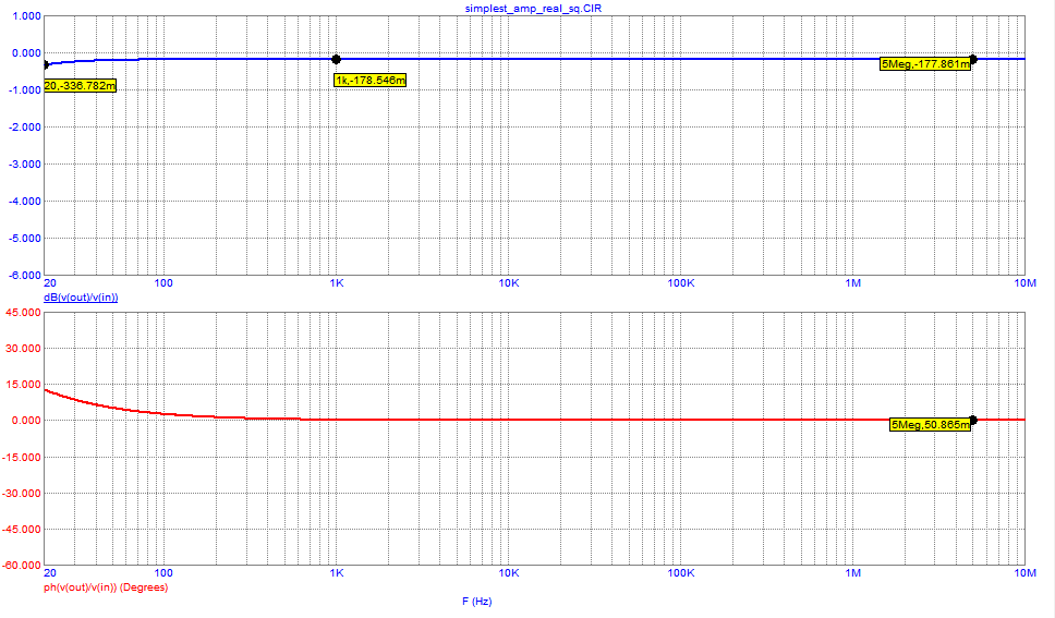

How does a phase plot look like?

You can easily derive it from amplitude responseHow does a phase plot look like?

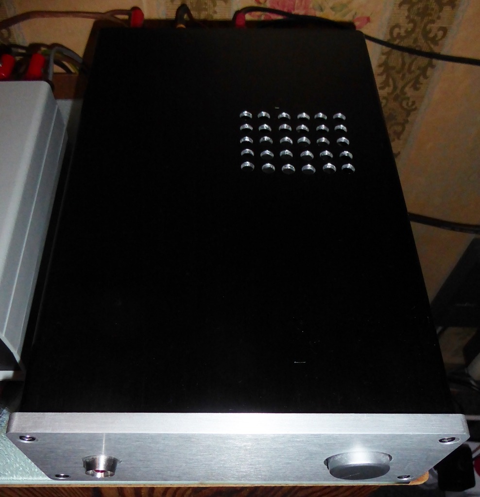

Please just take into account that you will need some vent drills or slots in the metal case. Idle current per module needs to be 500mA, so it dissipates 6W when supplied from 12Vdc. Both Q1 heatsink and 10R/5W resistor run quite hot (like 60-70°C the heatsink and 100°C the resistor). It is still manageable, but completely closed box is impossible. The transformer runs at about 70°C in my case.I can imagine 4 channels of these in one box - or maybe even better, two stereo units, one for each side.

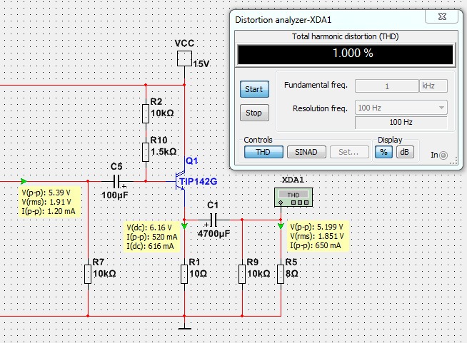

Might it be possible to replace the input cap with a line transformer to allow for a higher input impedance?
Anything is possible, but why do it? Transformers are not miracle workers; the only way the input impedance will be increased is by using a step down transformer which means you need an even higher voltage output from the source.
