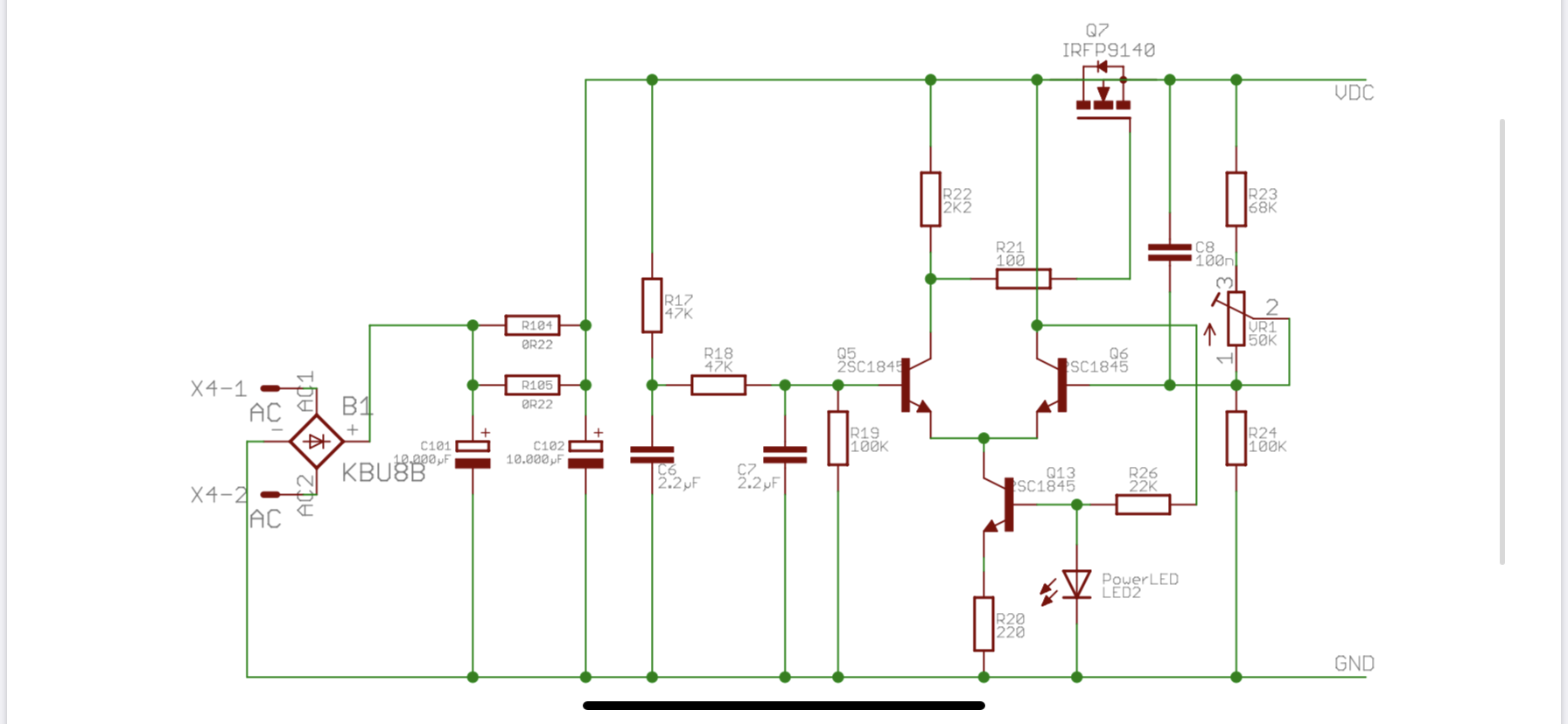

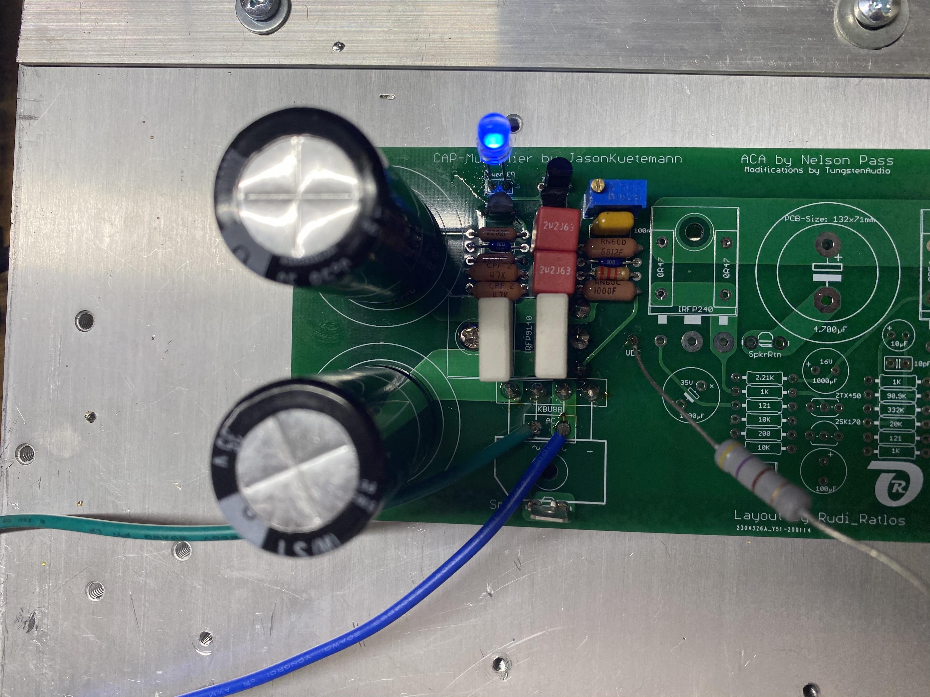

Question on this circuit. Rudi_Ratlos created a nice PCB that incorporated this circuit with the TungstenAudio’s Amp camp upgrades. I bought 10 boards and I’m building one now.
I bought the Antek AS-2220 which is 5A and has two 20V secondaries. I built the power supply portion of the board but the trimmer pot is not reducing the voltage under 26.7VDC and I need it to be under 25VDC.
Is there a part on the board I can change to get the voltage to lower?
Pictures attached of the schematic and my build so far. I thought I can just change the trimmer pot to get what I need.

I suspect the right person to ask, is the person who designed the circuit which includes the trimmer. They are the expert who can tell you the expected range of output voltages (at trimmer=full_CCW , and also at trimmer=full_CW) when driven by a 2 x 20VAC transformer.
It behaves like an op-amp, attempting to keep the voltages at the two inputs to the LTP equal. Therefore the output voltage will be at its minimum when the trimmer is set to 0Ω, then the output voltage Vout = (Vin * R19 * (R23 + R24)) / (R24 * (R17 + R18 + R19)).
It's probably best not to change R17/18/19, as they affect the frequency response, so you will want to either decrease R23, or increase R24. Doing so will increase the power dissipated by the MOSFET. You must make sure you have enough heatsinking to cope with that.
p.s. Your schematic has the symbol for an N-channel MOSFET for the IRFP9140, which is P-channel.
If you just have the psu section built without the amplifier loading it, your not getting an accurate final voltage. When the psu is loaded the voltage will sag a few volts. I’ve used this capMx circuit in past builds and it works very well as designed, maybe hold off changing components until you can get accurate voltage readings under load.

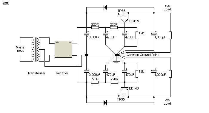

Hello Folks,
I'm not sure if anyone still follows this, but I've found an even simpler implementation claimed to work really well. Before I choose an implementation for my Power Amp, I'd like to better understand the comparative pluses and minuses of the Mr. Evil and the ESP Capacitance Multiplier Power Supply Filter.
attachment.php
The ESP CMP looks so dead-simple with no adjustments or so necessary... It feels like it must e.g. have disadvantages which may (or may not) be relevant to PowerAmp supply. Likewise the Mr. Evil CMP may have advantages which may be relevant to my PowerAmp supply application.
Unfortunately, my expertise is too limited to make a fair comparison and safe choice... So I hope for comparative evaluation and advice for my application to enable a selection decision.

...I'd like to better understand the comparative pluses and minuses of the Mr. Evil and the ESP Capacitance Multiplier Power Supply Filter...
There's one fundamental difference: The ESP capacitance multiplier relies solely on the current gain of the pass transistor. My/PMI's version uses global feedback for increased gain.
As a result, PMI's will have higher PSRR, and higher input impedance (so smaller capacitors can be used in the RC filter). It's been too long since I did this, so I can't remember how big the difference is. Another difference is that PMI's uses the same topology as an LDO regulator, so the dropout voltage can be lower.
It actually does need adjustment, as noted on that page:
The 12k resistor shown may need to be adjusted to suit your transistors and supply voltage.
Thanks for the quick response! This helps understanding, but I cannot yet judge which one would be the better solution for a 70W power amp module? I just don't know the criteria...

Either one would work well enough really. Both should reduce ripple by enough that you won't have any audible hum anymore (if you did before). There generally won't be any benefit to using one for an output stage, since those have high PSRR by themselves - just use it for stages with voltage gain.
You can work that out for yourself by measuring how much ripple appears at the output of the amp, and calculating how much would be left if you used a capacitance multiplier, e.g. the ESP version says ~50dB reduction.
The PMI version can be more efficient too, but if you care about that then you would probably be using a class-D amplifier.
I suggest that it would be best to try the simpler ESP version first. That will let you get some experience with how capacitance multipliers work. Then, if you want to learn more, or just want something that's technically better regardless of what the practical benefit is, build the PMI version.
