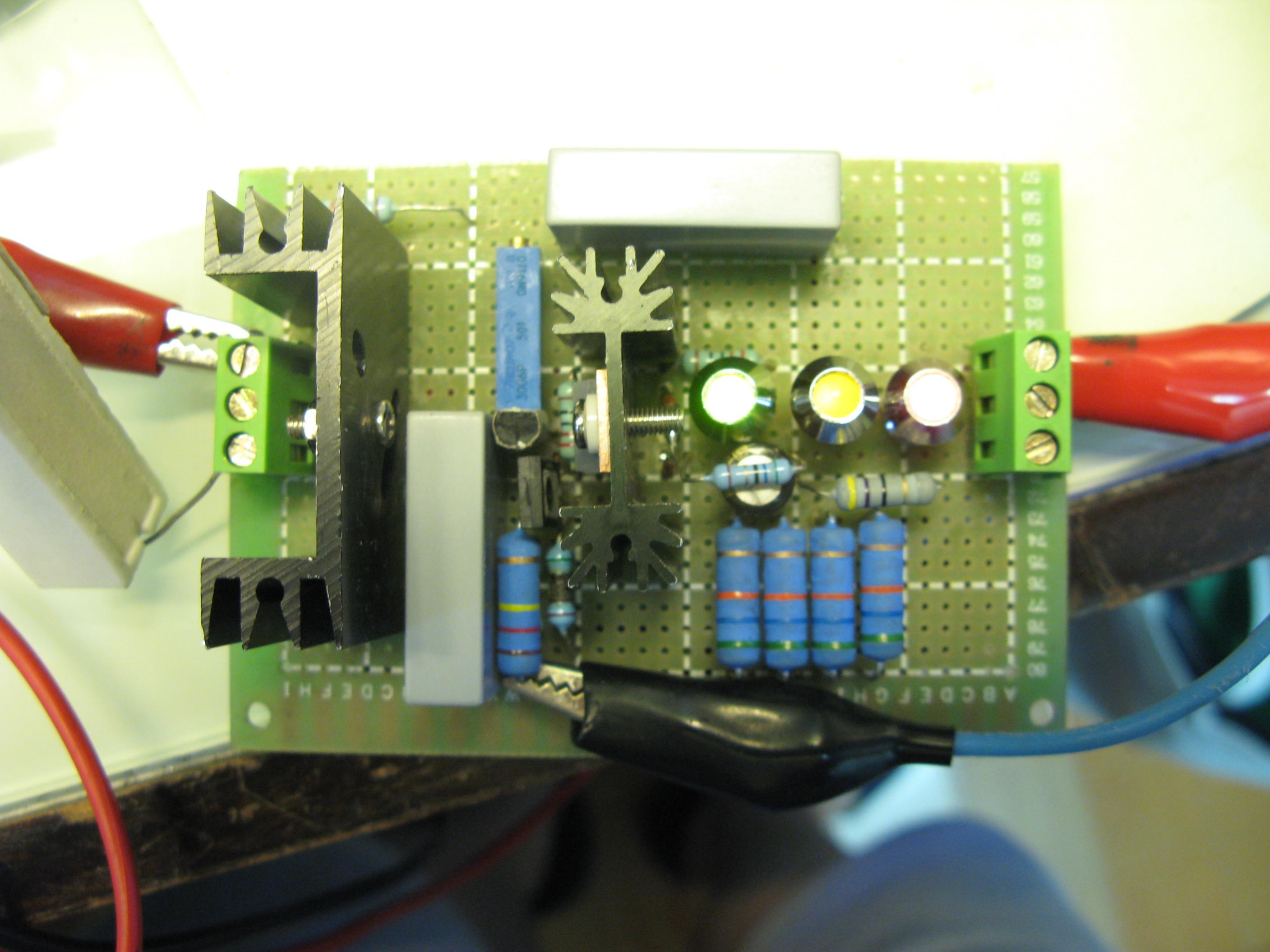

After burnt 4 FETs, 2 resistors and 3 LEDs, finally there is output at the SSHV1, with 300V input, I connect a 5.6K resistor at the output as load then adjust the VR to have 260V output. The output voltage slowly drift up to 300V and the IRF840 become very hot. Please help!!
For what reason it burned components and now gives output? Were they connected differently than now, or it was random burn outs? You either need a bigger sink (did not tell the current you use, the sinks look small), or 840 is in oscillation. Use the oscope. Put a little sink on the Jfet.

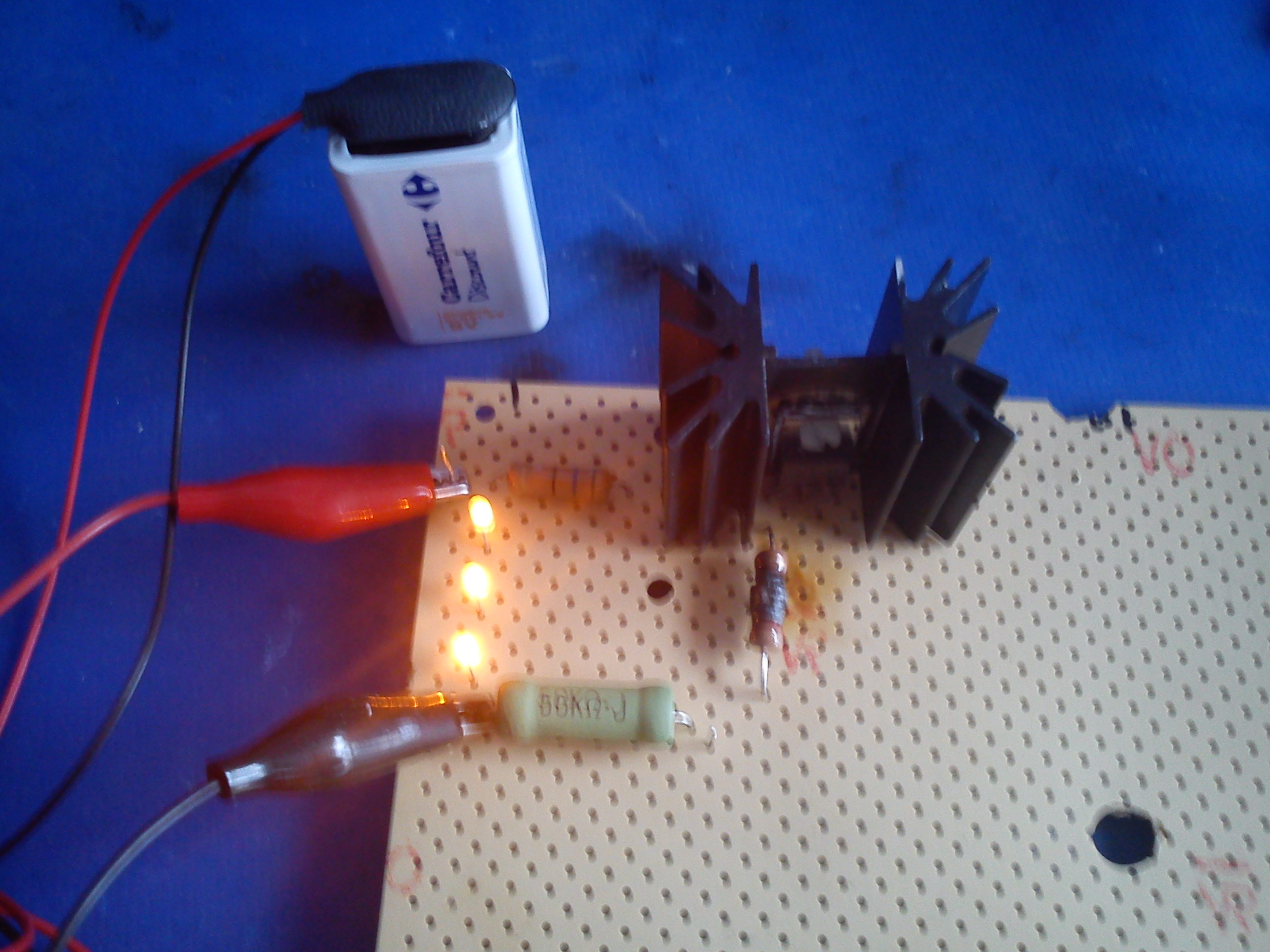

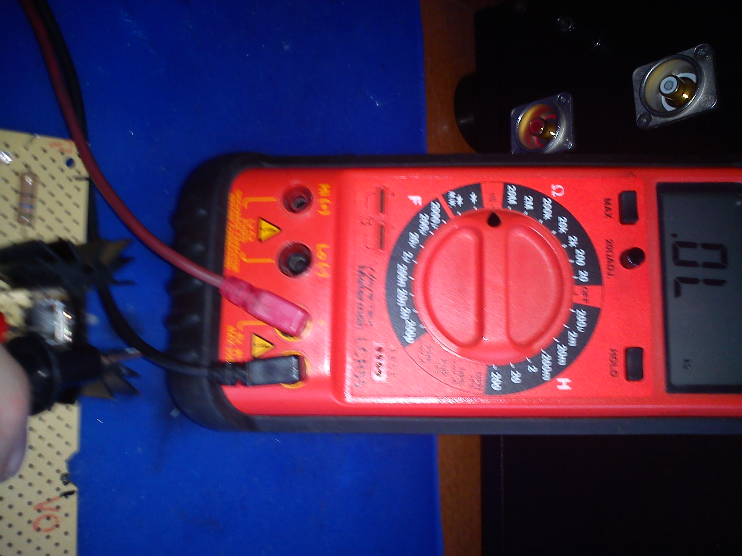

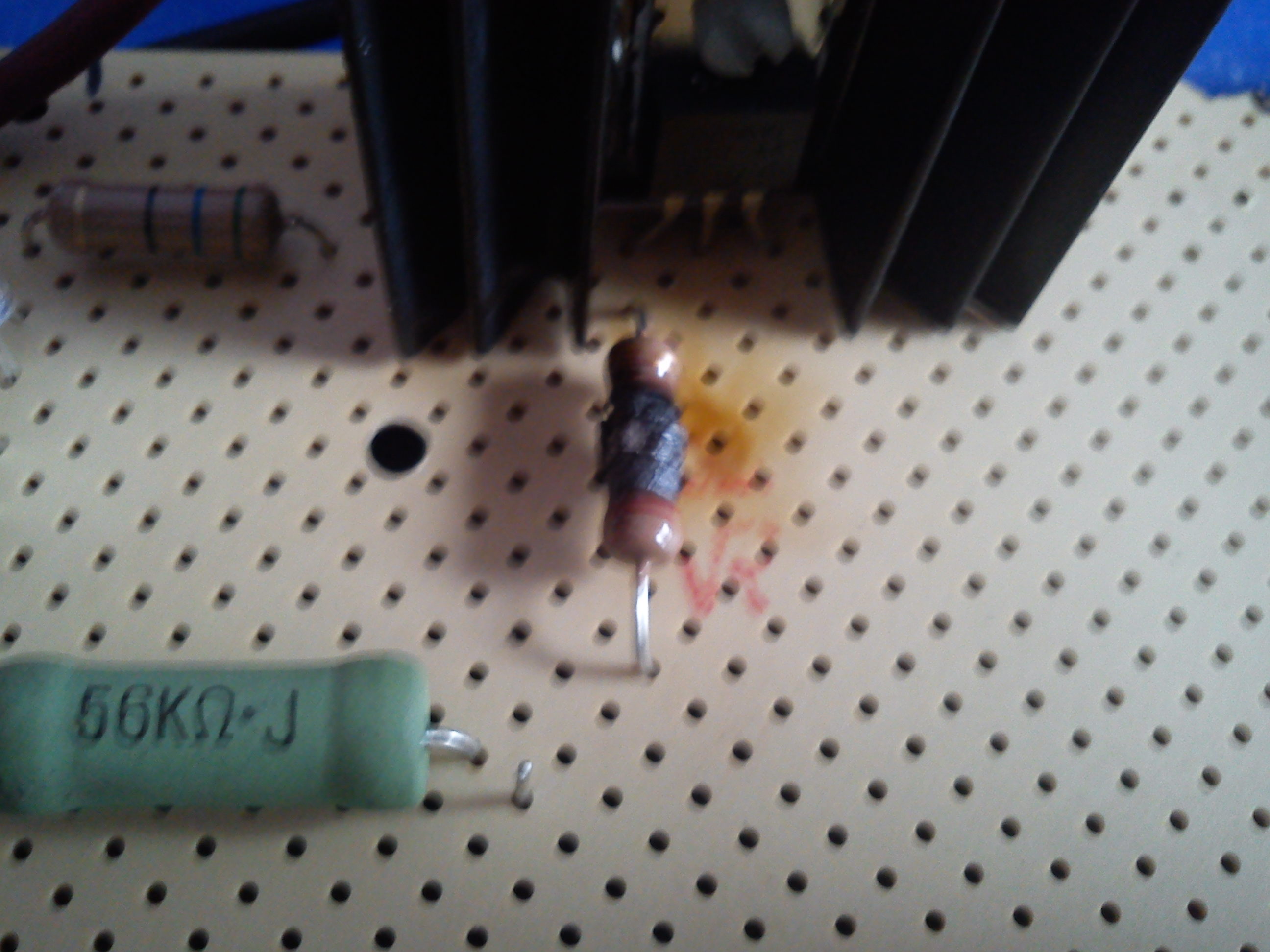

This morning I make a P2P only for CCS, 220R gate resistor IRF9610 burned, IRF9610 also burned, LEDs still alive verified with 9V battery, also verified that metal tab of IRF9610 don't have continuity with heatsink and IRF9610 was new.
Previously no output because I revise the 2SK147 and burnt one resistor. All others dead were due to accidentially short the Q1. I reconnect all the wire and measure the voltage again. This time I connect a 8.6K resistor as load and the max. output is 270V with 300V input. Any smaller resistor will cause the output voltage dropped. Seems the output current is limited at 30mA. I think the measurement in my last message was wrong because the load resistor may not be connected properly.
Are those 9610s IR made? Where bought from? Having any other PMOS like 9240 to try?

Joined 2002
Your burn story has logical explanation then. What R1 value you use and what will be your real load current need?
