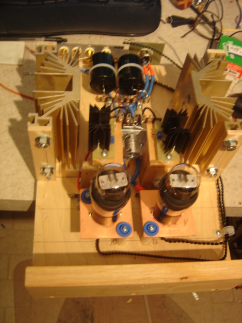

Same ones. Was final testing the filament shunt regs and when completed, I plugged in the high tension umbilical cable. Just as I was inserting the the plug it dawned on me that the voltage would probably be too high for the parts. The sound, and smell confirmed my thinking. Lesson learned.

The voltage across the 56ohm is 1.836V. confirm the load again is 262.6V with 8K6 dummy load.
That 1.836/56 confirms 32mA available. All logical again, smaller dummy won't let it hold. You would need ~75mA (VR1/R1=CCS) for feeding 55mA to your phono. Your sinks look small for that. But, are you sure your phono takes 55mA and not far less? Sounds much for a tube phono.
That confirms 32mA available. All logical again, smaller dummy won't let it hold. You would need ~75mA (VR1/R1=CCS) for feeding 55mA to your phono. Your sinks look small for that. But, are you sure your phono takes 55mA and not far less? Sounds much for a tube phono.
My pre-amp is the Toccata Phono. I measure the current with my unregulated PSU which has 280V o/p and the pre-amp draw 51.5mA. For 75mA, should I need a smaller R1 or larger VR1?

In that case, I would make another one the same reg for double mono both with 47R R1, because with your construction space and sinks, if you will crank the CCS to 70-75mA (extra to 50mA load is for the reg to work well) I don't see it will hold thermally well.

100C is too much on so big sinks. Look for around 45-55C on Mosfet case for long term reliability.

Salas, is spot on with his recomendation. With that current level much better using dual mono and big heat sinks. My SSHV regs live on these sinks. 1 reg per sink passing 70mA total current with 345V Input. 310V output. Load is 30mA.
The heatsinks stay comfortable warm but are warm non the less. ABout 45-50C in 28C room

Nick is IRFP9240 or IRF9240? with IRFP9240 also burned 220R gate resistor.
I don't have IRF9240 I have IRF9610 from minikits of Mike aka Tea-Bag are also Vishay (Intersil) like the ones I bought to RS.

You could relax it to 50mA CCS for 30mA load, is enough. Those in picture are the ones now knocking on heaven's door BTW? Both, or just one had the plug?
