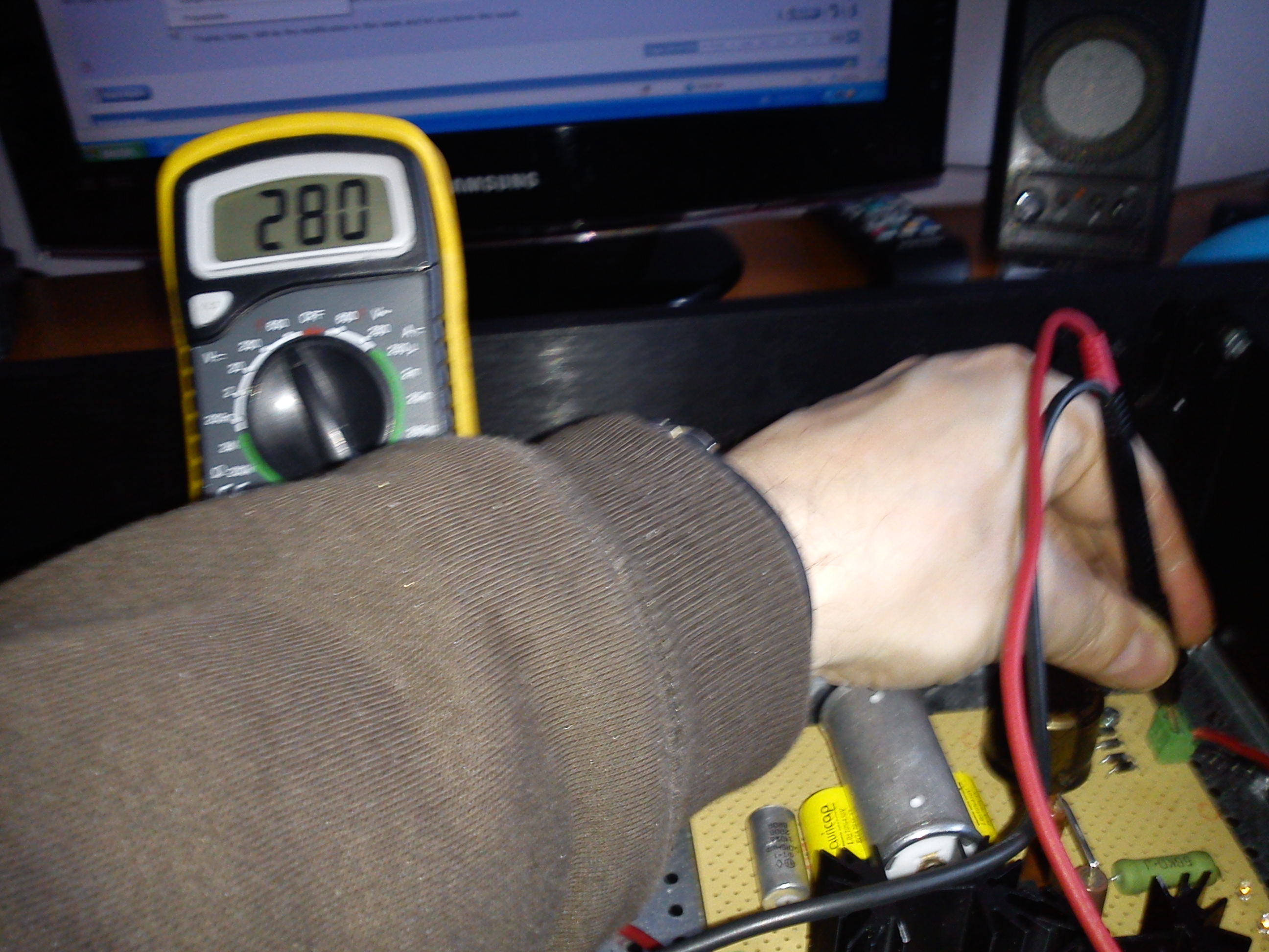

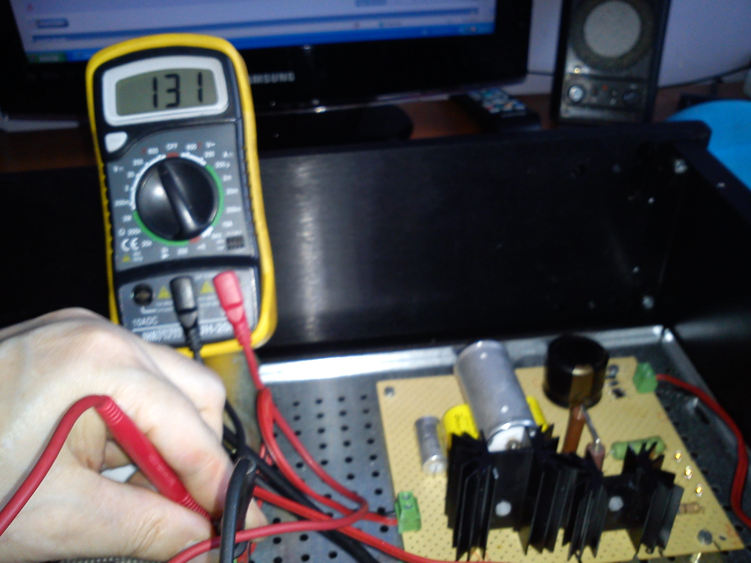

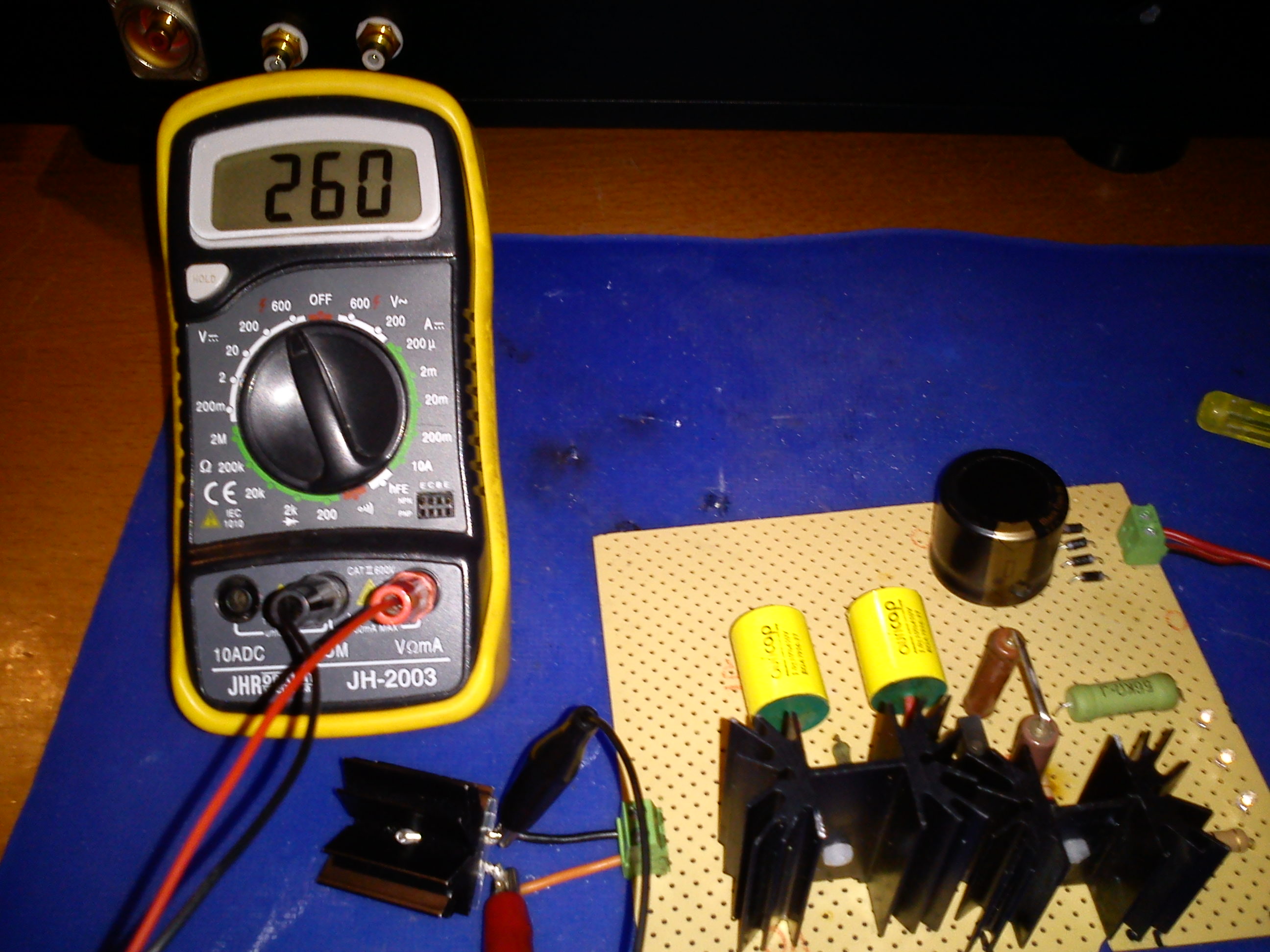

Thank you very much bigpandahk, I'm happy my CCS is going on perfectly well after 10 minutes, old tx & IRF9610 used.
Now what I have to do: connect the rest of quanghao pcb with old tx or try first with Bartolucci tx and after connect the rest quanghao pcb?

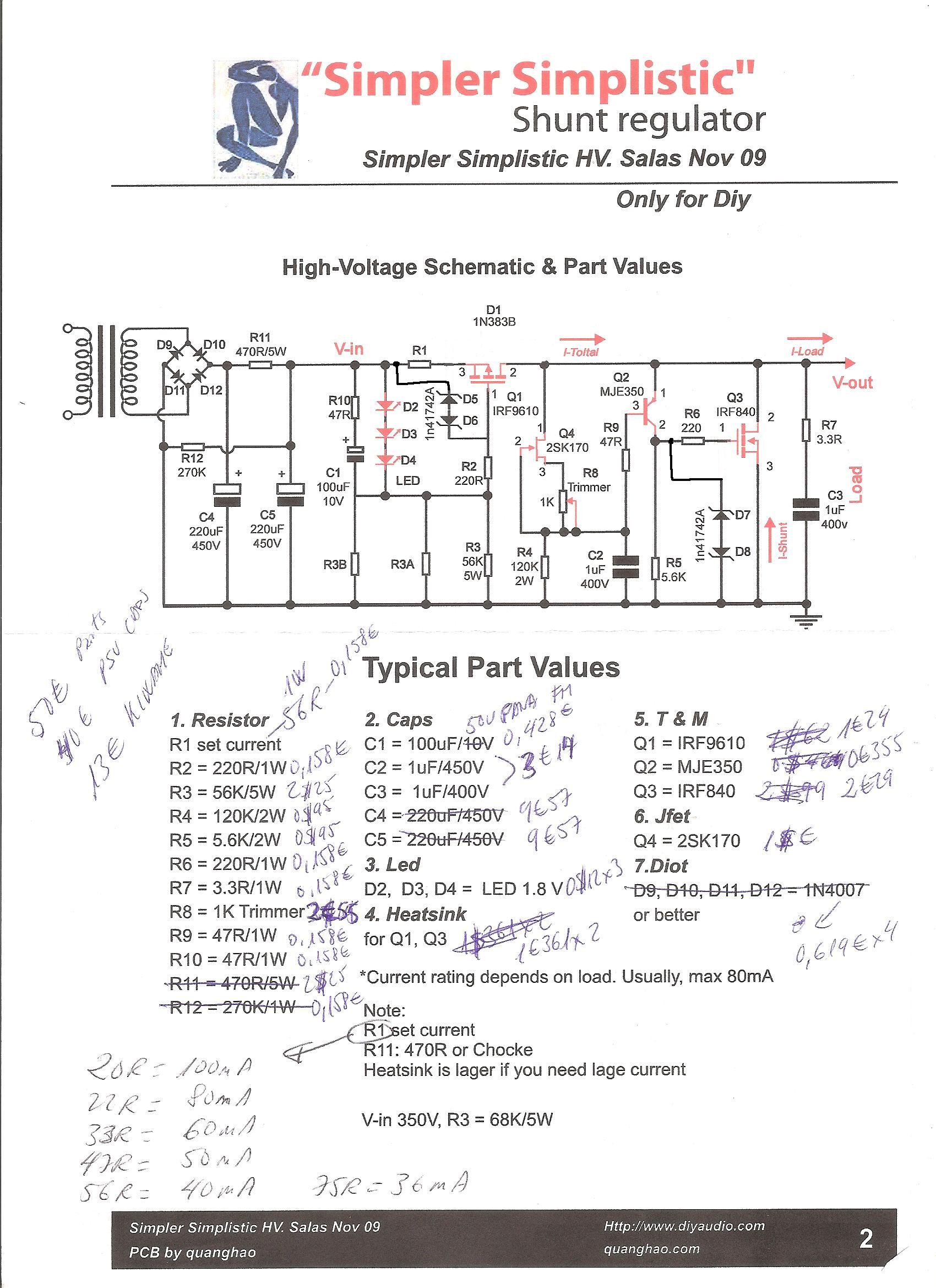

Hi Salas
Before there is GB for SSHV2, I would like to modify my SSHV1 for my phono pre with large hintsink for the MOSFET. Can you suggest which component(s) should be change for my application (300V 55+20mA)? Thanks.
You have to lower R1 until the voltage across it divided by its value is going to indicate ~70mA. Before that you will have to change your IRF840 heatsink to 2C/W type, your 9610 sink to 4W/C type. Also your 2SK147 fet due to high transcoductance ~40mS is more prone to drift in that hot environment. Try to put a 2SK117GR or 2SK170BL in its place.
Wich type 1N41742A like quanghao schematic?
it is zener diode 12V
Thanks Salas. Will do the modification in this week and let you know the result.
