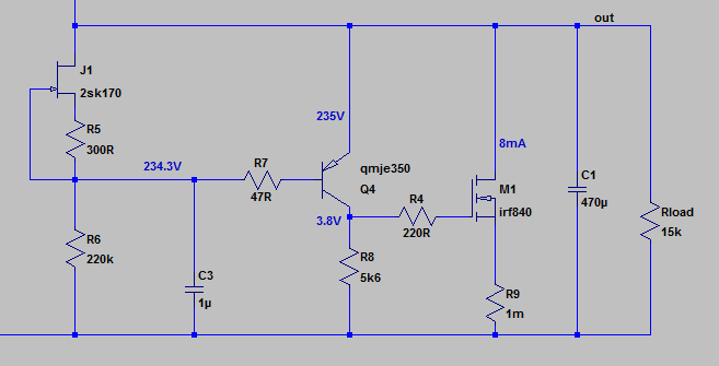

voltage across R4 284V
Puresound MM if you want I can remove & connect a dummy load of 15K
voltage across R9 0V
voltage across R5 0V
Yes, you should fix it first with dummy resistor load.
0V across R5 is completely wrong. The shunt mosfet, Q3 isn't working at all. It needs something like 2V-4V across R5 (Vgs) to start working. Take Q2 out and measure with the diode tester between B-C and B-E. One way there should be no reading. The other way you should get a value that is close to each other (B-C and B-E).

MJE350 B-C & B-E close reading.
Roughly, this is how the circuit should measure if it worked correctly.
Vin?
Old tx 115 Vout max.
How you had 260VDC out on 15k dummy yesterday? That was 17mA on the load only.
Oscillation then. Do you have scope?
+1
If you don't have a scope try listening to a radio on AM near the circuit. You should hear it in the radio if it's oscillating.
Vin for the circuit I showed does not matter, but it was about 275V DC.
