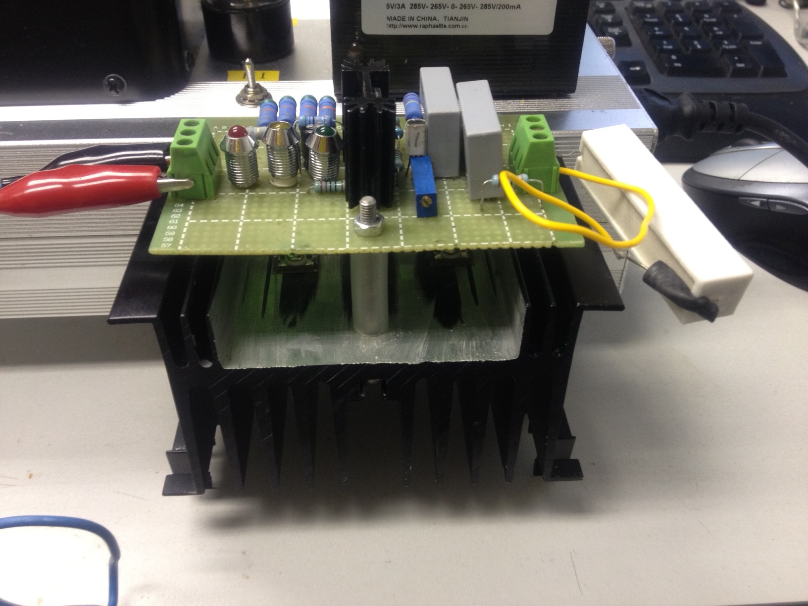

Dear Salas
I've reduced R1 to 14ohm and mount the Q1 & Q3 on larger heatsink add heatsink to Q2. I connected a 5.6K 20W as dummy load and test the regulator. With input 300V, I adjust the VR to have 250V output but it drift up slowly to the same value of the input. Please advise the possible problem.

Possibilities: 2SK147? Very drifty especially if heated up enough. Try BF245A. Cable connections to the Mosfets? Possible oscillation. Bad trimmer? Can drift. Did you check there is VGS voltage on Mosfets and Vbe voltage on the transistor? All semiconductor parts should be checking OK first.
