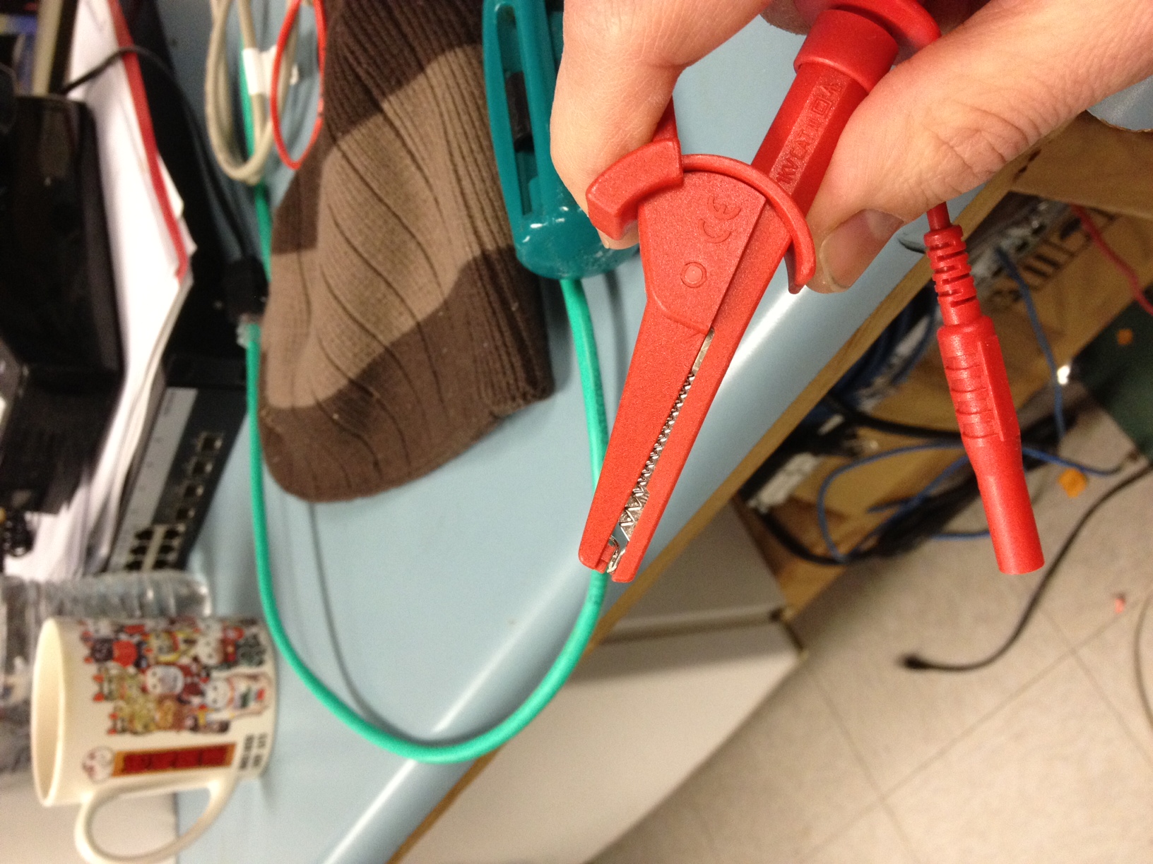

Use precaution with high voltage. Here are some alligator clip probes to keep hands a safe distance away. They are about 250MM long total.
