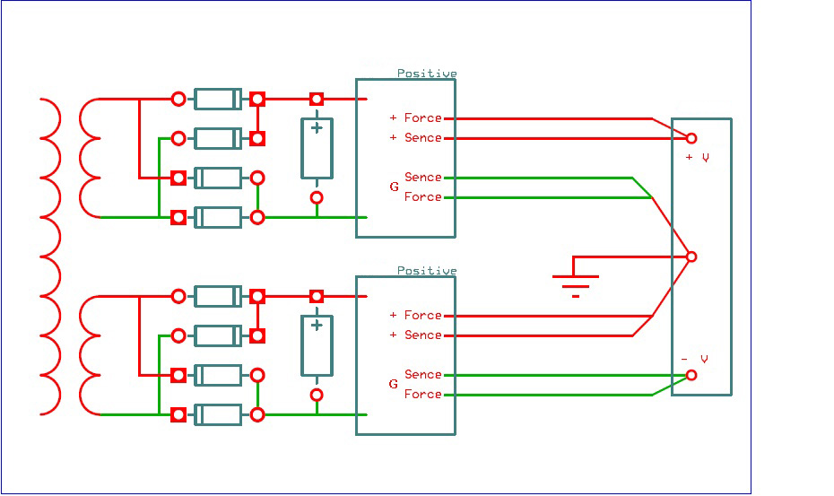

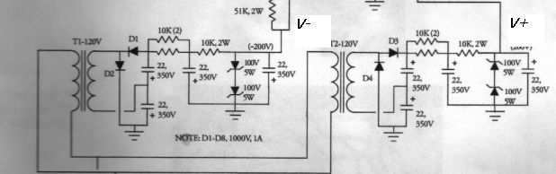

Hi all,
First of all apologies for the inconvenience and my little knowledge, I can have someone help Simplistic Mosfet HV connect Shunt Regs, V- of the power supply of my preamp. attached a picture.
I to place two Mosfet HV Shunt Regs, in my PSU but not as Mosfet HV Shunt install Regs for V-.
Thanks in advance.
regards

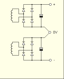

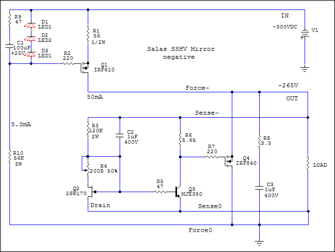

diyAudio Chief Moderator
Joined 2002
What kind you have made, SSHV1, 2, or nothing yet? There are older posts on how to mirror SSHV1 for minus polarity or in how to use two positive polarity regulators for (+) and (-).

Thanks for the help Mr. Salas.
I have not done anything, but the configuration of the new power supply for my preamp is like the image attached.
You can either make one positive and one negative SSHV point to point and use your now configuration, or make two positive SSHV2 from ready PCBs and convert to the configuration of my second posted picture.
Joined 2002
Advise is you will need a transformer with two discrete same secondaries, i.e. 4 wires not 3 to make the two positive regs configuration. Milliamps and Volts is whatever your application specifies plus 20mA for the regs. Double that to be royal if you can. Keep in mind about AC*1.33 real DC value to expect after rectification. Make sure it will allow 20V headroom to the regulators.
