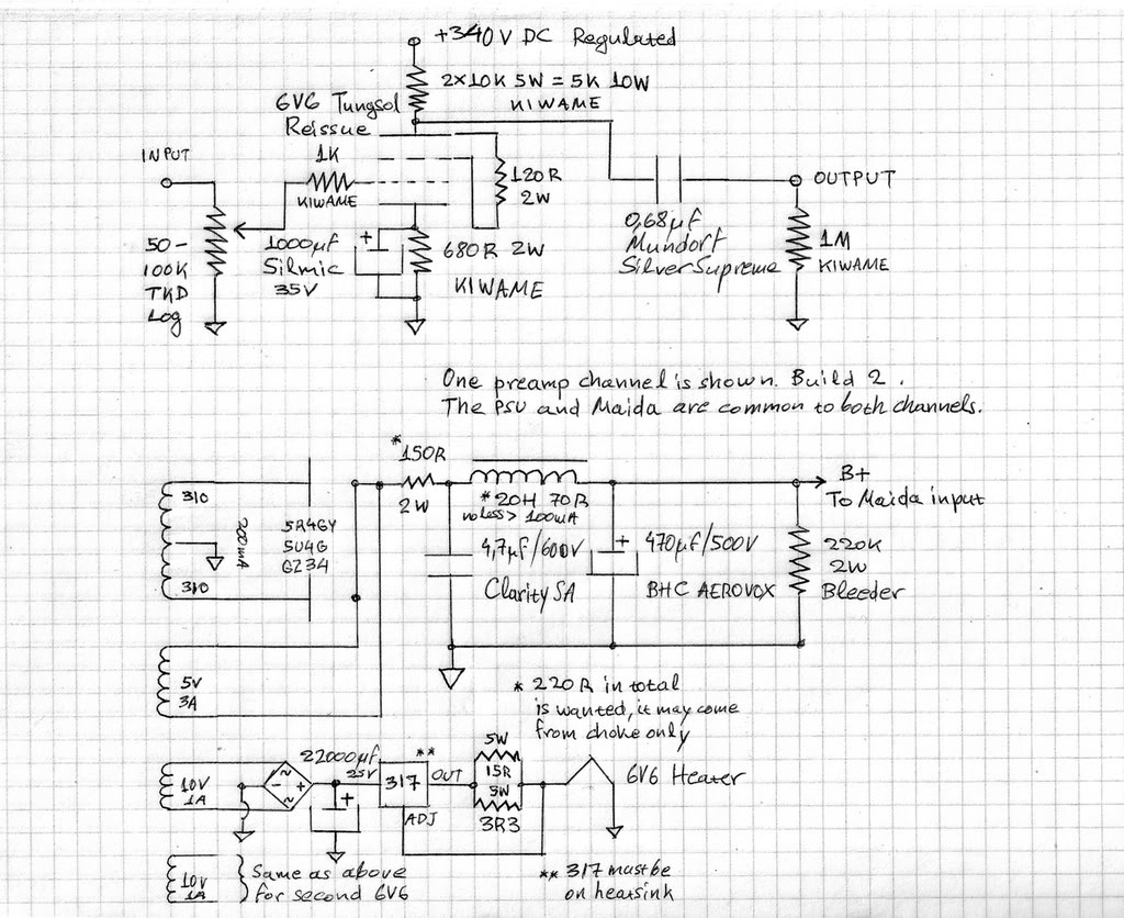

Someone has to use same TVC, regs, etc. to be fair and listen in the same system of course. The 6V6 can get you to very good level cheaper with less problems to solve and less subsystems is one sure thing. A TKD, or Cosmo 50-100K, 100 Ohm good grid stopper, 7.5K Mills load, 300V clean B+, good capacitor output, and you are there.
Joined 2009
Is this your last 6V6 preamp schematic?

In my winter plans, I will make a choke loaded 6V6 with SSHV2 and attenuator at the input, no tvc, just to compare.
Will report then.
Also will try the #26 with starved filaments that was reported to give better results.
For a more monitor sound or less DHT sound you could use Sylvania ST tubes instead of globes that I use.
No TVC? Won't be apples to apples.
