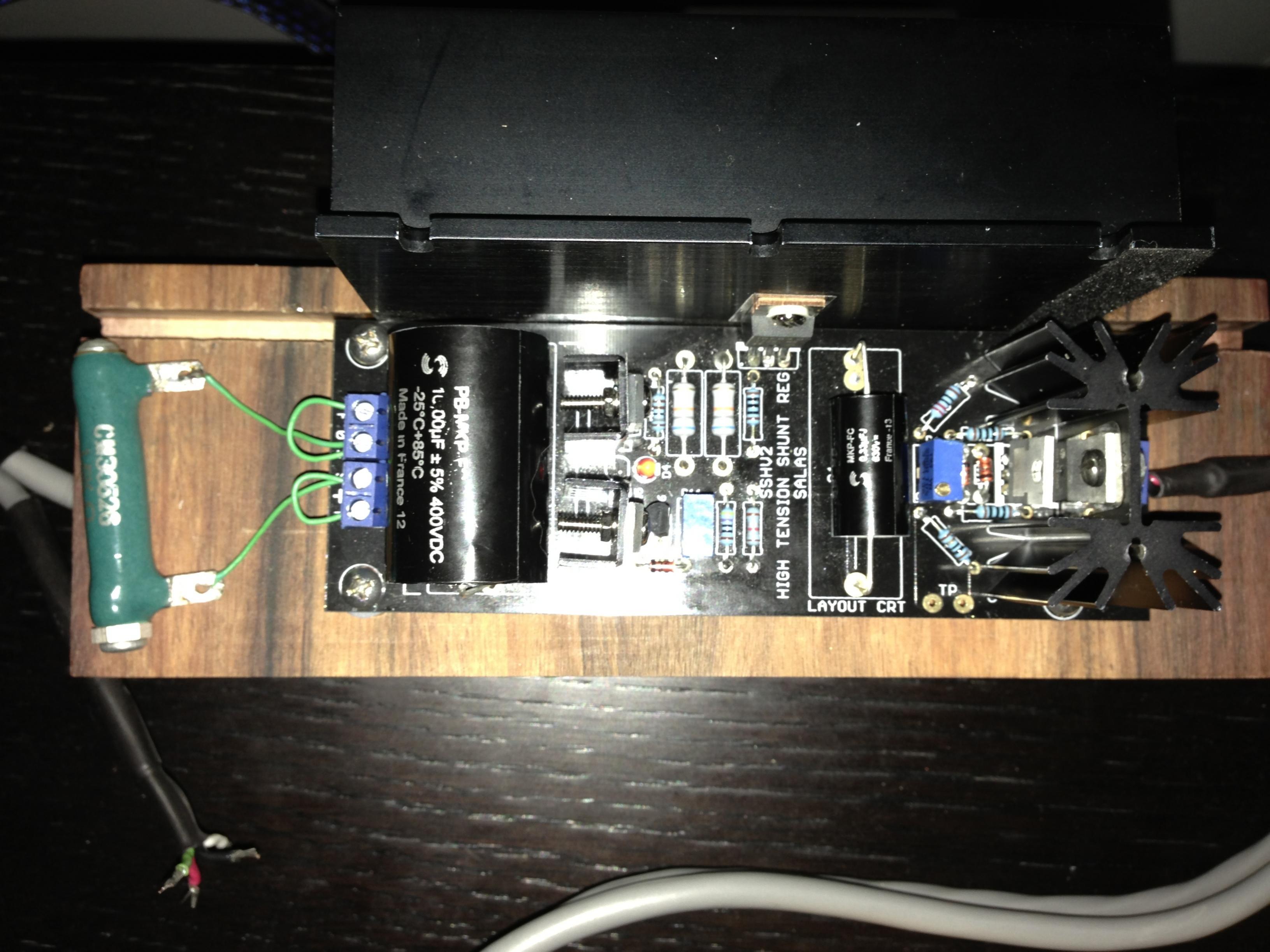

It was in the my circuit. I found after that I had swapped the 1.8 ohm r6 with the 1.8k r8.
So I changed out q1, q2 and q3, q4,5,6 also the zeners I still have the same results. I can set the mV's but no voltage traveling all the way thru. I have 330vdc should see 310vdc coming out. Oh, currently it seems to pull my power supply down to 285vdc
Here's a pic

That would be alright for understanding the circuit, put it to pace without HV hazards, experimenting etc. This one we try find why there is no VGS on the output Mosfet was a a working one that failed or one that never worked though I am not sure yet. Visually is OK for components stuffing.
Joined 2011
R10 shows 68k installed on the board - r9 shows 43.5k installed also, should I pull a leg up and retest? Or replace?
Voltage trimmer was replaced does minimal was tested before install and did work, can adjust mV's set to 393 what I need .19 + .20mA.
I think your talking about the current trimmer here. How about the voltage trimmer, is it working?
When I happend to short the CSS sink with Vin the IRF, 2SK117 and D1 putted their ski's in the weather.
