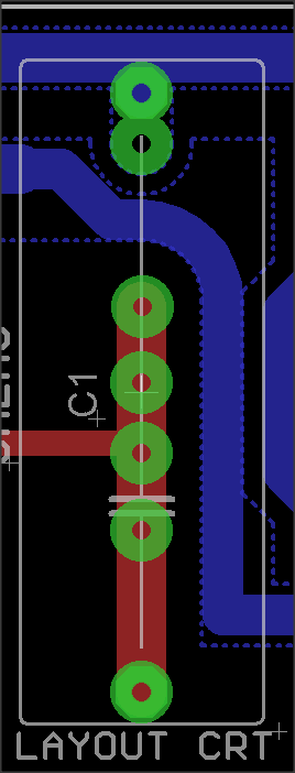

What part? To place the Zobel cap right or not to exceed the top Mosfet's spec? Both should be watched. Crt could had marked it better I am not sure, but here is an "X-RAY" of the C1 area.

I failed both!

I failed both!it wasn't clear to me the PCB marking, but not blaming anyone as it seems I was the only one who did this

I will ask Crt to mark it more intuitively for the future when I will catch up with him and he has some time. Interestingly nobody reported so for missing the C1 placing, but its mainly because they use longer capacitors is my guess. Thanks for the feedback, very nice website you got BTW.

Thanks for the feedback. My intuition led me to place it centred given the multiple holes.
