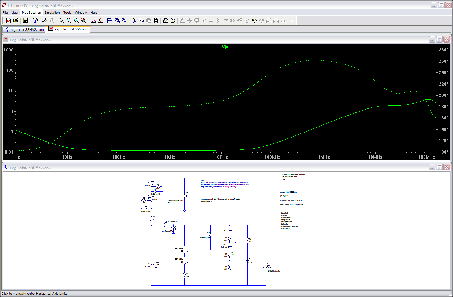

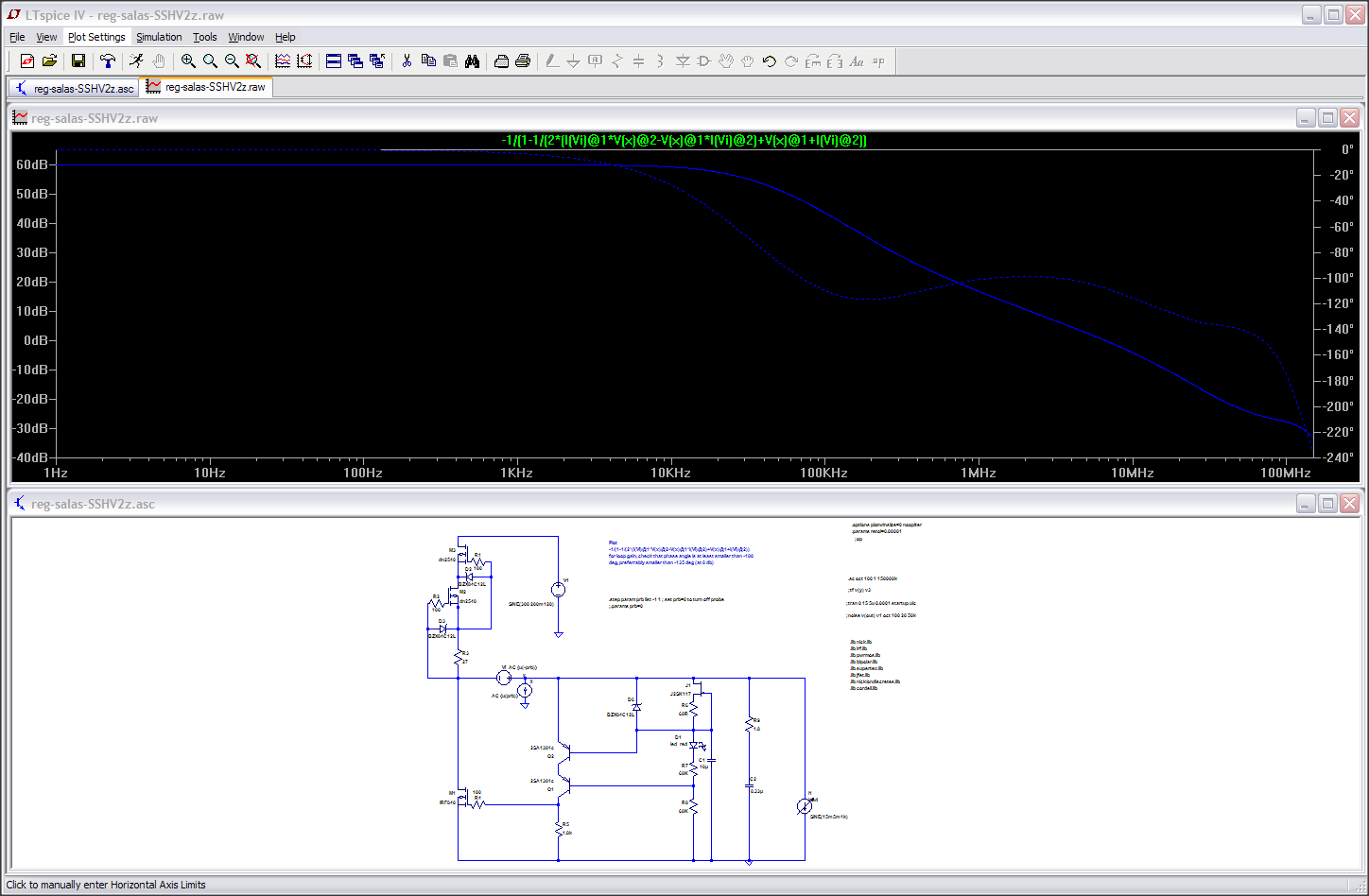

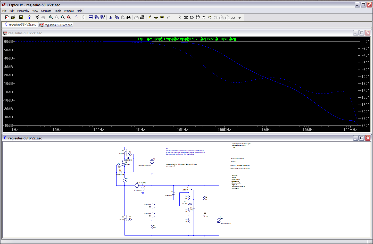

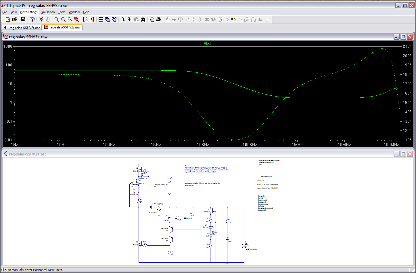

Lets see what LTSPICE says, shall we?
In the OLG pics: CCS as connected originally and as you advise. Connected by your suggestion gives same open loop gain, but 21 degrees less phase margin and more undulation.
In the Zout pics: Orginal circuit, then your bypassed Zener level shift suggestion still with your CCS connection suggestion. I used 100uF as bypass. The output impedance shoots up.
