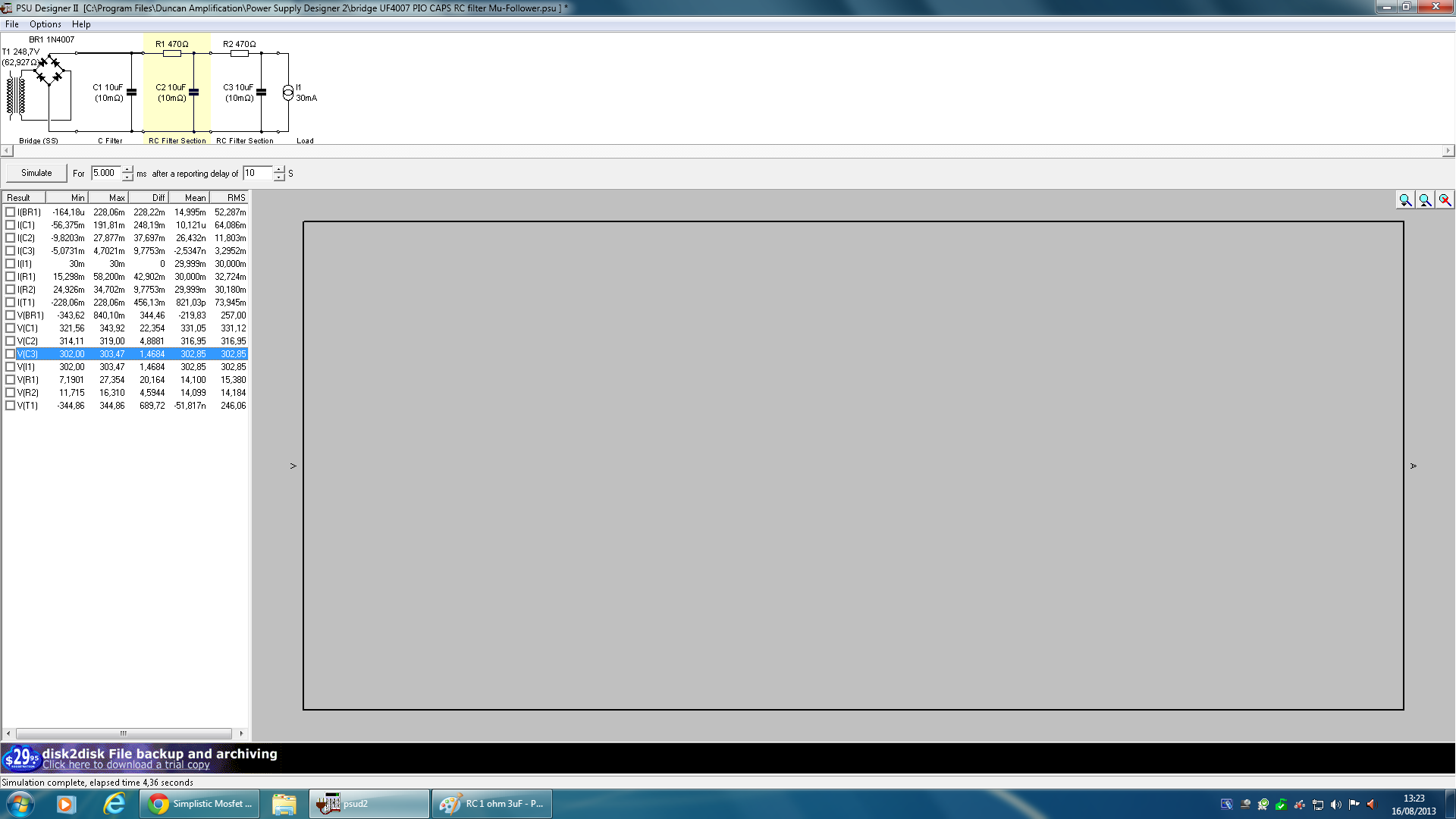

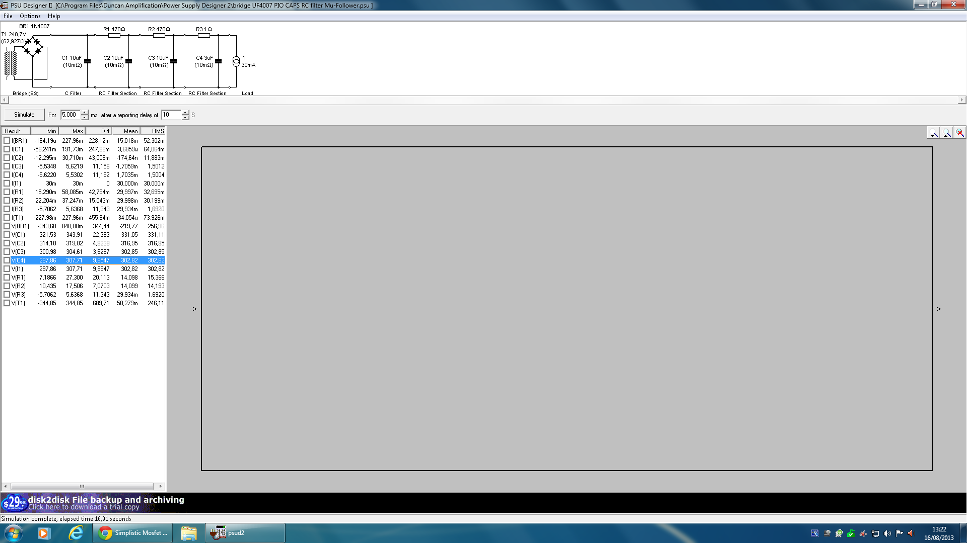

Simulations pics
Merlin, your simulation doesn't take into account the SSHV. The preceding RC strings in your simulation can't supply additional current in the min extremum of the pulses due to passive nature of filtering. SSHV is an active device, which can compensate the additional current from the shunting element. The only problem - the speed of the compensation. In case of additional RC string it's lower than with direct connection. As you can see in this case the problem is the circuit to be powered, not the power supply side.
