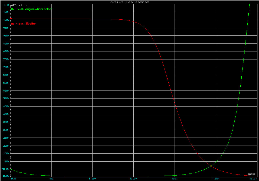

Power supply (having also output voltage and current capabilities) has 2 main - say - quality parameters: amount of input pulses filtering (PSRR) and output impedance defining the load characteristics. First parameter defines hom much garbage you will have on your power supply rails, second - hom much voltage fluctuations you will have due to consuming current change for your circuit.merlin el mago said:Why if the only change is with or without the RC filter?
Lets see what we have in the case of using SSHV (see attachments). Really our concern is up to 1MHz, because all higher frequencies should be treated much differently.
Filtering is great without any additional RC (at 1M it's more than 100dB! - 1V input pulses will ideally output in 10microVolts). Putting the RC after the SSHV "improves something which is already great" (25dB more), but as you can see - even better results (still useless improvement) you can achieve with the filter just before SSHV.
Output impedance graph shows clear problem for the case "filter after the SSHV". Audio signal top frequency (that is what would be in the current changes) is 20kHz, at this frequency we have milliOhms in cases of "no-RC" or "RC-before-SSHV" and around 1 Ohm in case of "RC-after-SSHV". It means that changing the current to 10mA will lead to changing the voltage to 10mV ("RC-after-SSHV") and around 0.05mV without the RC.
So, adding the RC after the SSHV does not improves anything and adds some potential problems to the circuit.

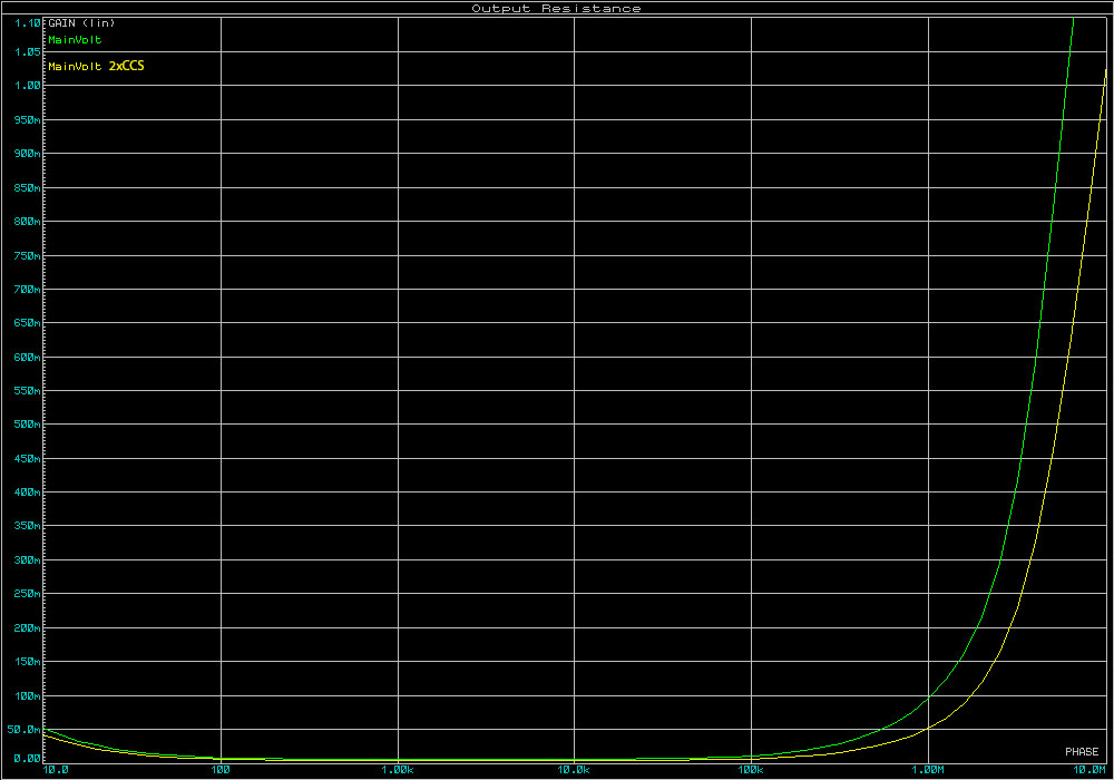

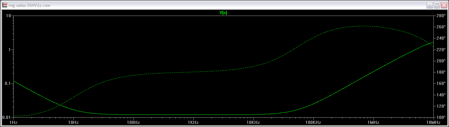

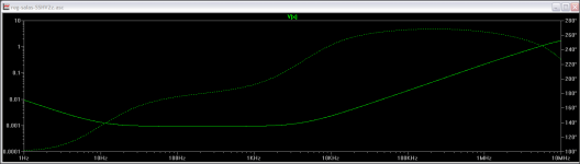

As far as I simulated the SSHV I tried to add the second CCS in place of cascode's load. I can't see any problem with Zo. Overhead in parts - one JFET.
Maybe you added a perfect CCS? When I was making it I found the resistive load smoother sounding than a 2SK117GR degenerated for same ~2mA DC bias.
When I run the LTSPICE I saw that the rate of Zo climb around 10kHz got steeper, no surprise. To have less overall Zo but smooth and extended it takes a compound feedback pair in the output. Such a decision would render the reg much more reactive load intolerant in my experience. Given the field of application, i.e. tube builds with significant distances from sense nodes to consumption nodes I opted to stay with simple drive arrangement and good enough Zo but smooth and tolerant phase. People came to apply it even on small SE amps (see recent Bartola report) #26 preamps and phones amps with large inductive anode loads. Quite a range of successful applications. So with the benefit of hindsight I consider that original decision adequate.

I did the simulation with the same CCS as in the base circuit of the cascode, but tuned for 3.6mA. I use other program, not LTSpice and maybe that is the answer to differences (different models and so on).

Something's missing because when applying a CCS on the error amp, especially when higher in mA than with the resistive load you MUST get more OLG. That should show several fold drop in Zo at least over a significant portion of your curves. But they look running at almost same level in most of your posted chart (last one with yellow and green lines).
