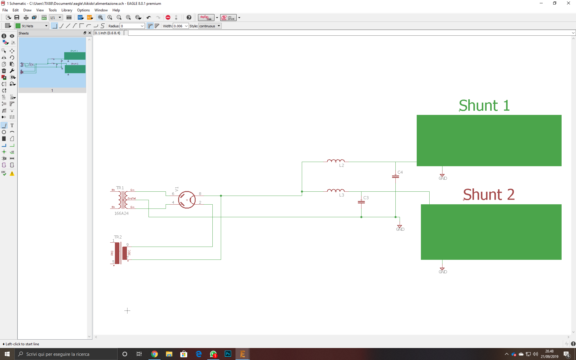

Hi Salas. I would like to ask you since the power supply box is separate from the preamplifier, I read that the two outputs must be short-circuited to transform it into a classic feed, there are contraindications if I reach the outlet directly with 4 twisted wires and then I start with a plug with 2 wires?
Do you think the two schemes are more functional?

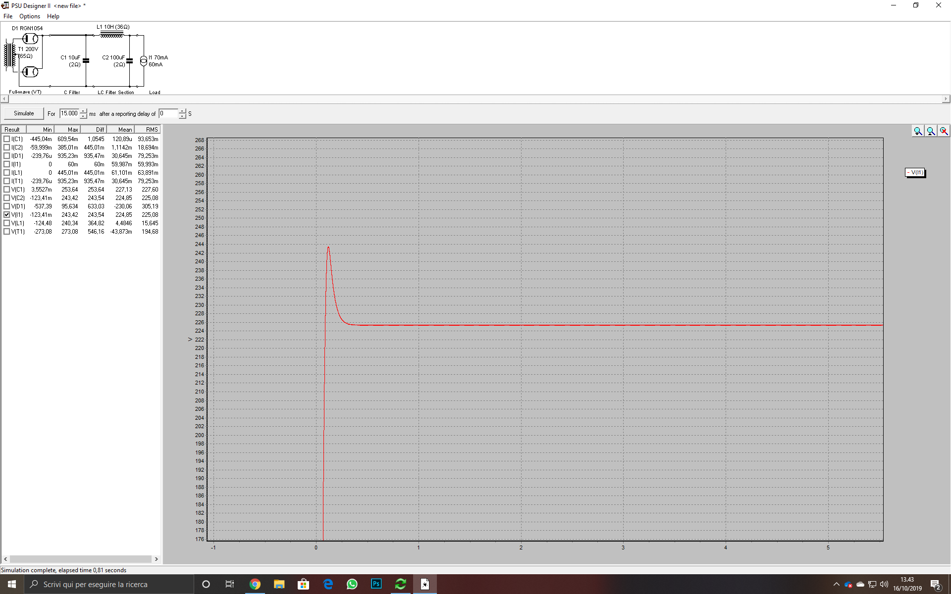

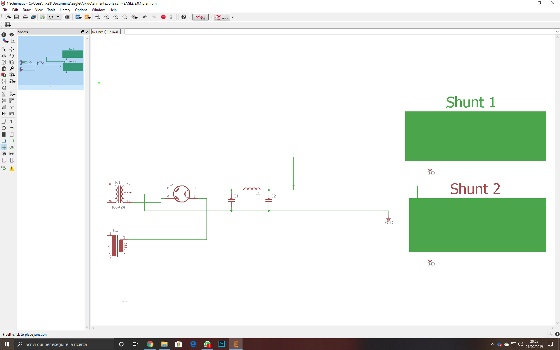

Here are two simulations for the raw dc, I will use a rectifier tube, not wanting to stress the tube too much, I would prefer to put 100uf after the L, but that peak voltage for the first seconds worries me a little, what do you think Salas? Could it be harmful to the shunt? The second simulation is with 190uF and the peak has disappeared, could that capacity be enough to shunt? Adding a second filter cell with CRC for the two channels, it seems to me wasted given the use of the shunt or could it help filtering? Two shunts will be used one per channel.

diyAudio Chief Moderator
Joined 2002
Avoid a peak. For various reasons, not only possible harm. Glitches can activate the choke to radiate an interference field. 220uF standard value for C2 should be enough for your moderate mA. 100Hz ripple the reg it does not mind it much, its EMI/RFI can leap in. Striding over fences via stray inductance in cables and layout. But the choke should help enough in that. Depends on how high a frequency it remains significantly inductive. Real C2 will not have 2Ω ESR across its useful bandwidth though, smaller.
