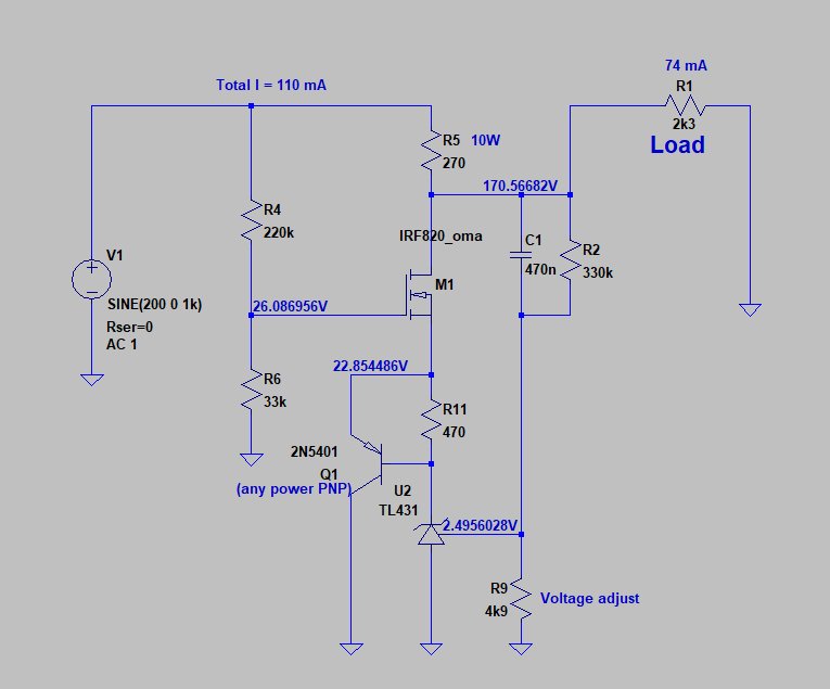

I bought a kit for a SSHV psu a few years ago, and now I want to use it in a high output Z, cathode follower, OTL topology headphone amp with one 12au7 and one 6080 tube. I need 170v output, and have a 150v transformer. How much filtering should I use, and how do I set the right output? Could anyone help me estimate the current this amp needs?

Impossible for anyone to estimate without a schematic at least. You should measure the current consumption of the client circuit with an Ameter between PSU and B+ input first. If its built and has a PSU as it is. You add 20mA to the reading for the shunt's bias and calculations. With PSUD2 software simulator from Duncanamps.com you can enter the Tx data and decide configuration and filtering of the raw DC part so it drops to 190V DCin when the SSHV2 powering the client circuit is involved.

Here is the schematic. I am rebuilding an existing pre amp to make this. If no one can calculate the current I will just make it after a schematic first and measure.
After rectification and filtering (220...470 uF) you get ~200 V as raw DC. You need 170 V for the amplifier, so shunt regulator should "dispose" 30 V.
According to the schematic, the total current consumption for two channels are 74 mA.
I this were my project (and must use shunt reg.), I would use this:

I wanted to try the shunt reg since I had it lying around, and assumed it was a better solution than a regular psu, but do you disagree, artosalo?

...assumed it was a better solution than a regular psu
What do you mean with regular psu ? Unregulated psu or psu with series regulator ?
Your 6080 require quite high current and therefore the power loss in shunt regulator is relatively high. With series regulator the power loss would be smaller.
In this kind of projects I would use a power supply with series regulator such as "Maida"-type. I have understood that shunt regulators are used mainly with pre-amps and other lower current projects.
One application of this type of regulated supply would be in a case where you have very low PSRR, as in simple single-ended gain stages. I agree, a 6080, even at relatively low current of 33mA, may not be a great choice for this regulator. But it MIGHT serve well for the driver stage. Phono stage would be another great application.
