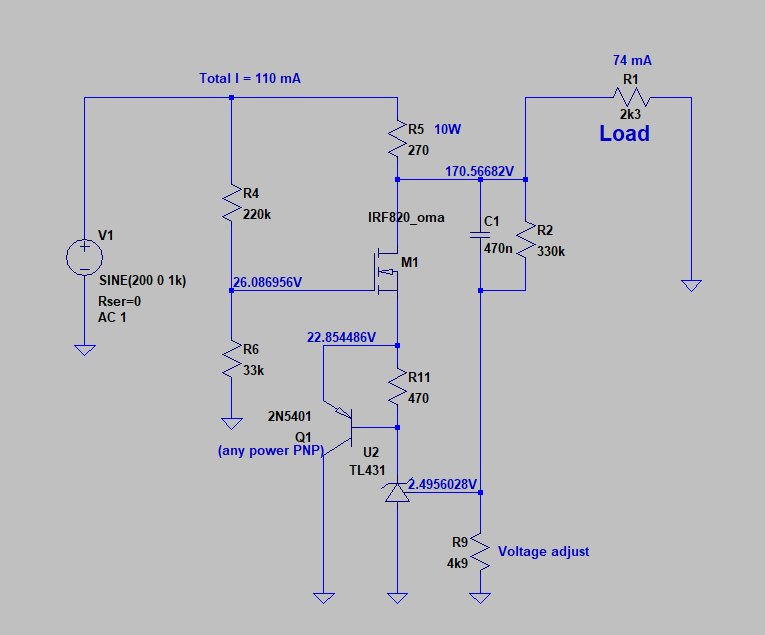

After rectification and filtering (220...470 uF) you get ~200 V as raw DC. You need 170 V for the amplifier, so shunt regulator should "dispose" 30 V.
According to the schematic, the total current consumption for two channels are 74 mA.
I this were my project (and must use shunt reg.), I would use this:
Hi Arto I'd like to improve the psu of the old project with 6N1P and 6N13S. The BC638 could be suitable as PNP transistor into the shunt circuit?
Do you refer to this circuit?
