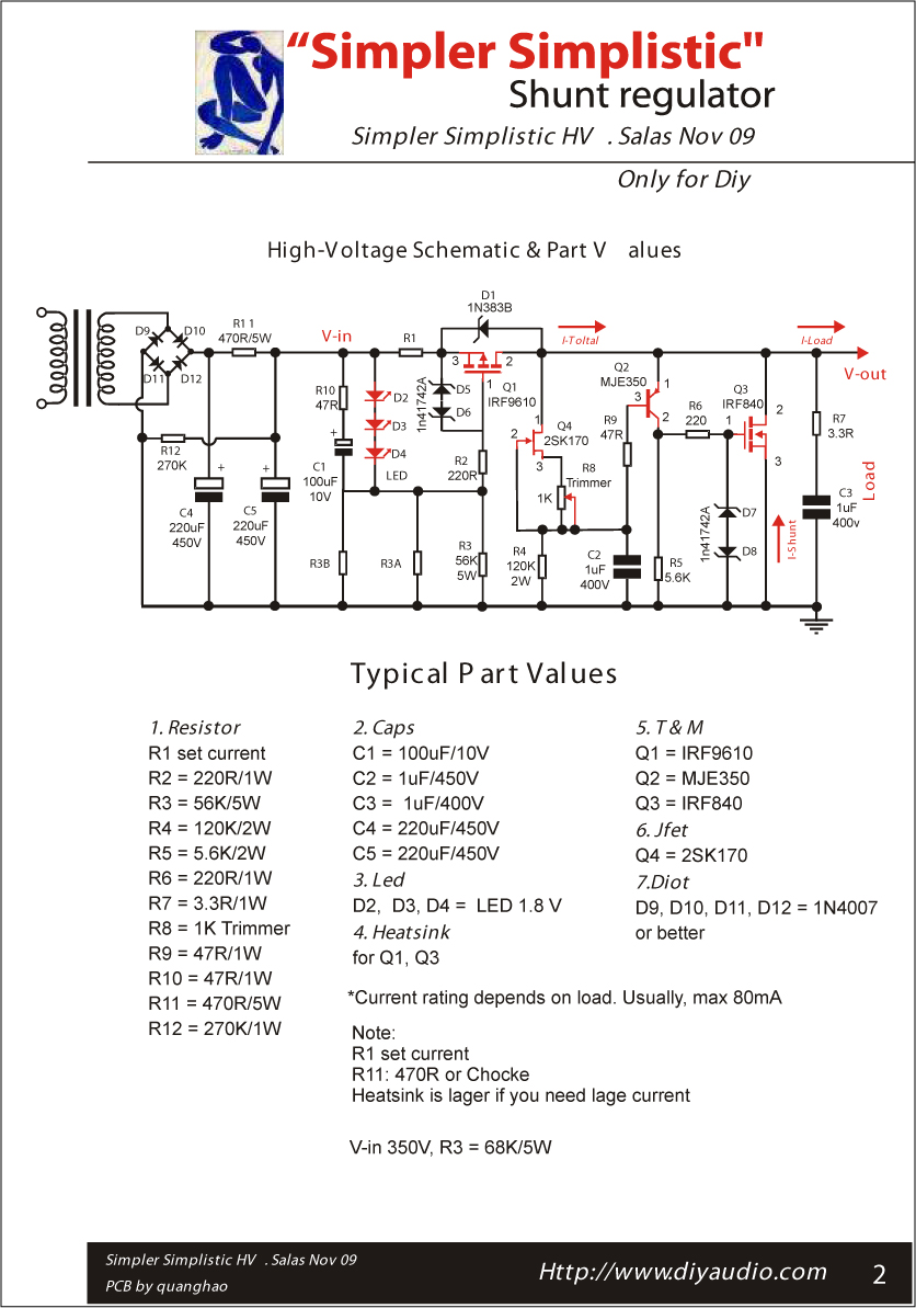

The circuit above has been checked enough, its stable, and it can go over 300V if the MJE350 is substituted with a proper PNP driver transistor like the 400V MPSA94 etc. R3 should be 82K & R4 220K in an over 300V application. The MJE is better if you target lower than 300V. The higher resistive load (R5) on the error amp than what I usually practiced, saves in driver BJT's heat and helps its stability in higher voltages without any performance penalty. Sometimes I use optional protective Zeners for added mishandling safety. Not strictly necessary though. Just use D1, does most safety. 15V DC IN-DC OUT is the lower limit for adequate performance. No less than 20mA must be left running in the shunt on top of what the load demands. Here is it again showing the proper application of safety Zeners. Also a point 2 point example of mine in the second picture.

I would like to use this schematic for my low voltage preamp, it is need 130-140V/50mA to operate. Could you guide me how to get those voltage, ex +135VDC out with 250VDC after regulate

I can't get IRF9610 and IRF840 at local shop, they are only have IRF9620 and IRF740.
Can I use IRF9620 and IRF740 to replace for IRF9610 and IRF840?
I've read the datasheet all of them, but I am not sure, cos they have some differences features, example: IRF840 VDS=500V; ID=8A; rDS=0.85ohm while IRF740 VDS=400V; ID=10A; rDS=0.48ohm.

I would like to ask about some high wattage resistor types , which should be used in the HV shunt.( in 300 V , out 250V )d
I know there was sugestion to use carbon resistors for R2 ; R6; R9 as gate / base stopers - if I understand correctly it should be carbon composition because of the low inductance ( what about the noise ?)
But what about R3 ; R4 ; R5 ? Normaly I would use low noise , non inductive wire wound but here comes the voltage limitation.
Other solution would be film type non indutcive ( MP930 Caddock )
- but they cost a lot of $$$ and hard to find in all needed values

They will most probably work, but I have never used them to know if they will show any allergy.
