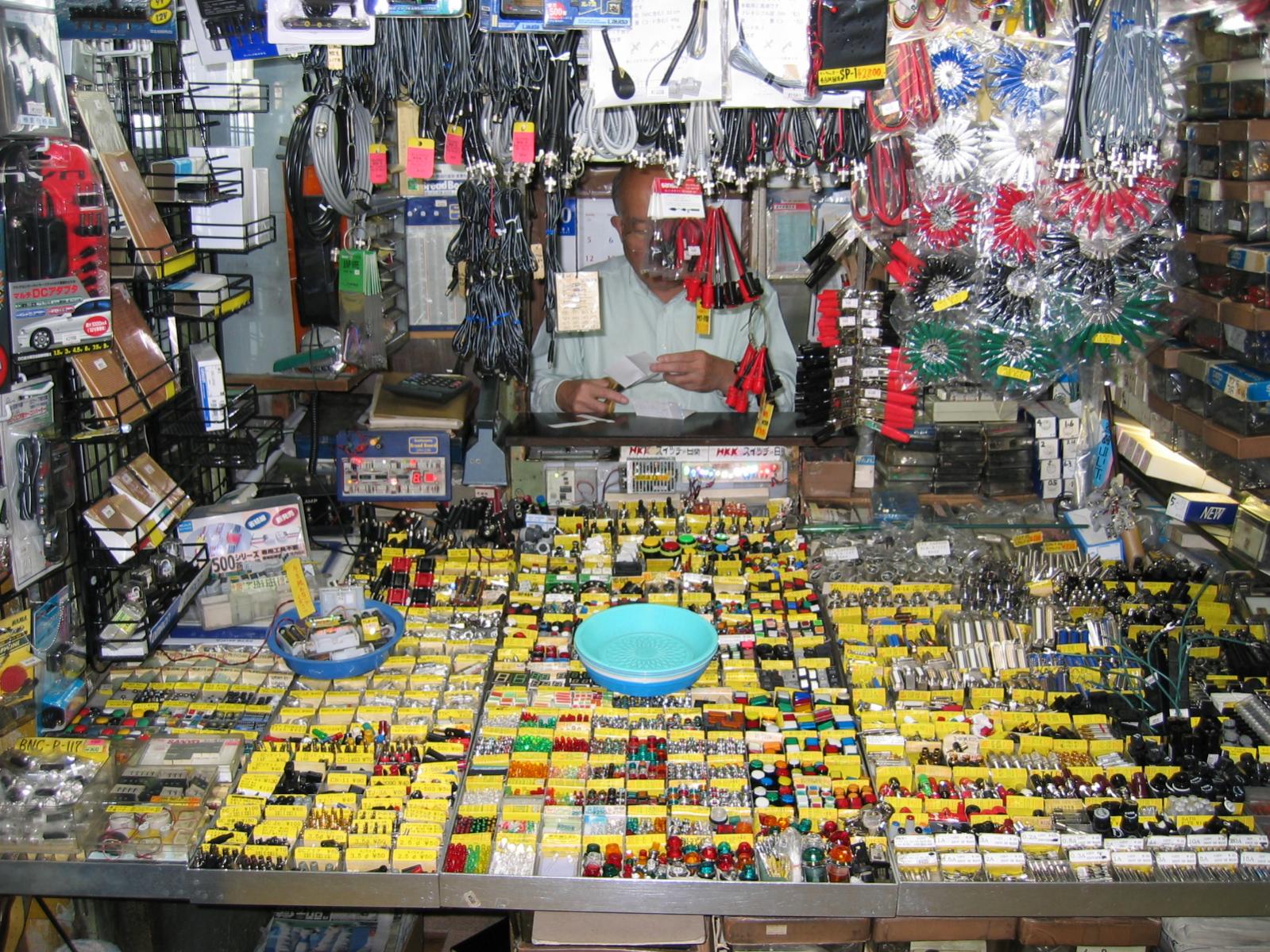

Lost in Translation
Salas,
Here are three Japanese candidate for a 400 V 100mA shunt. What do you think ?
It's funny how Japanese can be patriotic, they have all their components series. If you ask for a vulgar BC transistor they look at you like you are a loser
Thanks,
D.
