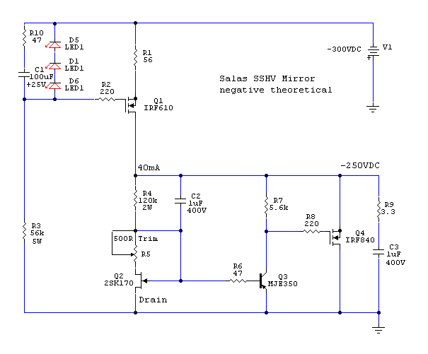

hey salas,
when you said (post 1001) that you would mirror the reg s schematic for us but had no HV gear to test it on, what did you mean exactly? did you mean something like an amplifier? because there is a possibility that i could be able to send one your way.
I will try to theoretically mirror one so you can try instead and tell us if it works.

Here you are. Just theoretically OK. Good luck.:)

one question:
what is the most proven pre reg filter for this reg so far? do you think 220uf+470r+220uf would be a safe choice, as i ve seen a couple time here before?
edit: also, what i want to power with this reg (exstata) requires 300Vout. any change required to the circuit (+ and - reg)?
diyAudio Chief Moderator
Joined 2002
Some builder have shown SSHV DVM photos with the MJE350 holding even at over 300V (which is its spec). So give it +/-320V DC input and go +/-300V with the trimmers. What is the +/-ma that your electrostatic headphones amp will consume? Needed info.
