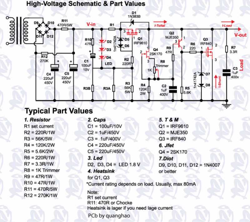

Those boards as far as I am aware of they work right away. I would check that my 2SK170 is OK first. Giving only 50V gives suspicion that the Vref is starved. Either the trimmer isn't going low or the 2SK is bust. Then I would see about the MJE is OK. Also use load. Is there anyway to do something wrong with the board? I have seen it takes centre tap or not trafo connection. Maybe a trouble there?
I've changed all transistors, all zeners D5 D6 D7 D8 are ok. V in 220+220Volts leds switch on
after the rectifier diode I have 300Volt cc and just 50 out regulator, IRF9610 and IRF840 are very hot in few seconds also with no load...
this is the diagram
this is the diagram
