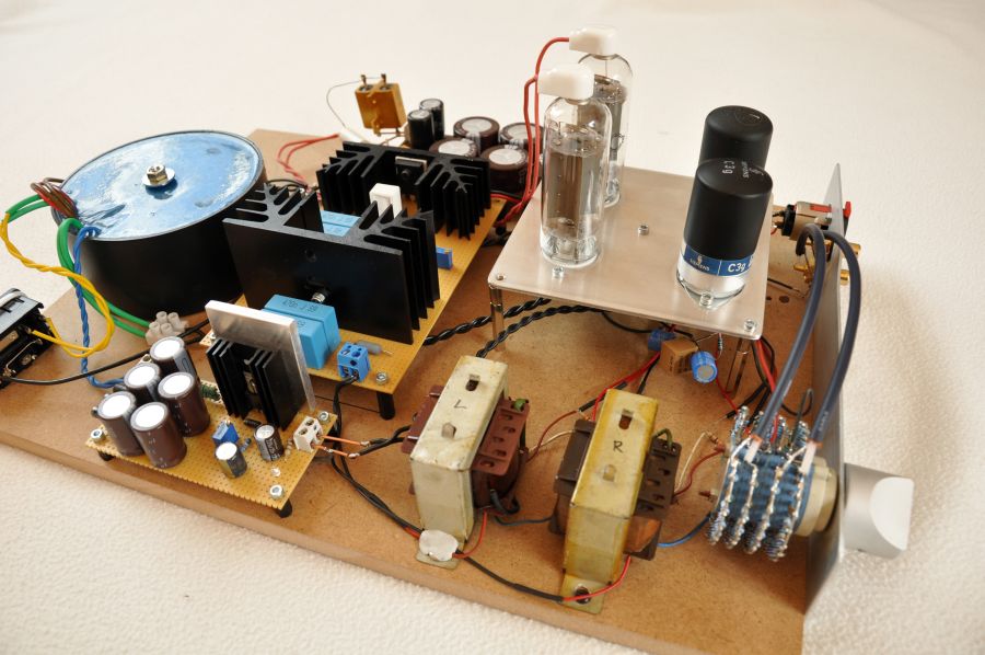

Thought I put up something positive on this thread again... I am running the older, first version of the Salas shunt reg in two of my headphone amplifiers,
one being an Aikido and the other one a breadboard to try different pentodes on triode mode.
Well, i settled on the C3G that I already use in yet another headphone amp (OTL) and, after some parts chasing and having to find suitable output transformers, I eventually got it playing music, and very fine it does!
short facts: shunt reg set up to 80mA, 35mA and 170V into the load... C3G triode wired with 150R and Oscon in the cathode, 880R gridstoppers, vintage Grundig SE output transformers that reflect about 10K to the tube with my 300 Ohm Sennheisers, heaters DC regulated.
Initilally had some hiss and then probably low level oscillation, but after changing the layout a bit (transformers in // to have short leads to the HV regulator) and tying the heater reg to ground it started to perform.
In fact it sounds very very good... as expected it is absolutely quiet, resolution and low level detail is near maximum, timbre is very natural and rich, and this thing is FAST! I have yet to find another tube that does cymbals and hihat better than the C3G...
Shostakovich gave me the goose bumps today, Marcin Wasilewski was playing nice and mellow, and Eiving Aarset proved that it doesn't collapse when the going gets tough... :spin:
So credits again to Salas for being such a nice and inventive guy...:cheers:

Great to hear its working with tube sized OPT's, I guess its time for me to start building.
How short of a lead are we talking from HV reg to OPT? This will influence my case decisions.
You can see on the pic... the transformers facing towards you and two thin leads going to the left.. about 80mm I guess. But it was a big difference to before when I had the xformers placed on either side of my tube 'platform' and leads were very different in length... couldn't get rid of some strange symptoms.
Right, I was afraid myself that it wouldn't work but was surprised that there is absolutely no lack of bass. Maybe not as tight as solid state (M3) but still very defined and punchy... 😉
