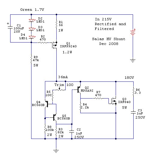

I use the Salas reg as in this schematic. Is it ok if I increase the Vin from 215V to 240V without doing anything to the regulator. As I see it the current draw will still be about 36mA. I have a big heatsink and the temperature is very nice today, about 40C I think.

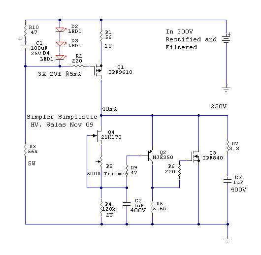

Hello Salas, after reading 120 pages of thread (whew!😀) few question just to clear my mind..
i'll be using the sshv for the aikido pre i'm building, load will be 40mA, ps filter will be CRCLC.. i was going to use just crc as suggested but i decided to add an rc cell to drop voltage to 300v, please correct me if i'm wrong:
R1=22r for 80mA load, that's pre current needs x 2
R3=68k for 300v Vin or 56K?
led trio drop from 5.4 to 5.7
shorter connection possible from regulator to load
after populating the pcb and triple check for everything, start with trimmer halfway, 500r or 1K? or like piero7 even a 100r one?
thanks for your time and work!
i'll using this scheme:
