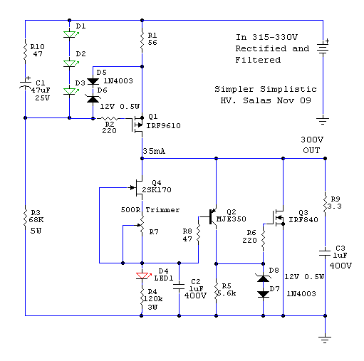

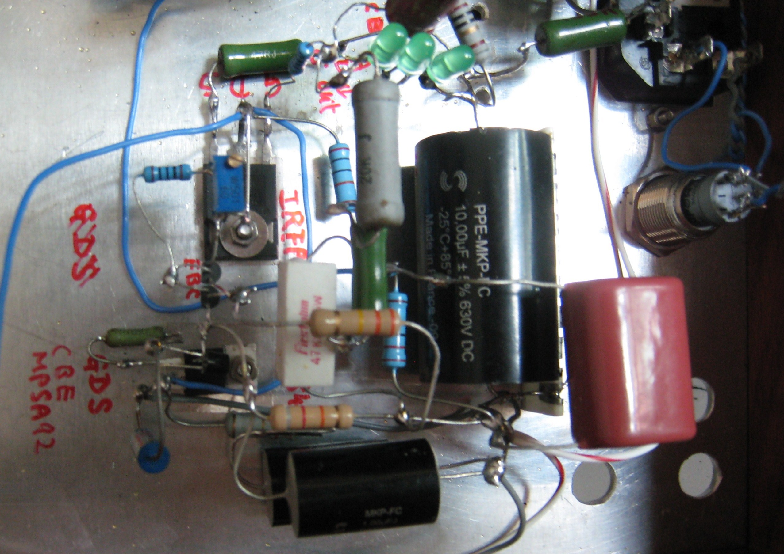

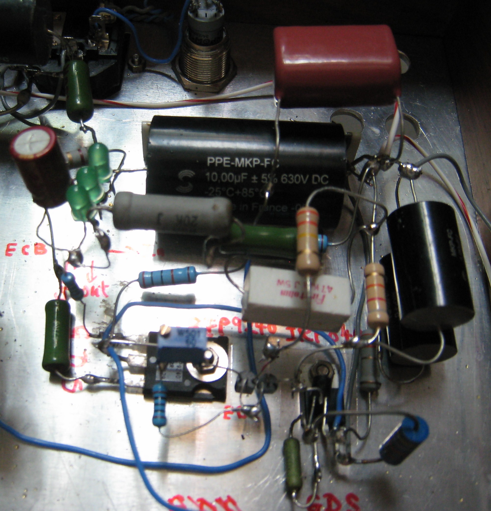

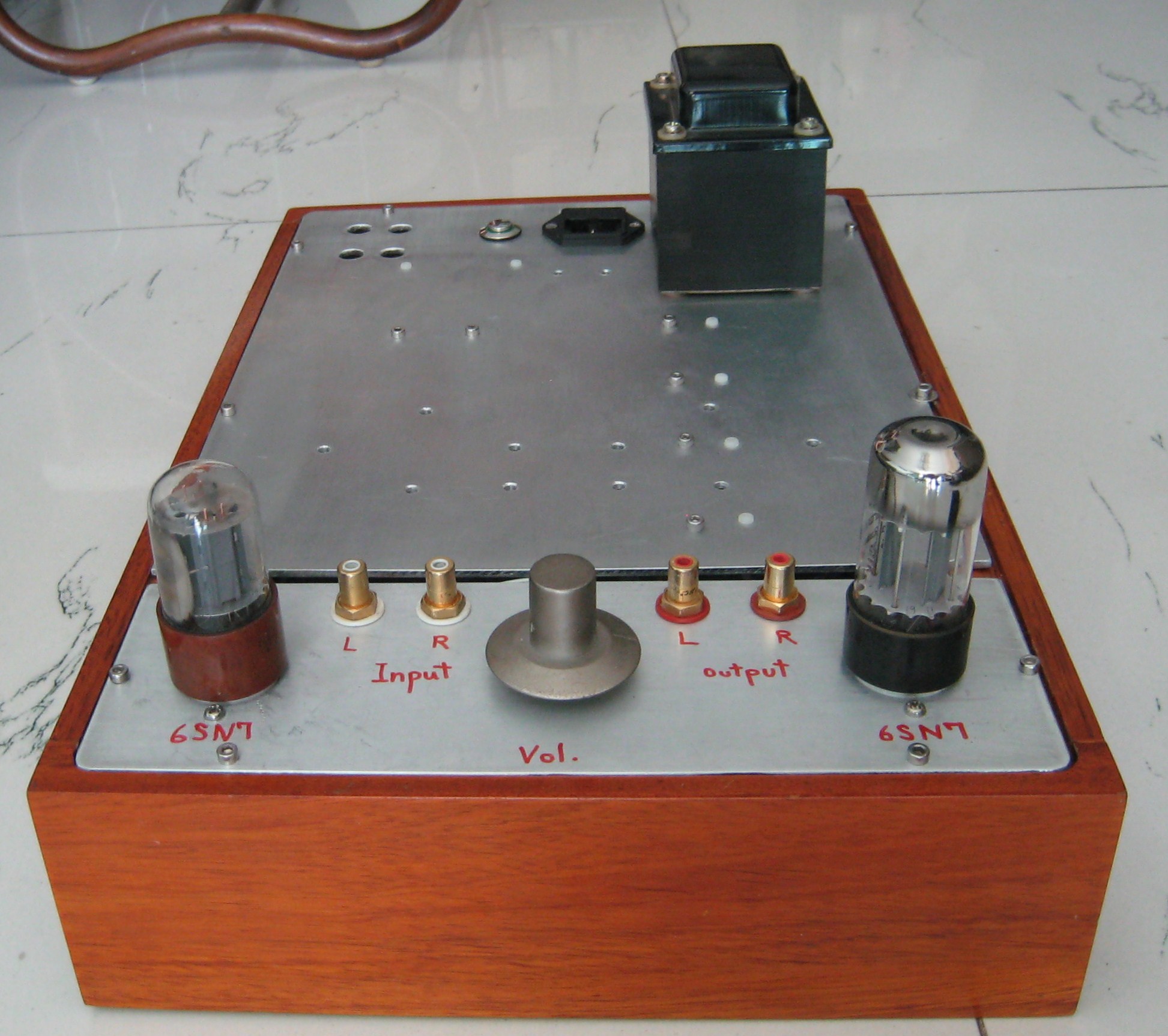

I did a point to point wiring of Salas's regulator !!!
It works and plays very well for my 6SN7 pre amp.
Saving the cost of choke and expensive filter cap. I use 57 ohms for R1 so the CCS current is 34ma approx. and fed by 360V raw DC, out at 300V for two 6SN7. The total current consumed by this pair tube approx. 16ma and I tried to tripple the supply but it's getting hot !!!! I just use the chasis cover for heat sinking so I go back to double the value only.

Truly unique build. The BC transistors first reg in direct to chassis dead bug wiring! Are you sure you want to dismantle that for a later update?
Also, if I feed 360V raw DC, will it cause any problem?
Thanks Salas
No.
