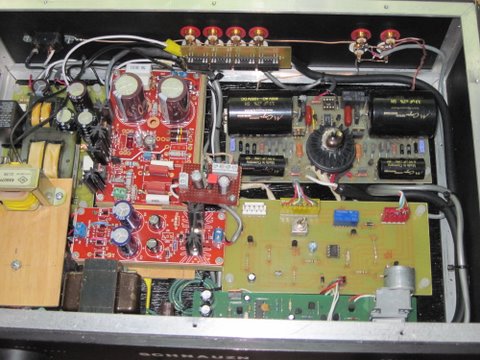

Tubenstein, I got your PM and I will answer your questions starting with the attached photo. The photo is not too good, because its been compressed to post here. The original requires 3 meg of space and I could send it to a private email if you like.
First, I am surprised to learn Sonic Frontier (Parts Connection) today offered Daniel II pc boards. I though it was Daniel I only. I built 3 Daniel 1 and got my boards from them. I never heard of the model II at the time. Only Curcio was selling them.
If you got a II, you are very lucky, because it is a better machine than the one. Of course, Daniel I is not a bad instrument. The ones I built are still in operation and their owners are very pleased with the performance, except the II is a substancial upgrade from its earlier model.
Yes there is a Tent Labs 15V fixed regulator in there, it replaces the 7815 supplied by Curcio. It is pin to pin compatible. I removed the 7815 and soldered a 3 pin socket. The Tent Lab regulator goes in there.
The shunt regulator is a Salas Simplistic HV regulator and boards are from Quanghao. This is the reason I built this one, I wanted pc boards for it. Now, only Salas could tell you which one is performing best among the many desings he offered us.
So look at the picture and if you have question we can continue via PM.

Hey man!
Thanks for pop up for assistance! Many thanks! Since you have the Salas regulator in the circuit, are you still having the Curcio stock regulator in the circuit?
Because I confused, the reason is that the 7815 (replace by Tentlabs shunt) is part of the Curcio stock regulator. Sounds like you have Curcio and Salas regulator working together. How?
