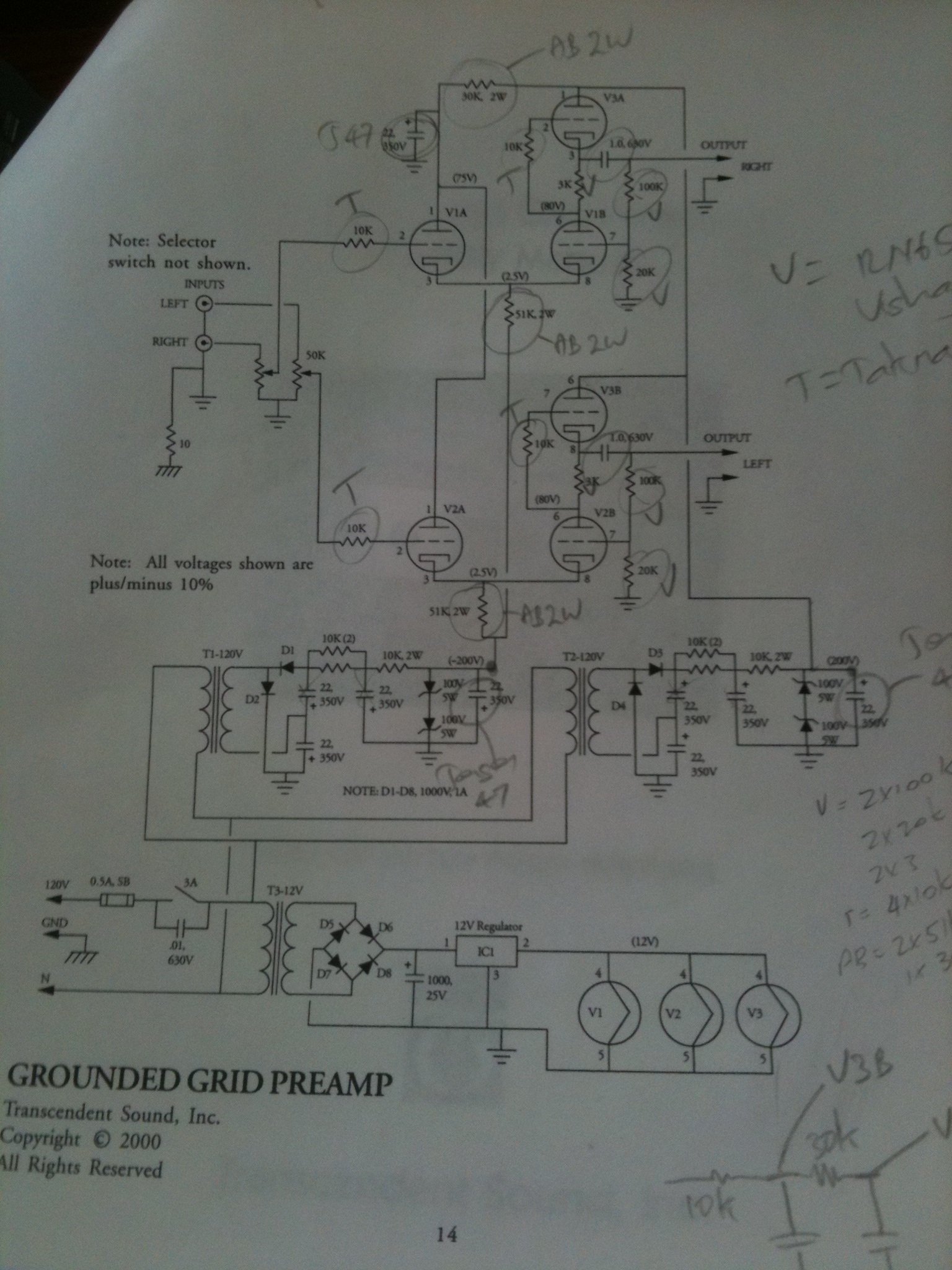

G'day as Salas,
As pm'd, the schematic for the pre I want to use +/- 200V for.
Thanks,

There is a voltage doubler there. You should find around 320-330VDC with a 120VAC secondary before the first CRC filter. There are also 2x100V Zeners for stabilizing at 200VDC in the second CRC filter. If you want to use SSHV, delete the Zeners and adjust the single 10K R element to drop no less than down to 220VDC at the 2nd CRC output so to feed the reg. The drop on R will be the CCS current times R. By measuring the drop on first CRC filter as it is now (Vacross 10K//10K) you can find the current draw need of your circuit. Divide that drop by 5K and set the CCS in the SSHV for load current+20mA and for 200VDC regulated output of course.
Ok, that makes sense I reckon, to be painful, which setup in regards to schematic should I use, also, I remember that you recommended a +50v to voltage out on the voltage in? In the last 140+ pages, is there a list of parts you recommend? I know some guys were using bc506c in stead of b etc. Least that's what memory is pulling up.

With the JFET SSHV I slacked it down to 10-20V. Depends on where you can easier burn the heat, on CRC R elements? On heatsinks for CCS Mosfet? Needing big pre filtering?. With 22uF caps you rather need high R in CRC. Keep in mind that the 9610/610 (you need +/-V regs for that schematic) will burn (Vin-Vout)*CCS current. The 840s will burn 200V*(CCScurrent-LoadCurrent). R in CRCs will dissipate RVdrop*ICCS. Check that the ratings will take it. Use that setup but delete the Zeners: http://www.diyaudio.com/forums/powe...tic-mosfet-hv-shunt-regs-182.html#post2604016
I recommend polypropylene C2,C3 capacitors, and Teflon bypass 0.022uF. There are no BC transistors in the Jfet SSHV, those were in the first round of regs. R1 adjusts CCS by (Vleds-VgsQ1)/R1. Good luck.
