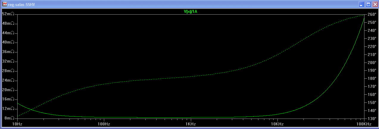

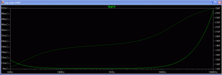

1. What's the worst case Zo over the entire audio band (20Hz-20kHz) of the present Salas Shunt?
Here's a sim graph, @ 58mA CCS, 20mA load.
So, it's about 12mOhm at 20KHz and about 50mOhm at 100KHz. I doubt if tube shunt regulator would do better.

Indeed, the question is what's the main goal, lower overall Zo, or higher Zo which is more flat at high frequencies beyond the audio band.

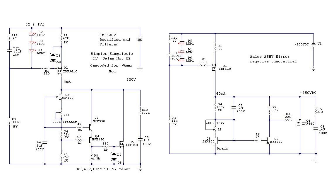

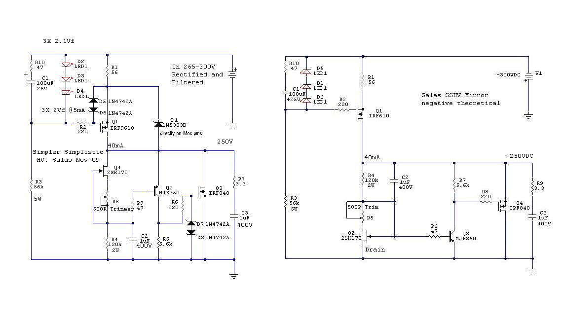

OK. I could find two regulator files that I might use on my power amp: one positive with cascode: one negative with no cascode.
Should I modify the negative onto cascode too, or use the positive in non-cascode version?
You don't need the cascode for 60V. Its no better in this circuit, we just do it to go over 300Vo. You will also need to size down the R4s so to use some 1-2mA current from the jfet for your voltage bracket in mind. Also size R3 for ~5mA. You will not need protection Zeners for ~60V too.
