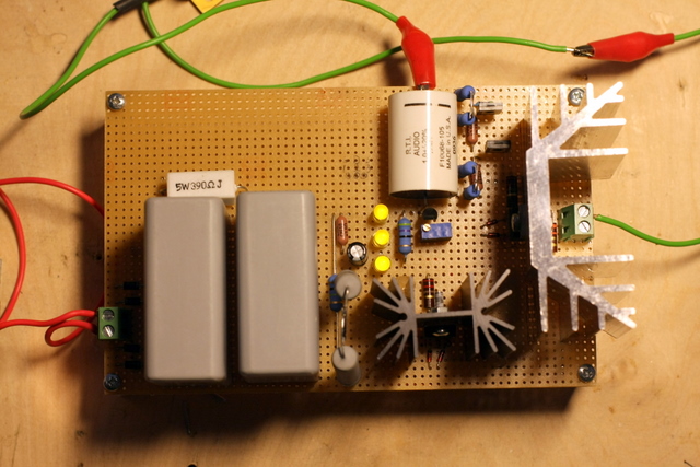

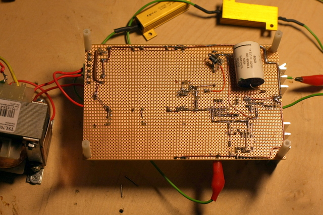

I've put together the higher voltage version with cascoded MJE350's based on the schematic from post #1750. It has been running for a couple of hours with an approximately 15k resistor load, Vin=366V, Vout=350V, Iccs=36.7mA.
I used R3=136k (2x68k in series), R4 and R5=78k (2x39k in series) and R8=4.7k. These resistor values are pretty much chosen based on what I had on hand 🙂. The pre-filter is CRC using 40uF MKP film caps and 390R resistor. On the scope I see Vin ripple is about 0.7Vpp, no ripple in output 😀.
So far looking good, now I'm off to build something to use this supply with 😀

What is the DC input voltage? I see the substantial heatsink and was wondering what the total power dissipation across the IRF840.
