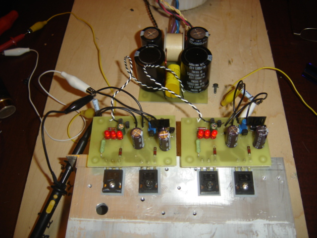

Hello Everybody,
as you all must have read, i´m at the planing of this Pre.
Will use stereo Salas-Reg and EI-Core Transformator with
serial 18VAc to get 36VAc and then rectified to get 46VDc
before PSU-Regs. So there is some Voltage to drop down.
By the way, do you all have experiences with different
Diodes as rectifiers? Recommendations?
And then, CRC or CLC Who compared those and what about
Capacitance?
Greetings Ulf

I used a 2x18V xfmr. Had initially a torroid but then switched to R-core. As has been mentioned, the R core is smoother sounding. For diodes I used schotkey from the get go, For other builds I have used differing diodes, however, have come to prefer schotkey. MBR3100RLG's to be exact.
For the power supply I used a RCLC. The R being the voltage dropping resistor. The C1 is >10,000uF. L being .35H aircore and the C2 being 10,000 Low ESR caps. I even bypass C2 with a 1uFMKP and .047MKP. (Truthfully I can't hear a dif between bypassed or not but it is there anyways.) Ripple off of the PS is <<1mV measured. PSUDII calculates a similar result. The R was measured in-situ to obtain the correct voltage and for a given load will be a factor of the xfmr regulation. The L was an old speaker crossover inductor I had laying around. It is cheap and fits nicely between the caps. This configuration provides a LOW impedance source to the salas shunt reg.
Again I went the CLC route vs. CRC as my experience in the past has been the CLC has a faster and stronger presentation of transients and better detail. (That tends to be my pref in sound).
For my build, even though I went r-core, I am placing them in a seperate box. Primarily for aesthetics.
P.S. you probably will have more than 46V volts with the 2x 18V windings. I get close to 60V in no load and 54V under load of the RIAA. The picture of the r-core shown earlier looks exactly like mine.

I will try your CLC configuration in my PSU.

0.35mH seems better doesn't it. Missed the "m" when typing and proofing. When I get home, I will open the box and read the value off to make sure.
I supposed was a typo but I will be sure, thank you.

I really like your idea about CLC on the psu.
Can you post any pics ?
Even with a r-core, best results are obtained with outboard psu.

I am using a RC combo but as my caps are four pole they have some inerent inductance.
I will use your setup when I build another psu with "normal" EL caps.
