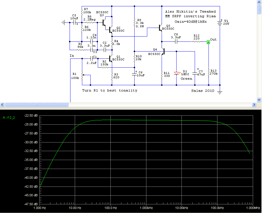

Do you have the model number so we can check better? It is most probably an MM cart. One SRPP simple one for you is Alex Nikitin's that I have tweaked the published values so to simulate nice for Riaa, and to use film cap couplers. Don't change any values. It has been used in various guises for Creek as OBH-8, and from Cambridge Audio in A3i. Also presented in 2003 here from Alex (member X-Pro) as well as in Radio Hobby magazine of Kiev. So its an Anglo-Russian theme with a Greek Tweak, as good as a vintage double-o seven flick as they come.:D

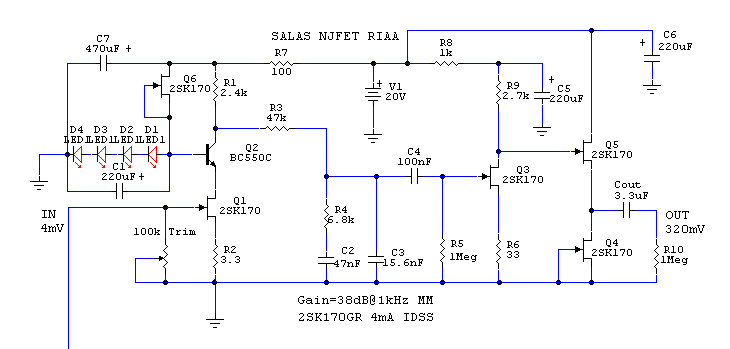

I'm new to fets and as I'm interested in this project I bought 10 pieces 2SK170 and checked them using the method described earlier in this thread: Transistor matching They all measured between 3.5 and 4.5mA. Now Salas's circuits specify 7-8mA. Does this mean they can / should not be used here in the gain stages? Are they at least good for the buffer and the Zener CCS fets or are they to 'weak' to complement the gain stages.
Sorry for the newbie questions but this is how I learned a lot from this Forum.

I have already populated the riaa boards with components except the FETs and large capacitors, so I wouldn't like to make drastic changes. I'm building the 36dB gain version which I think is enough for my MM cart needs. Don't you think so?
BTW you haven't said anything else about the GR designation on the fets. I'm curious. Bought them from a UK supplier.

BTW, forgot to tell you I ordered a matched quad SK170 from Spencer on this Forum anyway, thinking I would use them in the gain stages of your NJFET RIAA. They are even cheaper than the ones I bought from UK. I asked him to match them 7-8mA as per your circuit note. Now I'm worried the ones I have (GR) are way out to be used in the buffer and Zener CCS position.
Regards.

The 36dB is fine for those carts. Keeps gain adequate and noise too. GR are the ''green'' lower Idss Toshiba selection. They have GReen, BLue, Violet. Increasing Idss range. By having the boards populated, I have to look in to the 36dB and see if we can tweak some resistor values for the buffer output only so to fit the GRs there. You said you got 10pcs, so we can spare a couple to make it constant current like B1. I will be back with it very soon. No Zener, you will use resistor in the reg voltage reference, and leds in the phono. Nice you got your SB from Kof's thread up n' running again.

OK, here we go. Use your GRs for 1st and 2nd stage, also in the reg, and put the matched BL in the 2 buffer Jfets positions. More mA for output. The slightly lesser in Idss from each pair will be Q4. For Q1 and Q3 use your best 2 pairs of GR near in Idss per position per channel. Use a 10K trimmer in the reg instead of a Zener, wired as your phono input trimmer. I saw that 38dB is better for 4mV cart like the Nagaoka, 36dB is better for 5mV carts. With such low gain and low R2 your noise at output will be negligible. Turn the input trimmer load for finding your best preferred tonality. Good luck.

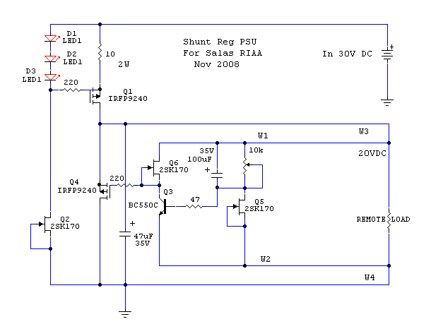

Thanks Salas. I’m not sure I understand you correctly when you talk about the trimmer. Are we saying we’ll have two trimmers:
a) 100K trimmer across the cartridge input (replacing the input resistor (47K) and capacitor (~ 100 pf));
and
b) a 10K trimmer in the regulator instead of the Zener. Here, are you referring to the 20-22V Zener between the Source of the IRFP9240 and Drain of the SK170 in your Shunt Regulator?
JA
diyAudio Chief Moderator
Joined 2002
a) Yes. Its in the one I posted above as for variable input load. Replacing. Influences your cart's response much, tunes easily.
b) Yes. Do the attached schematic. W1,W2 sense wires that meet W3,W4 main current force wires at the DCin,GND same points on the phono (remote load). All Leds red BTW.
