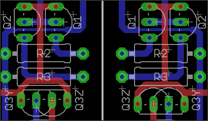

Any Japanese PNP with good Early voltage and low Cob in 1. Emitter 2. Collector 3. Base pin format fits the Q3Z position. See its >350 HFE too.
Else, any brand name high HFE BC560C in Q3Y position is sufficiently good.
To clear any possible misconception, as already stated in the guide, you must use the recommended European type OR Japanese type PNP. NOT both.
Here is how they visually go to PCB. In one channel you face their backs in the other their fronts in mutually shifted manner due to mirrored layout.

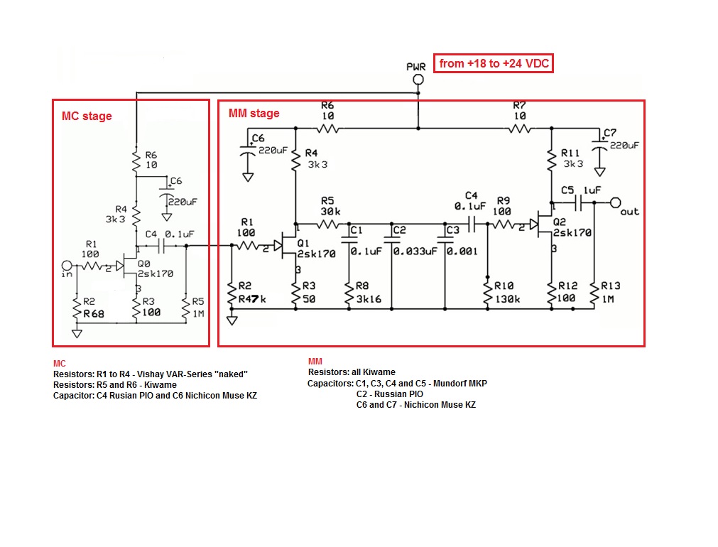

Dear Salas,
I need you exceptional knowledge and vast experience.
I recently found that Forum and surprisingly figured out that KIT which I purchased from BLH laboratory is actually based on your design. Please see attached schematics.
Can you please advice me how I should optimize it for my cartridge. I use Ply cartridge (actually made by Benz Micro for Wilson Benesch TT) which has Low 0.58 High 1.58 mV output. Resistive Load is 10-47k.
So far, I have some harsh in my mid-highs.
I also would appreciate if you will advice about PSU. I saw your shunt here, but it is so many variations of it that I confused.

Hi
The circuit you posted looks more like MadsK take on the Pacific than anything else.
The Folded Simplistic has its own shunt regs and bears no meaningful resemblance to that one except generalities.
You can get SSLV1.1 regs PCB from the GB that's on now if you want to try shunts.
The harshness could be due to the heavier than proper interstage loading and extra noise from the gate and source resistors values. IMHO of course. Circuit's internal workings in other words.
You could be over driving it also through the MC stage if you got the 1.58mV cart. Try the straight MM input in that case.
