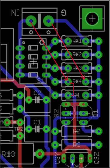

While I appreciate the flexibility offered by the new folded boards, I am not generally one who changes cartridges a lot. My MC cartridge likes a load of about 100 ohms. I am trying to save a little money and minimize component count, so I assume it would be OK to use 100R for R1, and leave out the switch and the Rxn resistors. Is that correct?
Yes for sure. Its OK when you know its one certain thing you want it for.
You could bring the input coax nearer to the input JFET(s) arranging at empty Rx4. To skip unused traces and exposed signal loop.
