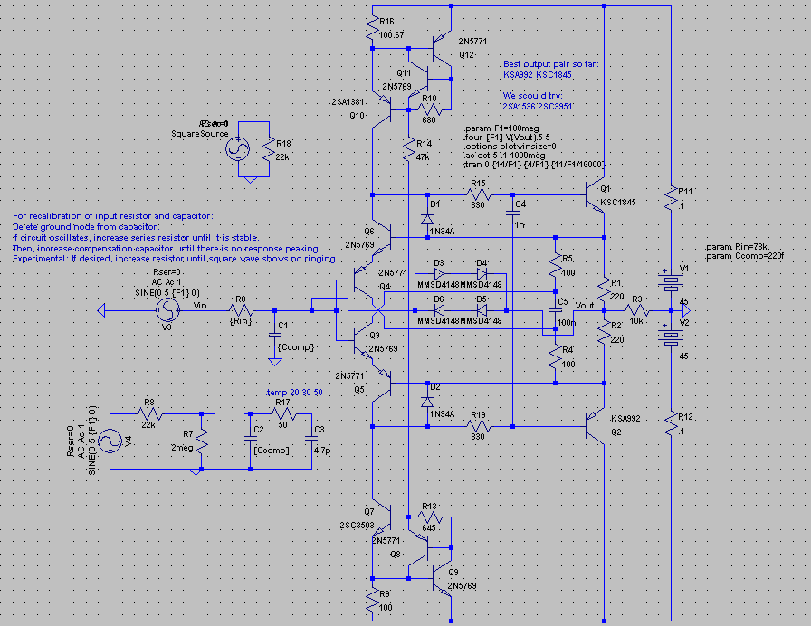

Ken, I assume the storage time has to do with Cob becoming larger as Vce decreases? I agree that the Vce is very low, but I don't think they're in saturation. Maybe you should explain?
Here is my latest diagram, with input protection. It's taking form, though I haven't gotten to prototype it yet.
- keantoken

Collectors of Q3 and Q4 have 2 diode drops worth of standing voltage, good.
I'm not sure I can say the same for Collectors Q5 Q6? Which need only fwd
bias single emitters of Q1 Q2 and a small series resistance.
What if you add a Schottky or Darlington drop in series with the bases of Q1
Q2? Thus preventing Q5 and Q6 collectors from working at such extreme low
voltage.
I'm not sure a sim here would show the benefit, but a real circuit might.
I'm concerned that these must be flooded with carriers to achieve such low
VCE drop, and the quiescent current is fairly low to get rid of it quickly.
I would have used Darlington or CFP output configuration, but I soon found that this did not work well at higher frequencies. It is necessary to use single EF to achieve this high bandwidth with a circuit this complex as far as I know. I suspect putting a diode in series with the bases will have a similar effect, but I will try it.
Okay, diodes in series with the bases does not work very well at all at HF and isn't good for stability either. But emitter diodes are workable and don't seem to degrade response.
- keantoken

Regarding transistor storage time. It is caused by stored charge in the base emitter junction and in the simulator it is related to Tr. If you look at the base current during the storage time of a transistor you will see a reverse current. The Baker clamp prevents saturation of the CE junction and thus prevents excess charge from accumulating.
