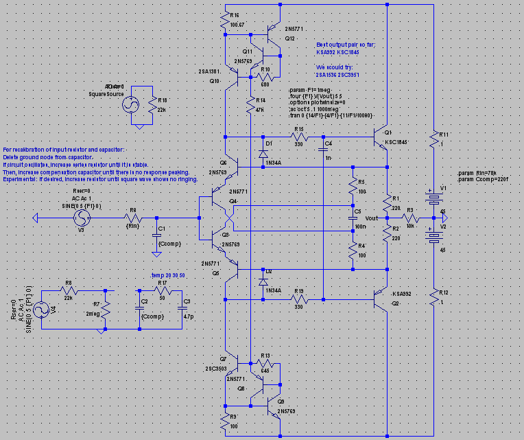

Tweaking symmetry in the superfast... No special reason why.
It was working fine, no point screwing with it, so I did...
You had one CCS at 5.3mA the other at 6.3mA, balanced that.
Also you had dissimilar transistor pairs up front. I made both
series emitter pairs quasi-complimentary BC557+BC547...
It didn't help or hurt. Like I said, just pointless nittweakage...

Exploration is great catalyst for new developments.
My thoughts:
1: I used the BCxxx pairs for the input so as to have greater input impedance. This appeared to have very good results at first but decreased stability and the required compensation.
2: The CCSs were unequal so as to reduce input offset current. With high-impedance sources, 1uA of offset current can do bad things with DC readings.
1: This circuit doesn't seem to care about Hfe except in the output transistors. It is actually better to select transistors for voltage gain. This is why I still use the 5769/5771. However, I haven't tested this specifically in terms of distortion and bandwidth.
3: I might soon be able to go to radioshack, at which point I will (if something neat doesn't catch my eye) buy some veroboard I spotted that is perfect for prototyping exactly this. So I might be able to test it out. However, my scope only goes up to 1MHz (with 10uV precision! ) so I won't be able to do extensive tests on bandwidth.
6: I think I have found the perfect output pair candidates:
http://www.datasheetcatalog.org/datasheet/sanyo/ds_pdf_e/2SC3951.pdf
Too bad no spice models.
Can't find anyone who sells them either.
7: I experimented again with changing the input transistors back to the good ol' 5769/5771. The results were better than I expected. Input impedance is tolerable, still much better than my scope. It was also much easier and simpler to get stable. I might have been shooting myself in the foot by putting those BCxxx in. Schematic:
I documented my methods for compensation, as you can see. The blue text refers to the input resistor and C1.
I have attached the .asc file (in txt format). Kenpeter, I see you've caught on to my naming conventions.
- keantoken
Look again at again-again: The quasicomp pairs made not only zero
voltage offset in the output, but also zero current offset for the inp.
And that was with current sources manually trimmed to hold the
same quiescent current to either rail...
I was only looking at the output behavior when I first posted...
I'm surprised to find that the input current has no offset also???
Hadn't actually checked that before. I guess the N and P betas
had been chosen fairly close in the models... May not be that
way in real life.

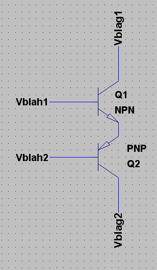

How about AC gain?
As in Vrms(out)/Vrms(in)?
The Allison used with CCSs has lots of voltage gain. Since changing between BCxxx and 5769/5771 transistors has very little effect on distortion performance, I concluded that current gain had very little to do with the performance of this circuit and that a more useful parameter was Ic vs. Vbe (effectively voltage gain, no?).
Of course this will be dependent on the load, but it has proved useful to me when simulating using the Rush Cascode.
For example, using this equation in reference to the attached schematic with an AC analysis, I get what is similar enough to an OLG plot and has worked well enough for me for getting the Allison stable.
V(Vblag1,Vblag2)/V(Vblah1,Vblah2)
(this will not make sense if you use it in a transient analysis - you must run an AC analysis to make use of this equation).
- keantoken

keantoken,
The expression I gave is AC gain (volts per volt) at lower frequencies. Note that Ic is the DC operating point. (Yes, gm changes with the DC or instantaneous operating point.) With a CCS load the gain becomes very large (Recall that some time ago I mentioned the very large OLG of your circuits.) So the Rload is the parallel combination of the input impedance of the emitter followers, the output impedance of the CCS and the output resistance of the Allison transistors.
Ic vs. Vbe is called transconductance (gm). Somewhat surprisingly, as a reasonable first order approximation, gm is independent of the specific type of transistor. And Vbe goes up by 60 mV per decade of collector current, and the voltage gain from the base of a CE stage is independent of Hfe. If there is a resistor in series with the base, it's a different story, because the base to emitter resistance (Rb'e) is a function of Hfe.
Rick

keantoken,
I don't think I understood the first part of your last post.
Using CCS loads (on the Allisons) with currents well above the current swing in the Allisons will help limit distortion, because the relative change in gm (Ic) will be small. In addition, fT goes up with Ic, to a certain point. So relatively high bias current is good.
gm is a fundamental property of BJTs and it is given by 40*Ic at room temperature. The only way to increase gm is to increase Ic (or temperature).
You might want to spend a little time looking into the hybrid pi model of a BJT. It will give you more insight into all of this. SPICE uses a form of the hybrid pi model.
Rick

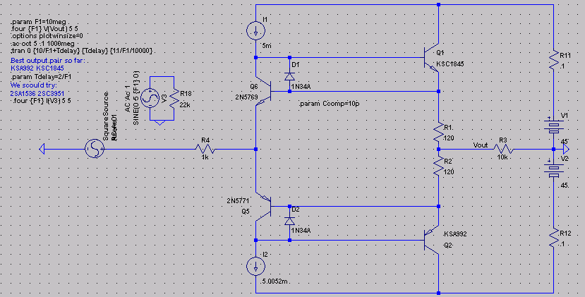

While I think about that, here is a less ambitious application of the Allison as a HF buffer. Simpler is almost always better as far as superfast buffers go.
According to sims, this does -6db at 100MHz. The 1k input resistor causes the circuit to self-limit because of internal capacitance; the value was chosen to be the minimum value where there was no visible distortion at 100MHz.
Input impedance is max, 3.27Mohms (still not bad). 544Kohms at 100KHz. 1Kohms at 100MHz.
The response characteristics of this circuit are much better than the one I have been working on.
Schematic attached.
- keantoken

Maybe you got your inspiration for the diodes from this post? Paul hasn't commented and doesn't seem to do so very often. I was just reviewing the thread and found it.
http://www.diyaudio.com/forums/showpost.php?p=1765270&postcount=22
- keantoken
It predates my first mention of them by several days.
http://www.diyaudio.com/forums/showpost.php?p=1782428&postcount=30
On the other hand, I hadn't heard of Allison at that time.
Didn't yet know that thread might be relevant to me. So
wasn't aware of, nor following any ideas Paul had written.
I found diode AB smoothing independently and by accident.
Did not know for quite a long while exactly why it worked?
If I had read that post of Paul's , would have saved me a
whole lot of head scratching.
And to answers Paul's question regarding his chosen diode
MUR820? I been favoring AB curves of MBR745. Tried several
others, but none ever seemed to cross quite as smooth.
Don't remember anymore if MUR820 was one I tried or not???
Of course, I'm still talking sim preference here, The only real
power Shottkys I have on hand are something else completely...
What I want vs. what I can get locally for cheap.

More junk added to bucket today. Clip on Heatsinks for TO92 and TO220.
Some 3x4 perforated boards with little round solder pad one side each hole.
Supertex small signal mosfets VPsomething-or-other. Compliments I hope.
I had time to cherry pick 2 NPN and 2 PNP Germaniums for matching HFE
NPN 73,73 and PNP 76,77. Possibly this close matching relevant only at
whatever unknown room temperature and current of the HFE meter.
FYI: Random grab, those bins measured like anywhere from 30 to 170.
Some binding posts, RCA jacks, other misc crud I forget...
Ohyeah Qty12 Dale .12ohm 1% wirewounds 2W, and Qty2 7.5ohm 25W...
Enough to drop up to .36ohms per emitter, Stereo... And dummy loads.
They might be a little inductive due to wind, possibly a useful "feature".
