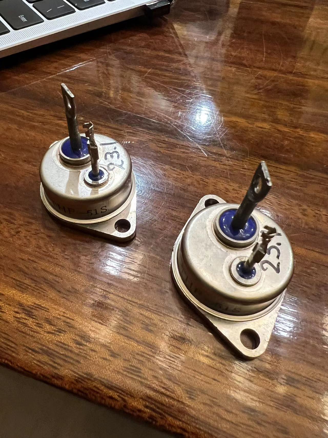

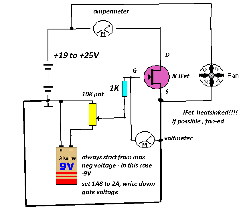

Hi Ben,
Recieved my SITs today, tested them just to make sure they worked as expected with ZenMods Ugs test curcuit and everything was good, nearly identical but not a good match for his design.
The fun continues..
G

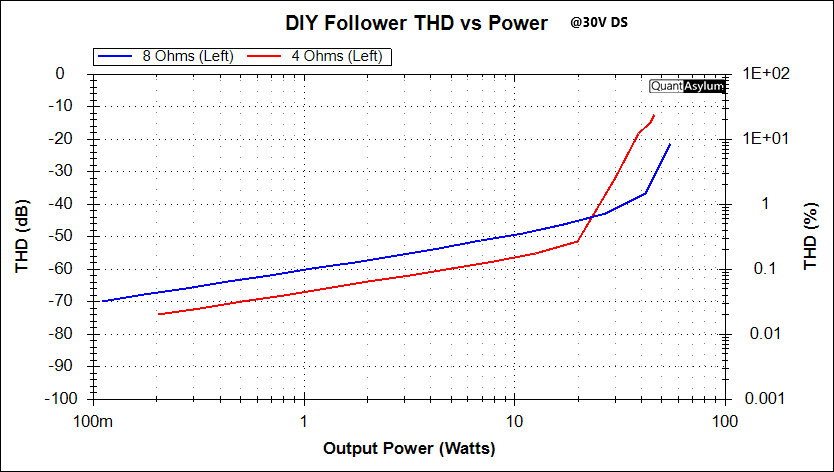

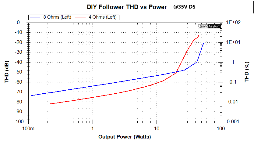

IMHO,
The bias sets the power output and as you can see if you are at 4 ohms you need more current before you clip. The big variable is the Voltage across the SIT V-DS, the higher, in the 35 volte range and you reduce the distortion and as you drop the voltage the distortion goes up.
You can see a lot of this in these graphs. The Bias is at 2.5 amps. It's all a balancing act between power dissipation, bias, and voltage levels. See MR for a nice load line tutorial at Youtube PassDIY. hope this helps 🙂
Murdoc, I went from 3.0A to 2.5A to save a bit of electricity. The distortion did go up a bit but since I don't need a lot of power, the distortion was still low enough for me.
3.0A and 2.5A with the same power supply were the only values that I tried. Distortion measurements are in this thread. When comparing the measurements, note that the latest set at 2.5A were done with the DIY FE 2022 preamp doing voltage gain. These measurements should not be compared to my older measurements where my 2SK79 preamp was providing voltage gain, as the 2SK79 preamp has much higher distortion. However the measurements with the 2SK79 preamp were at 3.0A and 2.5A, so the effect of the change in current may be seen.
Since you have a lab power supply, you can play with the operating points and decide what is best for you.

Ben,
I wondering if I could trouble you to help with some trouble shooting on this circuit.
At step #4 of power up I have the MOSFET attached and an 8R load to the S-D of the SIT position (no SIT attached). With the DBT in place I power up and get ~1.4A throught the 8R, however when I take the DBT tester out the current spikes to 5.5A (I'm uncertain of the exact value as I cut the power very quickly), well beyoud expectations. I replaced the 8R with a 200R and with the DBT in place I get ~0.3A and when the DBT is removed ~0.33A. I have the MOSFET attached to the heatsink, and have not felt any heat coming from it, but I didn't keep any of this test running for very long.
I measured the MOSFET voltage compared to ground and all G/S/D were at rail voltages. I took the MOSFET out of circuit and of course no current flowed and G=-19V, S=0V, D=rail, again all with reference to ground.
I'm using the IXTN90P20P, DS attached.
Any suggestions for my next steps?
One more quick test I did after writing this:
16R accross the SIT S-D and with the DBT in place ~1.2 A and removing the DBT about 3A, again I didn't keep it running for long.
Thanks in advance for any advise to help me move forward.
G
G
First check the 10k trimmer and make sure that it is set to maximum resistance. If it is installed as I have shown it should be at maximum counterclockwise. That should set current to minimum. Then clockwise rotation should increase the current.
Then with DBT and 8R in place, is the current lower than before? Just to be sure you can adjust the trimmer and observe if the current increases.
