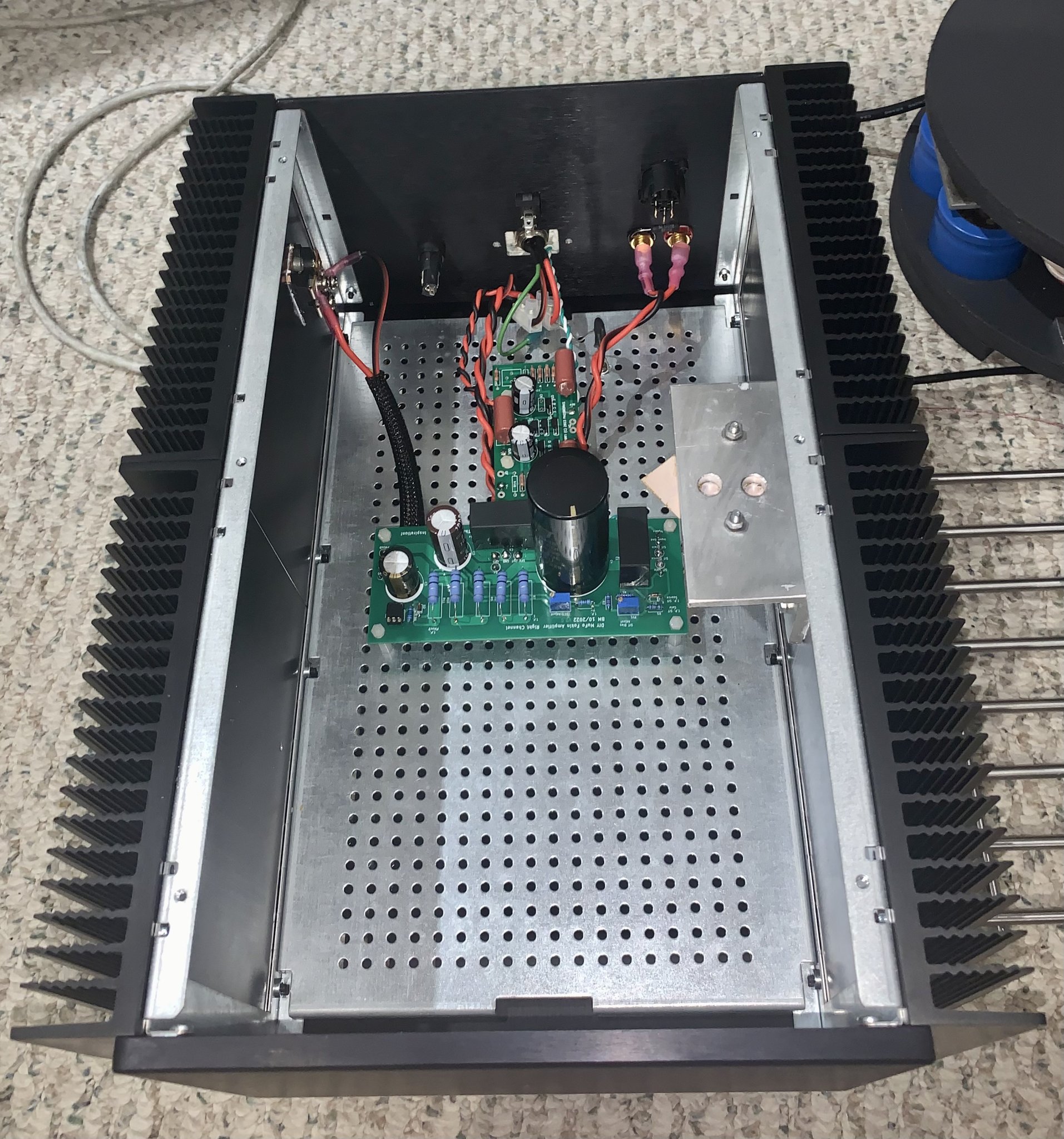

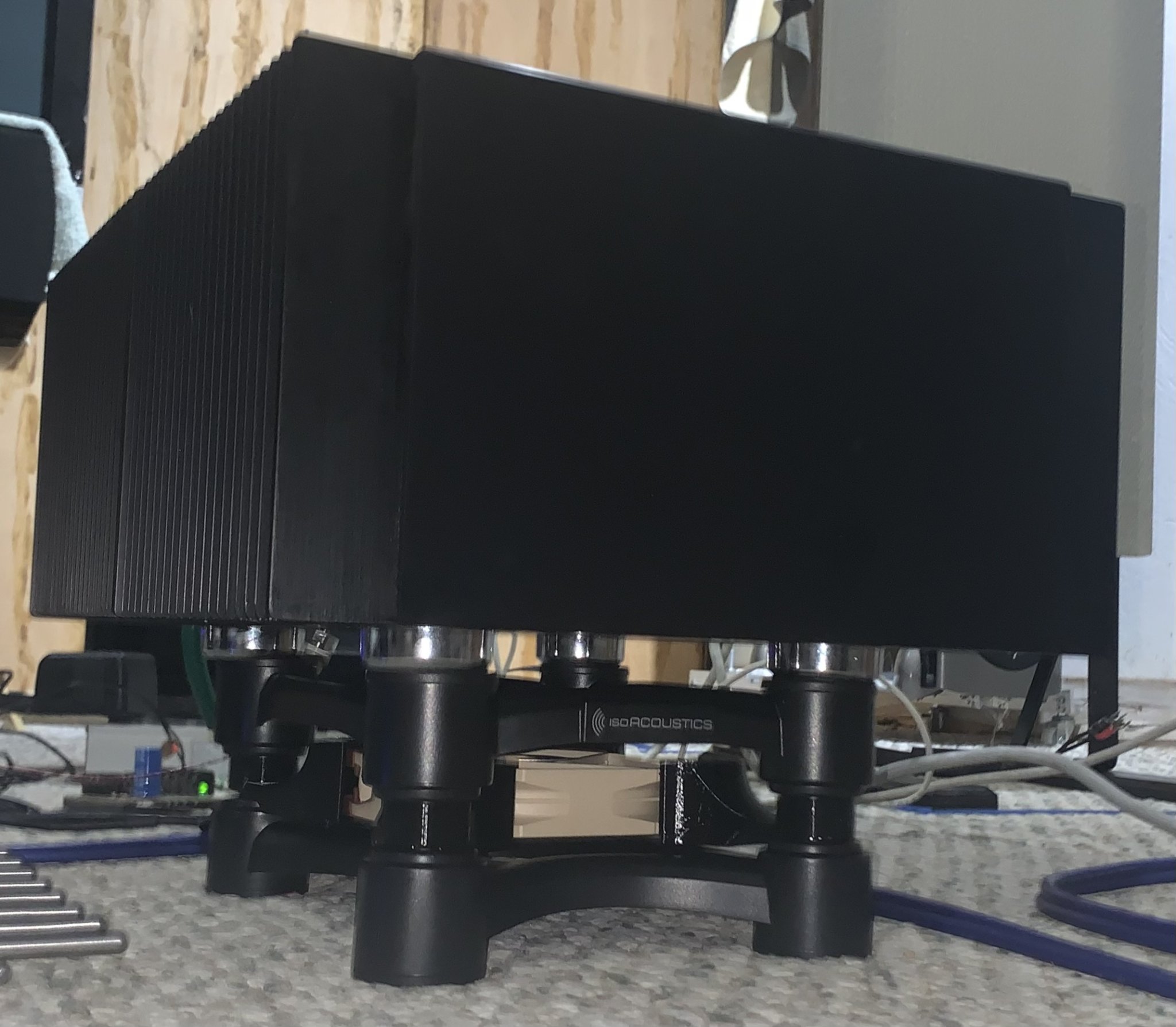

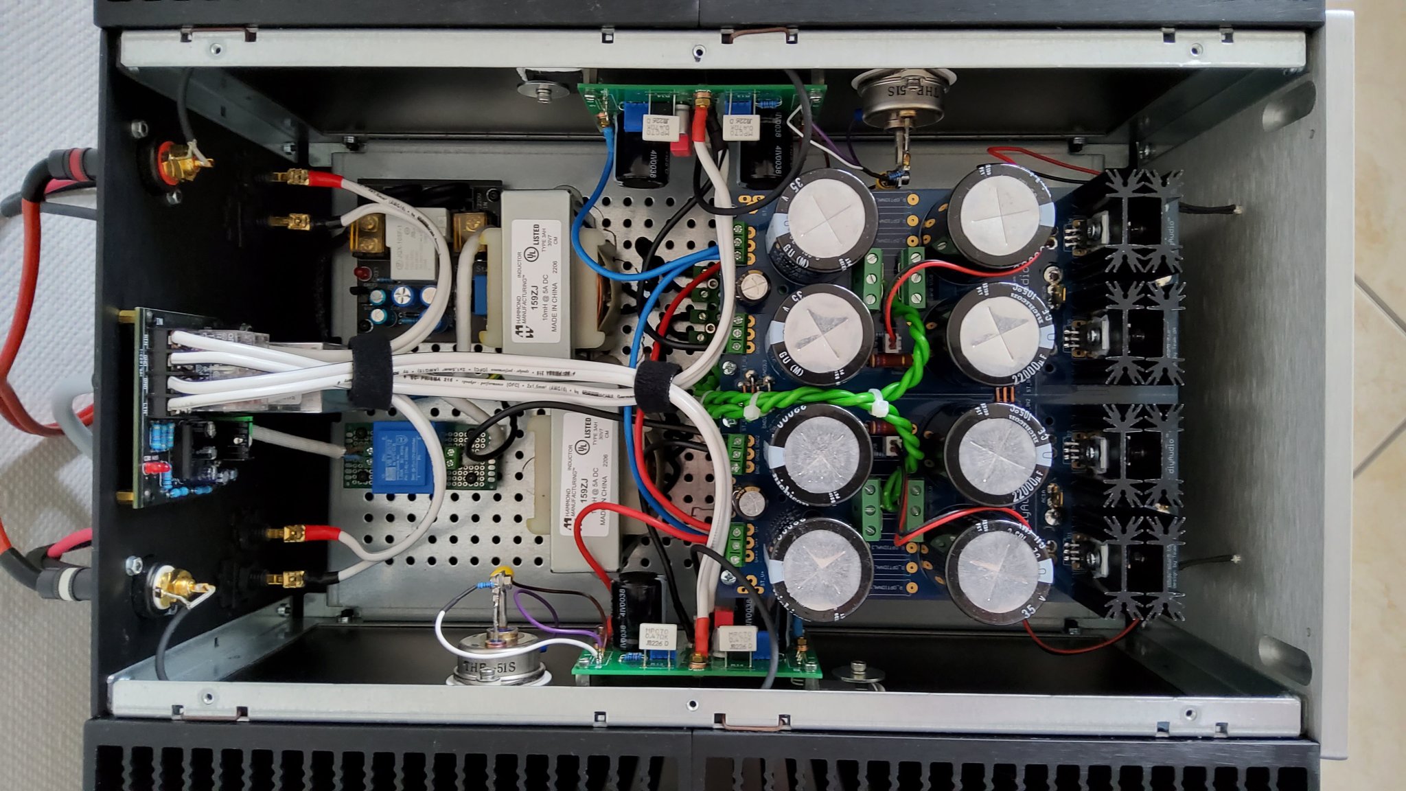

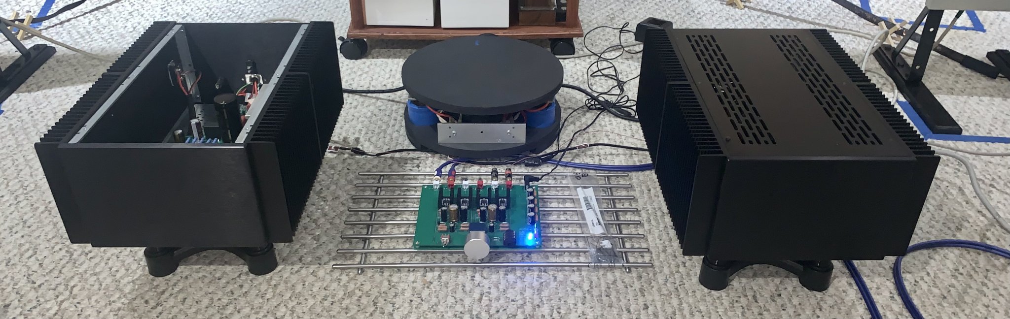

Both channels up and running. Comfortably driving a pair of LRS+. The sound….is a thing of beauty. Lottery amp on steroids. Magnepan should demo with these amps.
Superb dynamics and low level detail. And best controlled bass I’ve heard on the Maggie’s so far - mainly Class D used previously.
Cautiously biased at 2.3A. Sadly the chassis’ are not mine so this is only a temporary home - hence the power and input connectors out the IEC inlet hole.
Babysitters are running continuously in low-noise mode and heatsink temps outside/opposite SITs around 63 degrees C. Probably need 5U’s. Awhile ago, while looking at a pair of ISO Acoustics stands I had, it dawned on me that the Noctua fans I’d bought (to satisfy ZM 🙃) fit perfectly in the center of the stands. All I needed was a means of support. Four corner supports that slip over the stand’s uprights were 3D printed and it worked out well - stands get the amps up in the air sufficiently to allow good inflow under the fans and the chassis allowed almost exact location of the feet to fit the stands. Fans are completely inaudible a foot away - 8.6dBA with the reduced speed low-noise cable that came with them.
Now I have to decide which limb to part with to acquire two 5U chassis.
You were right, Ben - I love the sound. Thanks again for the boards and your efforts. And, to Papa, I hope I get to thank you lots more for all the fun and great designs - these SITs are…magic!

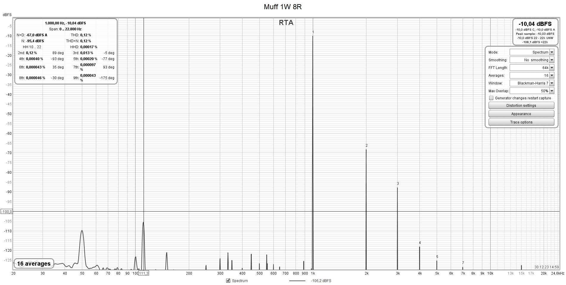

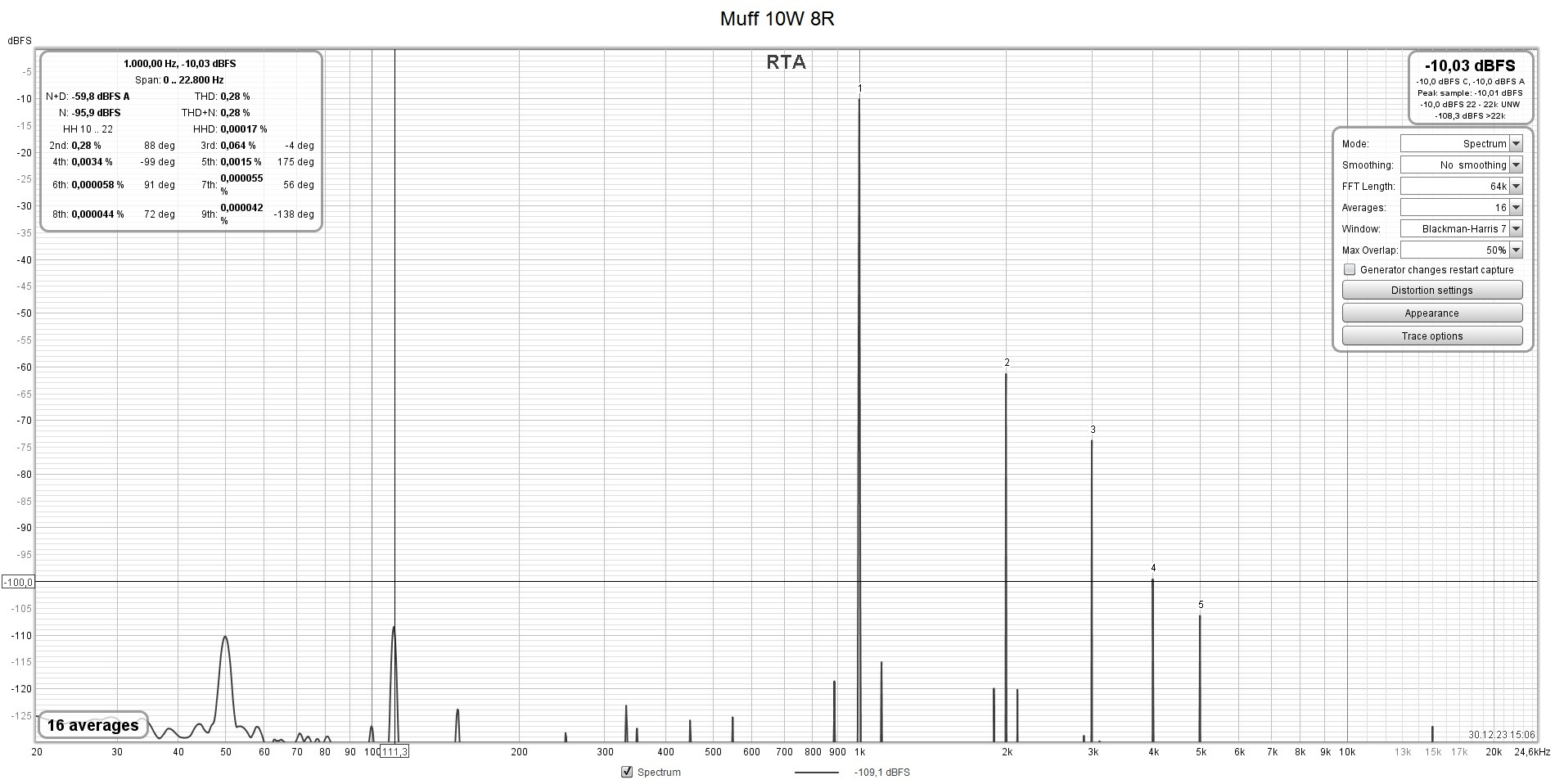

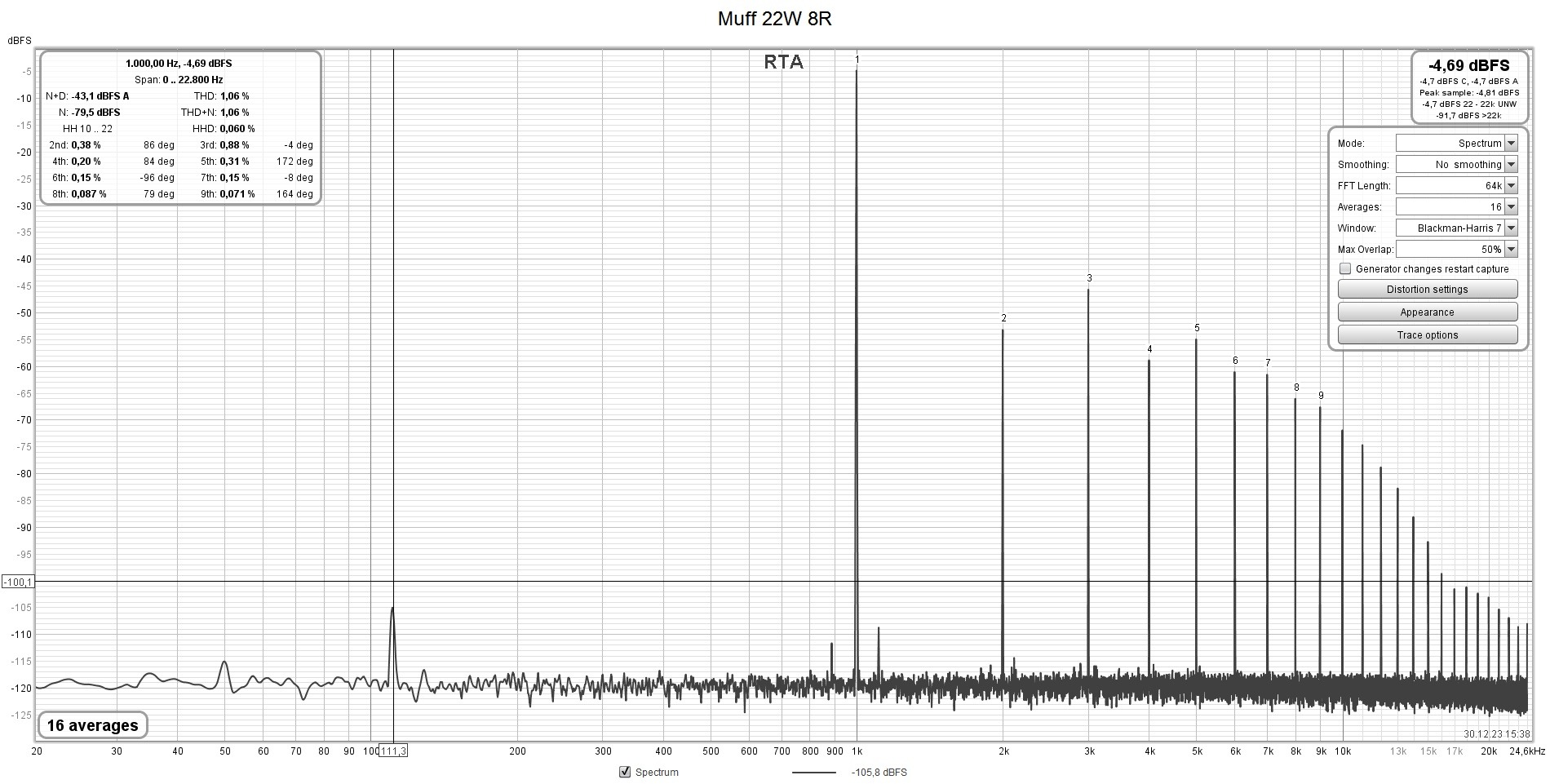

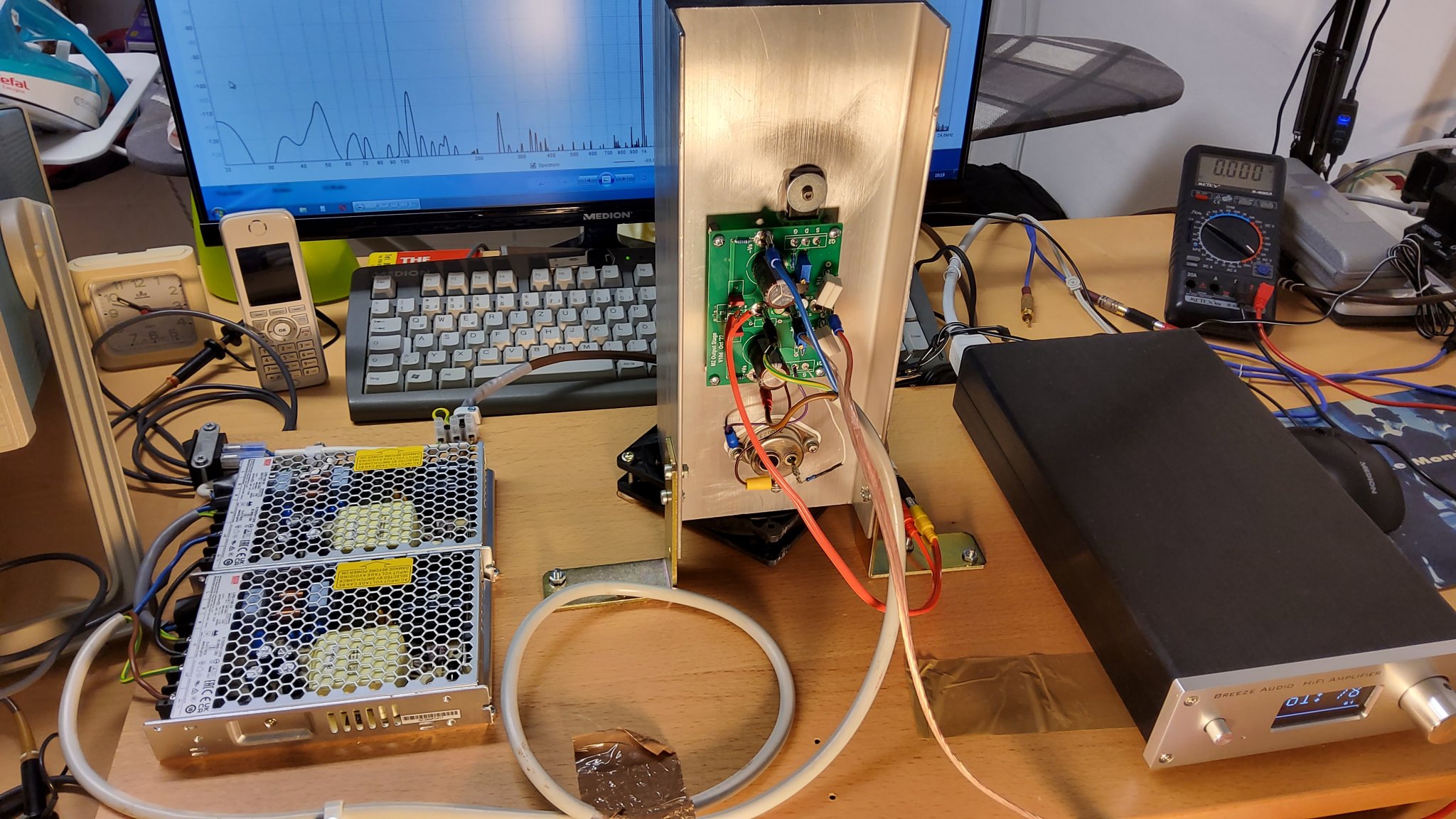

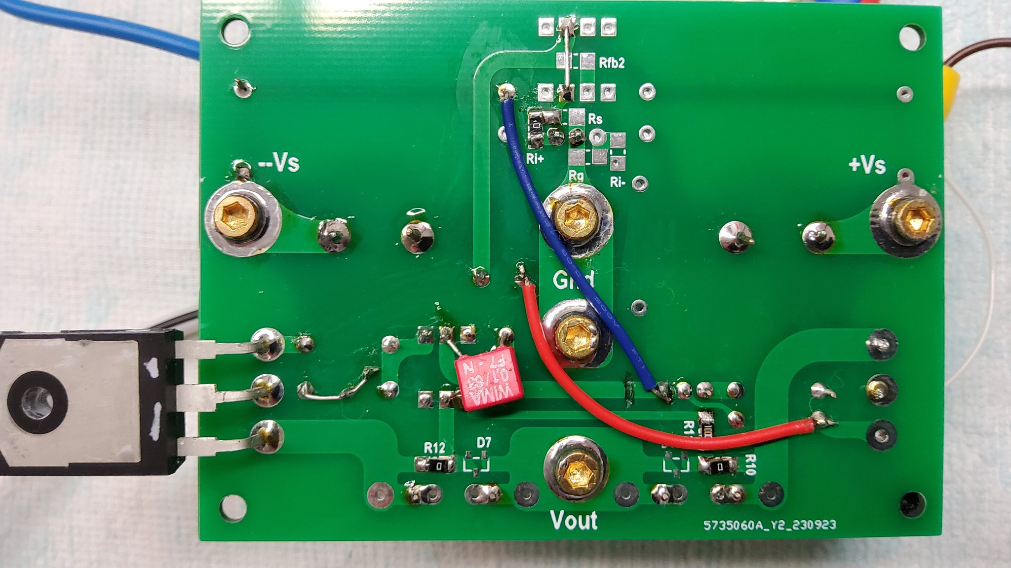

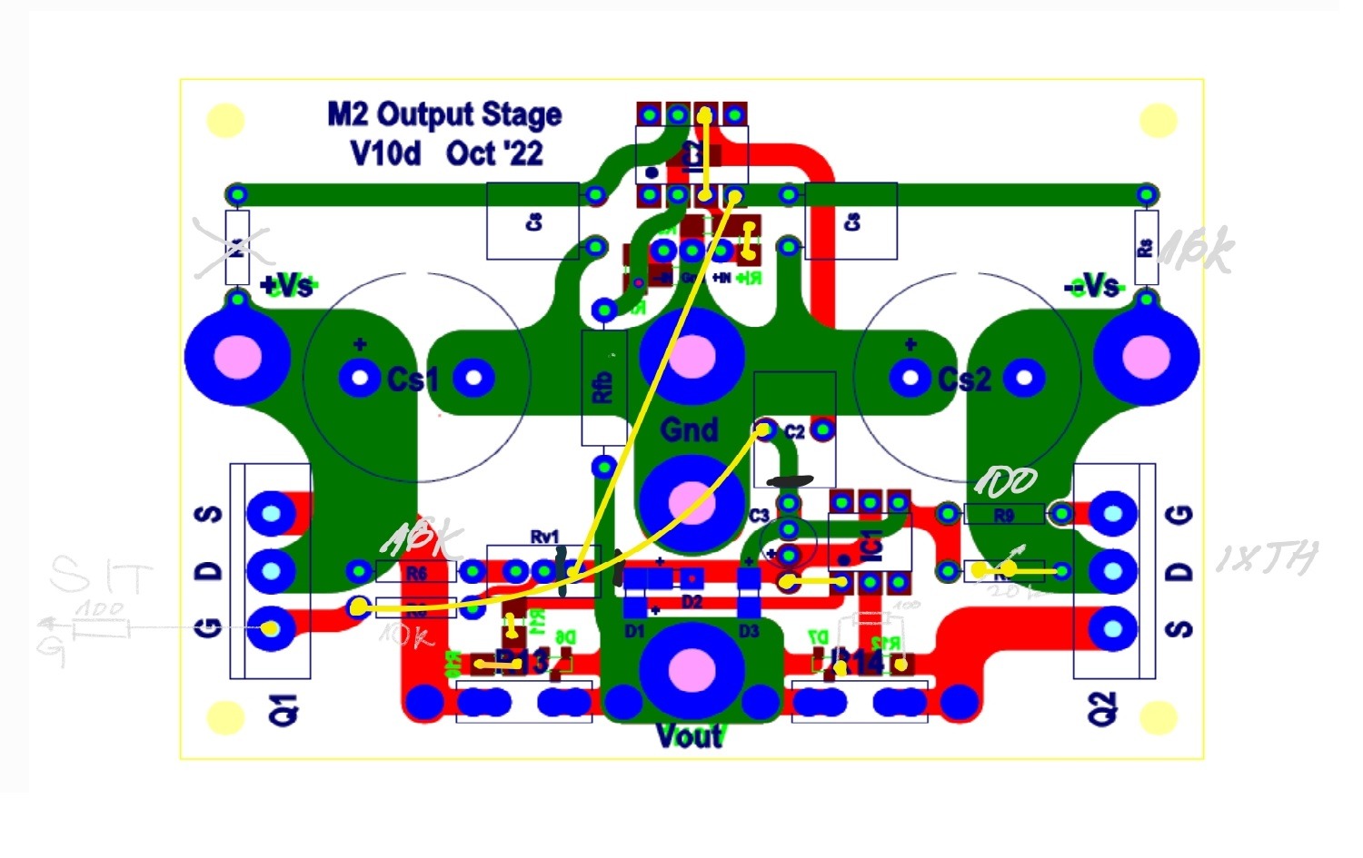

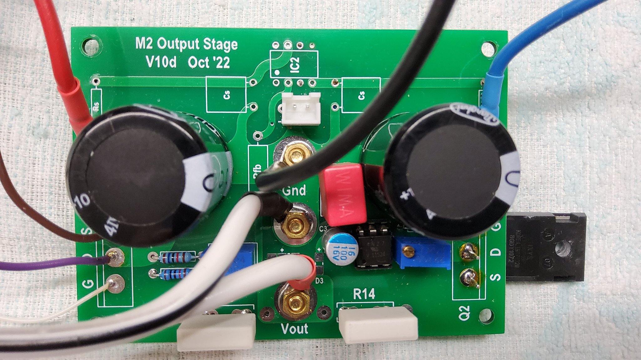

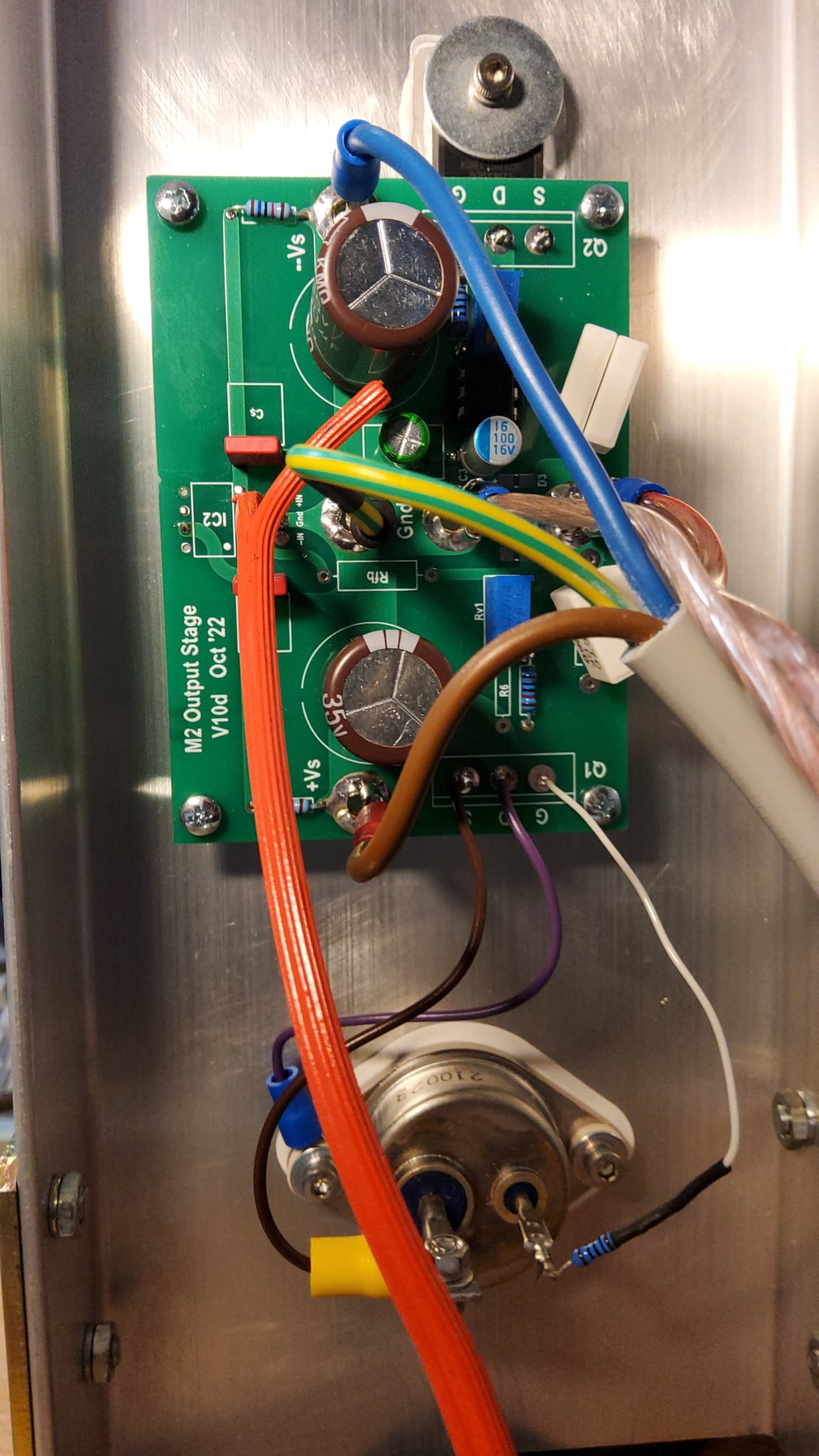

My exiting story with a SIT-muFF using a dual rail supply has finished in a monoblock chassis.
I was too lazy to design a new PCB and adopted one from the M2OPS project lying in my drawer (many thanks to EUVL for making Gerber available) because of the similar topology. Making two cuts and two additional wire connections it seems to be a simple modification. Some shorter ones and a few holes for the second trimmer were quickly added and drilled.
PSU is standard for FW amp projects with CLC configuration giving +/-23.5 V dual rail.
Bias current was easily set to Iq = 1.4 A and offset was stable remaining within a few millivolts. Max output at 4 and 8 Ohm is halved as expected comparing with +60 V single rail supply. THD spectra also look good.
It is interesting that there is no thump while switch on and a negligible fart when switching off. There was no wandering DC offset observed within 3 months of almost daily use.

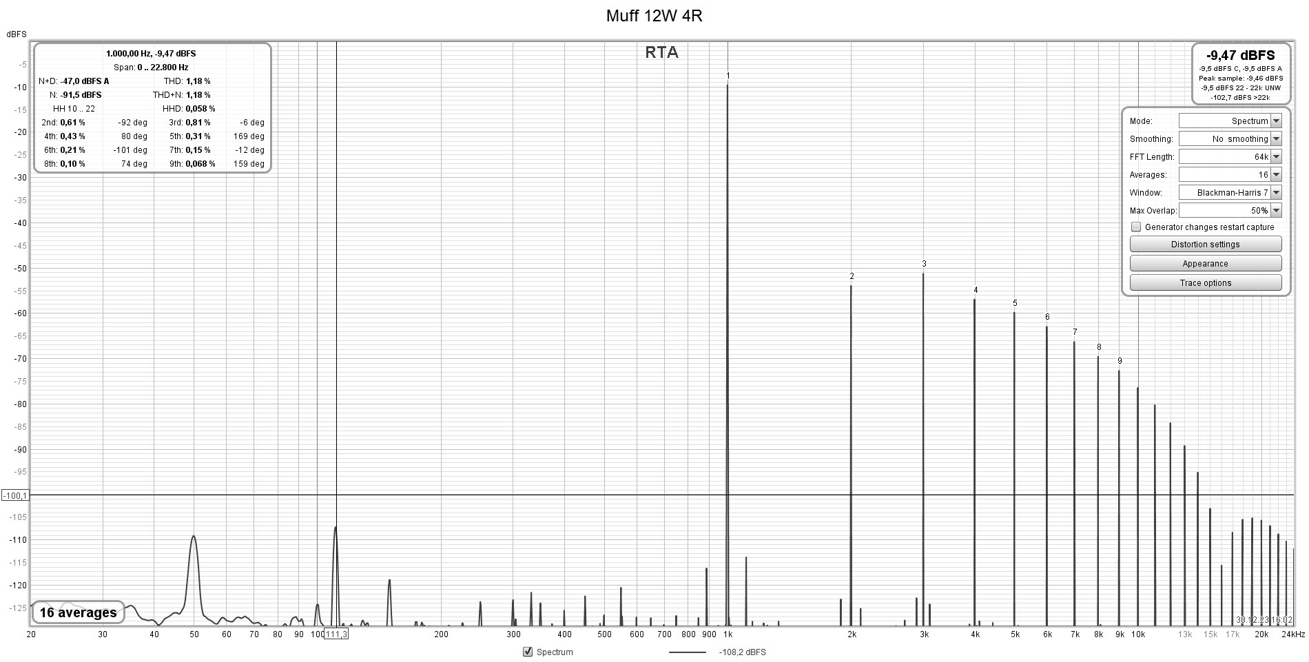

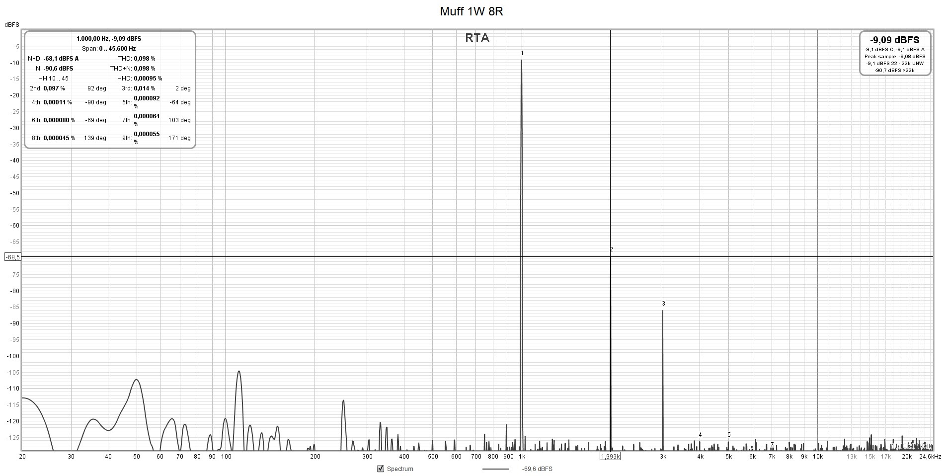

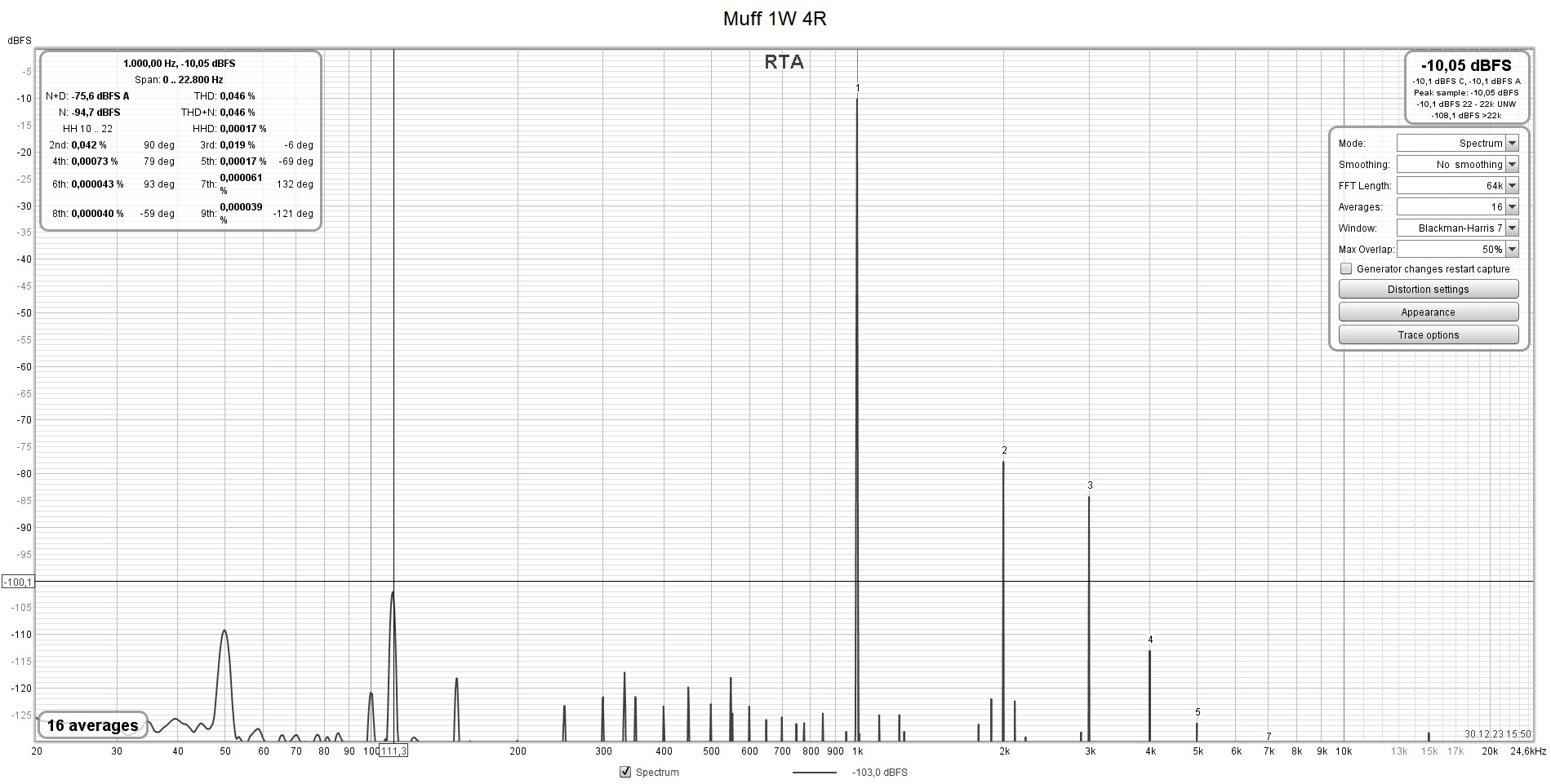

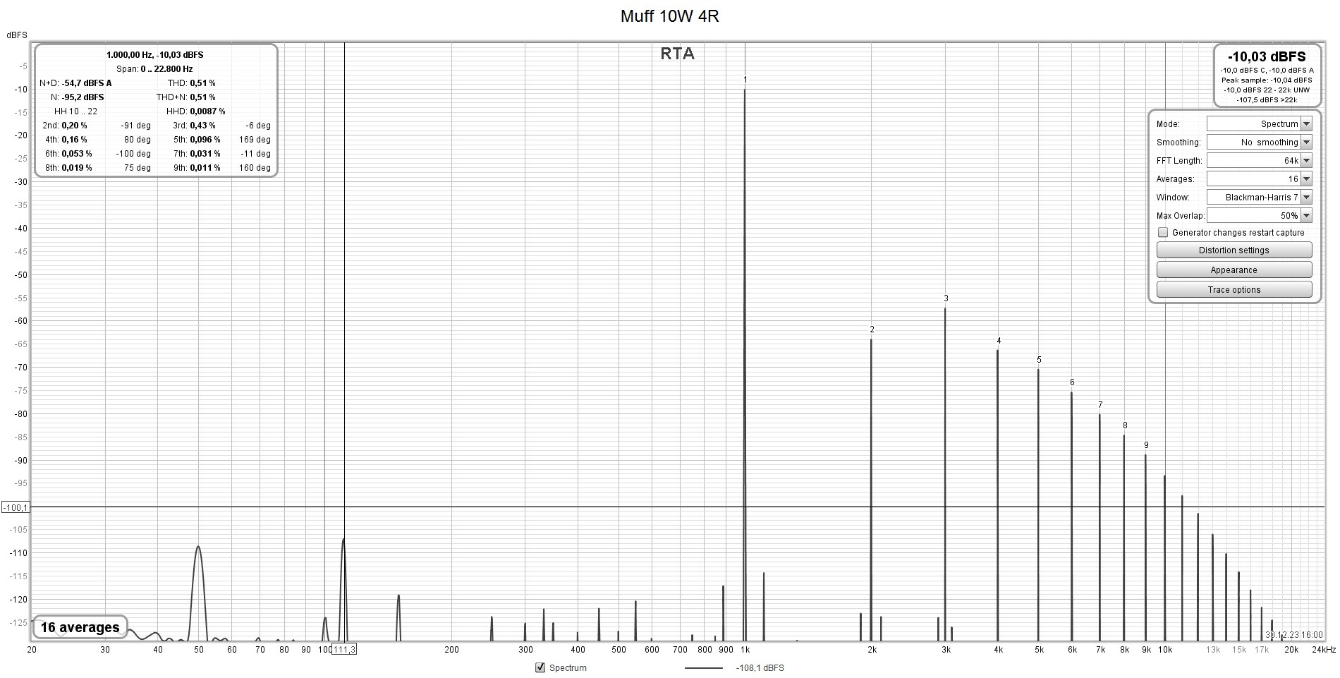

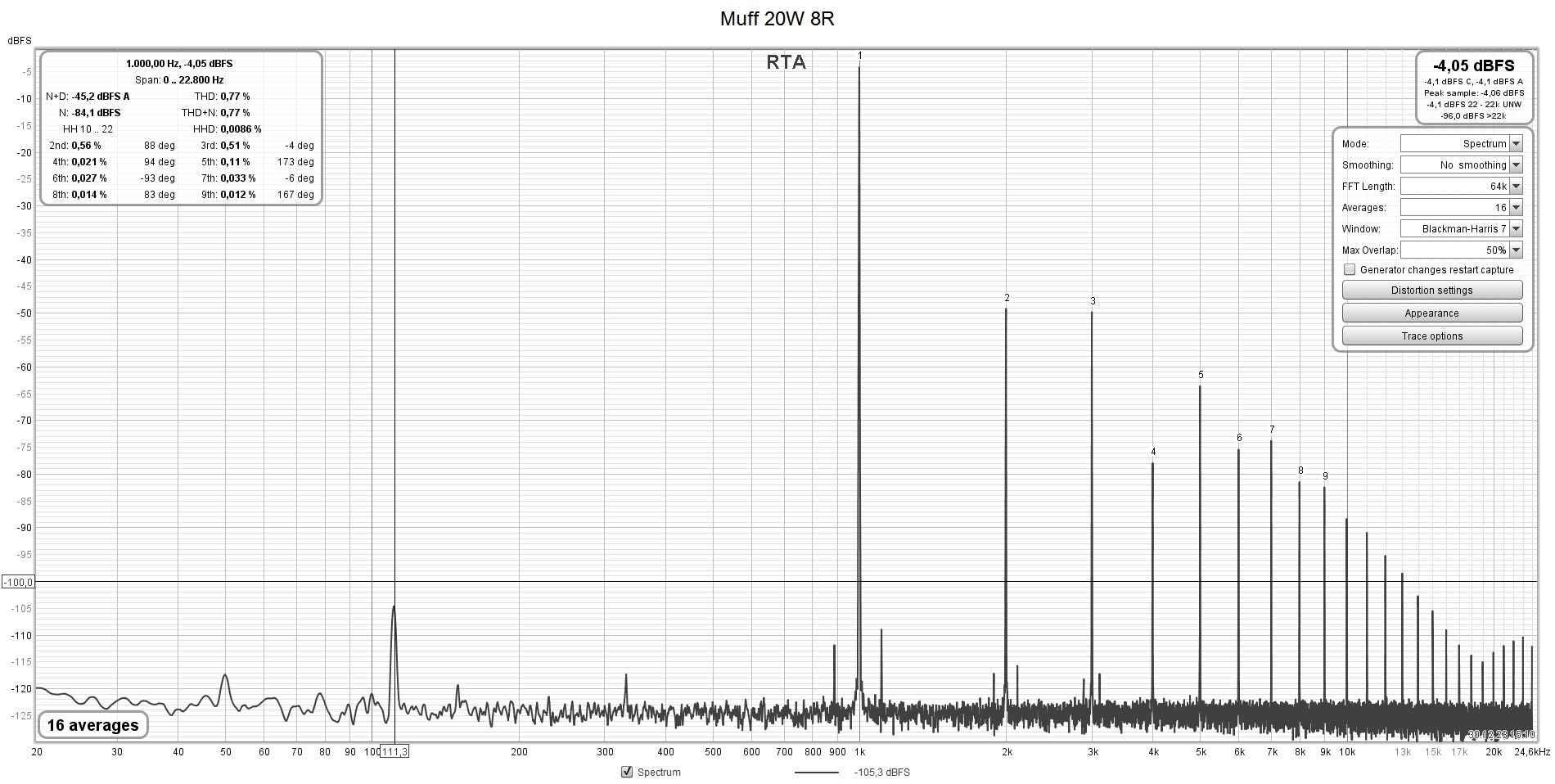

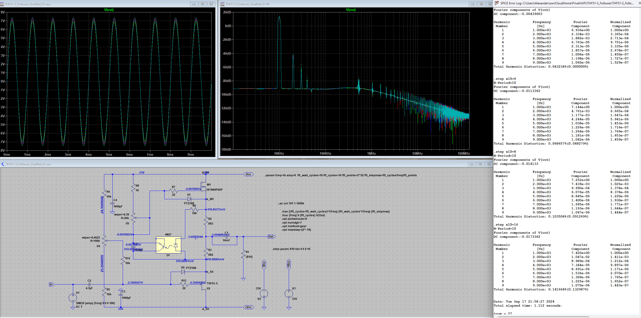

LTSpice models that I used in my simulations:
.model IXTN40P50P VDMOS(pchan Vto=-4.5 Kp=12.43
.SUBCKT thf51 D G S ; Drain Gate Source
+ PARAMS: MU=43.571 X=1.494 K=1.339 N=0.902 VCT=0.831 RG=5MEG
B1 D S I=K*PWR(URAMP((V(G,S)+VCT)+(N*LN(V(D,S))+(V(D,S)/MU))),X)
FOR MULTISIM COMMENT OUT ABOVE LINE () AND UNCOMMENT NEXT LINE
*B1 D S I=K*PWR(MAX((V(G,S)+VCT)+(N*LN(V(D,S))+(V(D,S)/MU)),0),X)
R1 G S {RG}
CGS G S 5000P
CGD G D 5000P
CDS G S 0P
.ENDS thf51-1x0063
I used the hockey puck version of the mosfet for its power handling capability. I also chose the hockey puck version because others have used that size for similar amplifiers. I run it at 3A now and about 30V, so approximately 90W. The SOA of the device needs to be examined and the ability of the device to operate safely at DC and actual operating temperature needs to be reviewed. The TO-264 version may work as long as it has adequate heat management and is operated within its SOA.

Thanks for the model an the comments. The IXTN40P50P model provicdd by IXYS seem to be broken or at least not compatible with LTSpice.
I managed to modify the schematic for +/- 33V rails and about 3A of quiescent current.
Simulation results look promising so far. Dissipation of is approx. 100W per device, as expected. Still need to check SOAs.
IXTN40P50P vs. IXTK40P50P: RthCS of the latter three times as high. Nevertheless, 0.5K/W heatsink should be sufficient.
