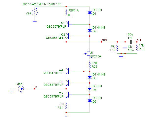

Michael,
I built it a while ago on vero-board, it's quite easy.
IMHO it sounds better than the active I/V posted in the "simple I/V" threads, but not as smooth as the folded cascode. YMMV.
I used just the raw supply for the positive rail, no need for regulator because of the constant current for the LED/diodes references.
Thank you Rudolf, I´ll try that version. I guess for a TDA1545 I have to replace D5 with a 1N4148, anything else to change? What type of capacitor do you recommend for C1? 100µF is a pretty high value that makes a a "better quality" cap pretty expensive.
How about driving a passive preamp from this stage?
- don't think any change needed for TDA1545A, except Riv/Civ
- use whatever cap YOU like. I just used 100u for simulations, 2.2u Audyn KpSn in real life.
- well..., try, and let us know
The intend was to keep it simple, active stage with low parts count, just one rail in stead of two, using raw supply.
For really low parts count, one can even ommit casode transistor in the current sink (Q2, D2) and the common base (Q3, D3) as well.

Watch out for OP voltage compliance of DAC, In other words,
what is the optimum DC level for dac OP. Your dac feed in point
is sitting at about +2.7V ? Shouldn't this be 0V?

As mentioned earlier, this circuit is intended for TDA1543, (TDA1545A as well) with dac output voltage compliance of 1.8V~ Vsup-1.2V
Bricolo, at a first glance what you ask is not trivial.
The emitter of Q4 is at a fixed voltage (2Vled - 0,7V), and you should bring that node to a voltage suitable for the DC compliance of the 1541, which is much smaller as I recall.
However, if you bring the Idac node too low the current sink tied to Gnd can't work anymore, hence a negative supply is needed...

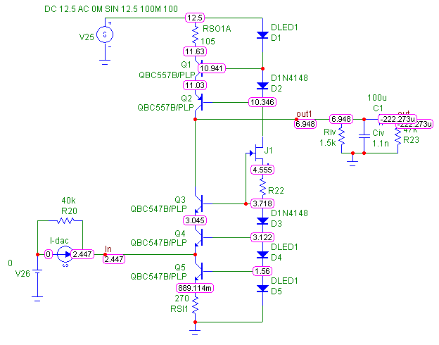

A revised schematic wouldn´t be useful, I built it according to Rudolf´s schematic, only difference is the BF245"B" instead of the "A" (couldn´t get the "A" type) and a 2,2µF MKT output cap instead of the 100µF in the schematic. I can´t measure right now, but voltage drop over the lower 2 LEDs (D4/D5) is 2V/LED and 0,7V for the 1N4148 (D3) giving 4,7V total. D1 seems to be not as bright as D4/D5, and voltage drop is a llittle lower. Power supply is 12,5V from the I/V opamp socket. I´m using green LEDs, as Rudolf suggested.

Michael,
I think you're hitting a rail, your reference current is too big I think.
You will need a multimeter.
The BF245A together with R22 forms a constant current course.
Measure and choose R22 such that you get about 1mA
When using the BF245B, you need a higher value for R22 (measure with 2.2k for R22 as a starting point) to get the same 1mA. You can also use a LM334 (see its datasheet).
I hope you guys read the other threads as well and understand RSO1A is a potentiometer. Michael, when using the same Riv and Civ, I would suggest a 200 ohms potentiometer, set right in the middle (105 ohms) is good starting point prior to adjusting it.
When playing no music, I would adjust RSO1A such, that voltage OUT1 is right in the middle between VB(Q2) and VB(Q3). This gives the same clipping margin for positive and negative output swings.
R23 is there for simulator only, I never installed it.
When using the 3k3/220pF from the original CD723 opamp I/V,
you just need to adjust RSOA1 higher, say 150 ohms.
Here are some voltages for your application, hope it helps.
