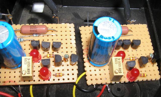

Yesterday I adjusted the SE output stage according to Rudolf´s post (#68). Current through R22 is now approx. 1,1mA, with RSO1A at 180R Uout is at about 7,5V. I couldn´t fine tune this value because I had no suitable potentiometer at home.
Hum is slightly less now, but still there. Powered by a 12V battery the hum is gone, and as good as I can tell by listening to one channel only, sound is really sweet compared to the opamp I/V stage (AD712, muting transistors removed, no output caps).
Output is definitely lower than with the opamp, could I increase it by increasing Riv by a factor of Iout1543/ Iout1545, this is 2,3/1 and gives Riv at 2,3*1,5=3k45? What value should be Civ then?
What can I do to get rid of the hum without using battery power?

As I posted earlier, the Philips CD713/723 players are using 3k3 and 220pF for I/V conversion. Your Marantz CD38 circuits are almost identical.
But, you do need a higher supply then, which probably is not available.
I've got no 100Hz problems, don't understand why you're having problems. If you start using a regulated supply, it needs to be higher again to compensate for the drop over the series regulator.
You do have capacitance after the rectfiers for your raw supply I hope ? You can increase it to lower ripple.
Since current draw is constant, you could also use a capacitance multiplier for minimal drop.
I do suggest another fet with lower IDDS (and low GOS) to replace your BF245B.
My suggestions are: J202, BF245A, J113, 2n5484
What are the current VGS and VDS when it's set for 1.1mA ?
The 180 ohms for RSO1A seems a bit high...

OK, I didn´t get this the first time, sorry.
If I understand correctly, my hum problem is a result of using lower supply voltage and a less suited fet than you suggested which is a really bad combination.
I´ll try to replace the fet first, if it doesn´t solve the problem I´ll use a dedicated power supply at a higher voltage. If the hum is still there after that, I´ll use a regulated PS.
Yes, it´s the V+ supply of the (removed) I/V opamp. I also tried 470µF direct on the veroboard, didn´t make a difference.

OK, couldn´t wait, squeezed out a few minutes and measured all the voltages. Supply is 12,76V, RSO1A is 148R, BF245"B" instead of "A", R22=2k64//5k52=1k79, green LEDs.
Voltages at nodes right part of schematic: 0V D5 1,89V D4 3,80V D3 4,47 R22 6,66 BF245B 10,16V D2 10,82V D1 12,76
Voltages in left part at C and E of transistors: 0V RSI1 1,165V Q5 3,07V Q4 3,75V Q3 7,93V Q2 10,84 Q1 11,52 RSO1A 12,76V.
I hope this doesn´t create too much confusion, I´ll make a drawing ASAP.

Voltages seem ok Mihu.
I just opened the player, I noticed I used red LED's in stead of greens.
In fact the color isn't that important...
Hooked it up, cranked the amp fully open, no hum problems here.
You either have an enormous ripple on your supply, have a very high gain on your amp, picking up hum through your wiring or are doing something wrong.
Simulation also verifies correct operation without hum problems' ripple surpression is about 150 times.

Rudolf and All,
my output stage is finally working! I changed my BF245"B" for the suggested "A" type and use red LEDs now, and the hum is gone!
I adjusted voltage OUT1 to 7V, as Rudolf recommended right in the middle between VB(Q2) at 10,5V and VB(Q3) at 3,6V. Then I played music and turned the Pot in both directions until I got distortion, then adjusted between these extremes and ended up at 7,5V Vout1.
I could only listen to it for some minutes today morning so I can´t really tell yet, but there is more detail and soundstage got more depth. Maybe there is a little more background noise than with the AD712 opamp output, but all in all definitely better.
Thank you for sharing this circuit and for your patience and help!

mihu said:my output stage is finally working...
Now that wasn't too difficult, was it
Considering the ripple on the supply;
I noticed I used 1000u per channel, so that is 2000u total
Mihu, after getting used to the sound you can tweak some further by increasing the current sink, by lowering that 270 ohms RSI1 resistor.
If I remember correctly I used 100 ohms for RSI1, that's about 10mA. The upper current source shall need to be increased of course by lowering (potentiometer) RSO1.
