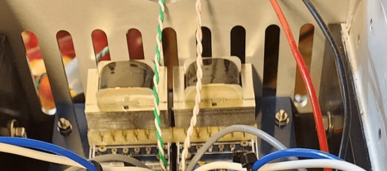

no GGChoky,
I mean the interstage transformer (600/600). Half or quarter watt?
there is no Watt in signal xformer
as written on schmtc- take any of these:
Edcor PC 600:600
Jensen JT-123-LPCH
Cinemag CMOQ-4LPC
Cinemag CMOQ-4HPC
Edcor is ridiculously cheap, Papa's find and reason that he's laughing every time when he remember getting to them, in first place
Cinemag ( any of two) is my pref.

@nautibuoy make a simple test for Magnetic couplings... signal in R channel ,speaker out only on L
Already thought about that earler today and it's on my list of checks to do but first I have to get the second channel set-up.@nautibuoy make a simple test for Magnetic couplings... signal in R channel ,speaker out only on L
