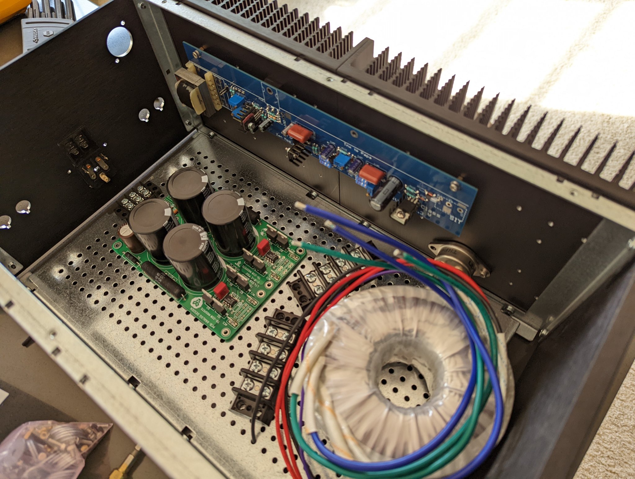

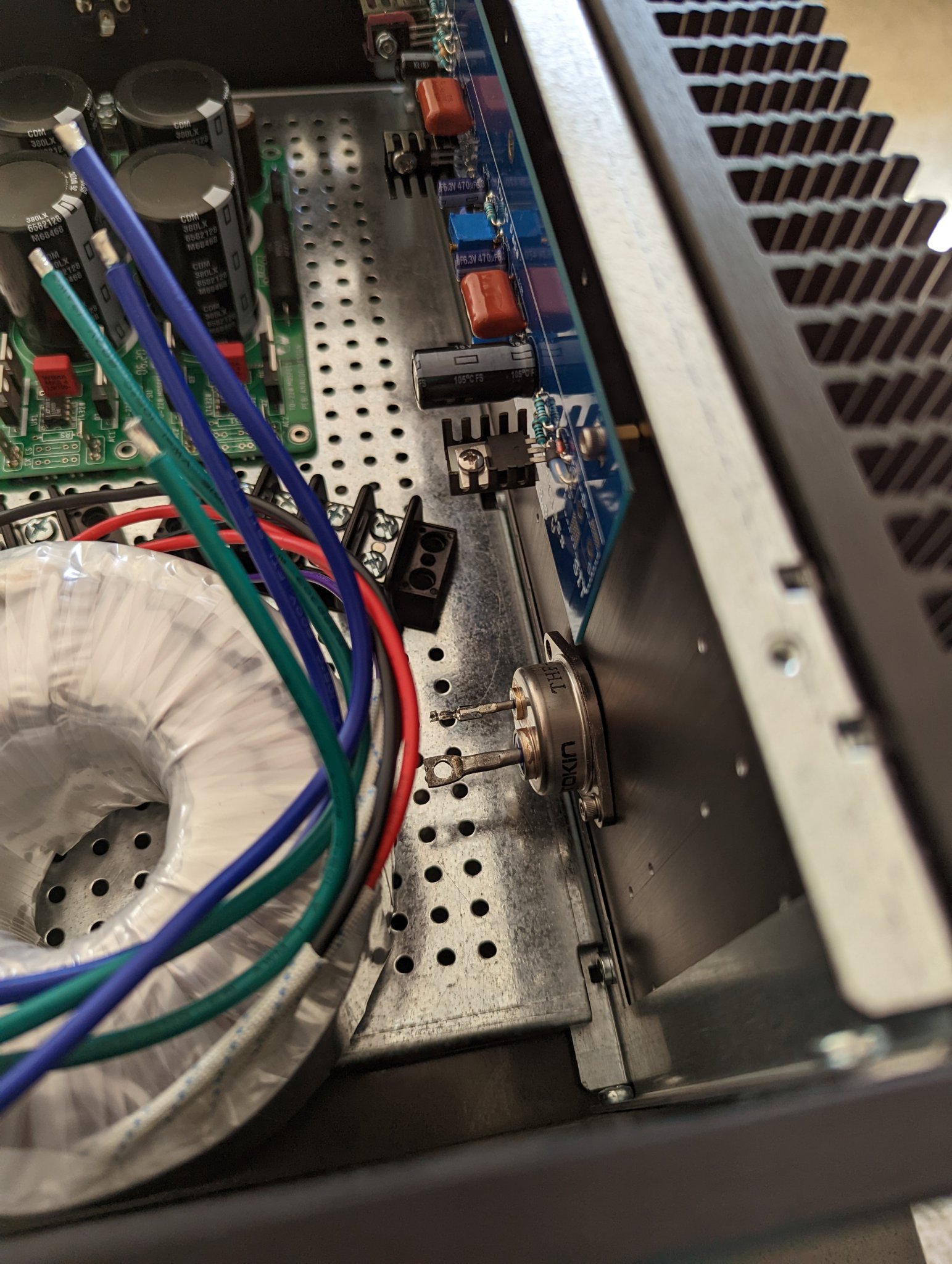

Hope to start building the Sissy this week. Can't wait to hear some SITs from a Mighty design >
Hardest part will probably be forcing myself to take things nice and slow.
Any tips on drilling the rear panel for the panel mount fuse holders?
Since I'll be using the new Modushop mono chassis, would ZM & folks here recommend placing the donuts at the front of the chassis to try and minimize EMI (near rear panel I/O)?
Need to try for the best spot to mount fuse holders, then plan layout for power supply.
Oh, and the R.3 PCB doesn't share design with Babelfish, right? So I can mount components (diodes) per the silkscreen orientation?

see my latest posting in LuDEF thread for short photoshoot - how I'm orienting parts in more or less best way
regarding orientation parts - with R.3 everything goes as printed on pcb, no worries there

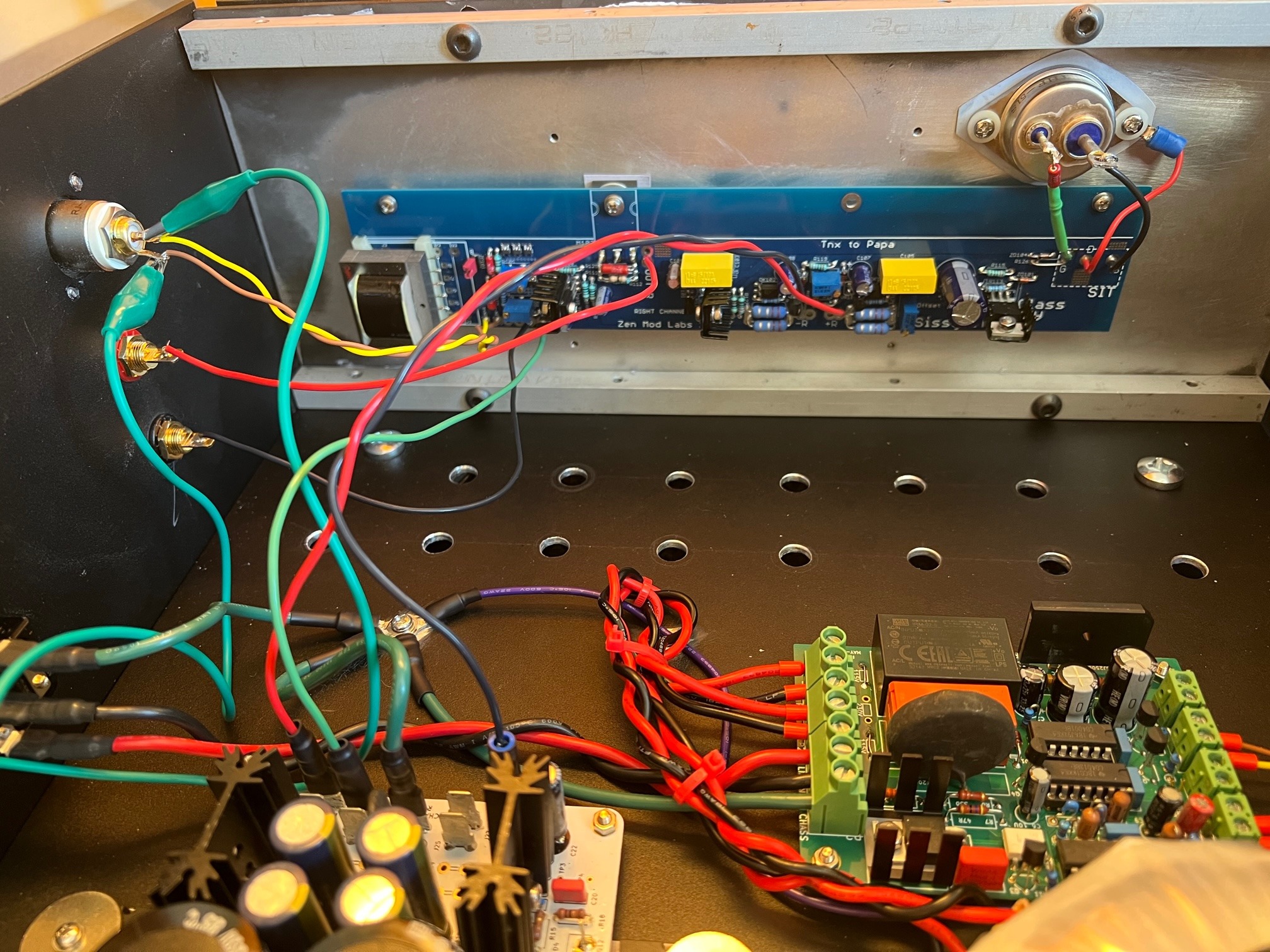

Back onto my SissySIT build today, installed the speaker terminals, input sockets and a switched shunt attenuator on the front end.
Rechecked all the bias and offset and had a listen using some old the Mission speakers. Not an ideal test arrangement, my smartphone didn't have enough gain so I ended up using my Noir HPA as a preamp, and the Missions haven't been used for a long time, so the music was a bit compromised. After 30-40mins the SissySIT was just starting to warm up (literally) and the speakers were starting to relax a bit so the sound was improving and there were clues to this being a really good amplifier.
The build is all but finished now, all that's left to do are front and rear panels for the chassis.

Seems I need to figure out how to mount my transformers vertically.

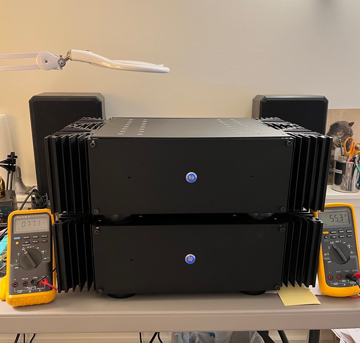

Finally completed my Sissysit. Had been contemplating this project since the first version of the boards. Waited until R.3 to complete as it seemed like a more simple and reliable way to ensure that my SITs were within the acceptable range. Although Pras had measured and they seemed fine. I double checked and the were
Big thanks to ZM and Nelson for making this all possible. I have been following along on this forum for nearly 18 year now. For this project picked Chassis that I had built 15 years ago. Heat sinks salvaged from someone’s Zen project gone wrong. Had them cut and made in to two chassis. Altogether each amp weighs 40lb. As they are each mono could remove heat sinks on one side and likely make another pair of monoblocks although I have no desire to tap heat sinks ever again. Didn’t want to try and fit two, two cap banks and two soft start modules in one chassis and power supplies as dislike working in that tight of space and concerned about hum. I located the transformer as far as possible from the cinemags. No hum to my ear on test speakers.
Also decided to use Mark Johnsons soft start as wanted to be able to turn the amp on from the front. As I disliked playing twister any time I wanted to listen to music. Works very well. Thanks!.
I was lured by the thought of miniscule power supply ripple and used “SLB” Smooth like butter cap mult. Was planning on about 5 V of dropout and picked the antec 4222. So one transformer and one SLB per chassis.
To my surprise everything worked first time in regards to power supply and soft start. Ended up with 31.4V unloaded from the SLB. When attached to sissysit boards came down to 29.2 V and when attached to speaker and playing music came down to 28.8 V. Seems a bit high for a firstwatt type amp. Had anticipated about 4-5V drop. My line voltage is 124-125V AC
Do you think that this will present any problems?
ZM Mentions concern about the IRFP down (I assume this is the 9140?) power dissipation being 45-50W. I’m not sure which way is up or down most of the time so excuse my confusion. Post 624, “sole thing to take care of his dissipation of puny IRFP down (45 to 50 W with exquisite cooling arrangement)”
Although I am certainly confused by the data sheet Power Dissipation (Max)=180W .
The IRF510 Has Power Dissipation max of 43 W. Anyway I really didn’t want to break the parts. So am I correct that power dissipated by each part Sit and mosfet is P=IE or 1.8Ax 28.8V=51.84W? or roughly 100W per side? Given my higher power supply rails.
The build went well and double checked parts with my trusty DMM. Powered up with Variac and proceeded to adjust as per mighty ZM’s instructions.
The amp power up went well. Able to follow clear instructions and able to figure out what way to turn the pots. Able to get the bias up to 160mV across the sensing resistor, set DC offset with input shorted, then set the buffer to 20mV and 0 offset and replace the jumper. Then on to 198mV for 1.8A. Able to set the DC offset with inputs shorted. Bias remained stable through out the testing.

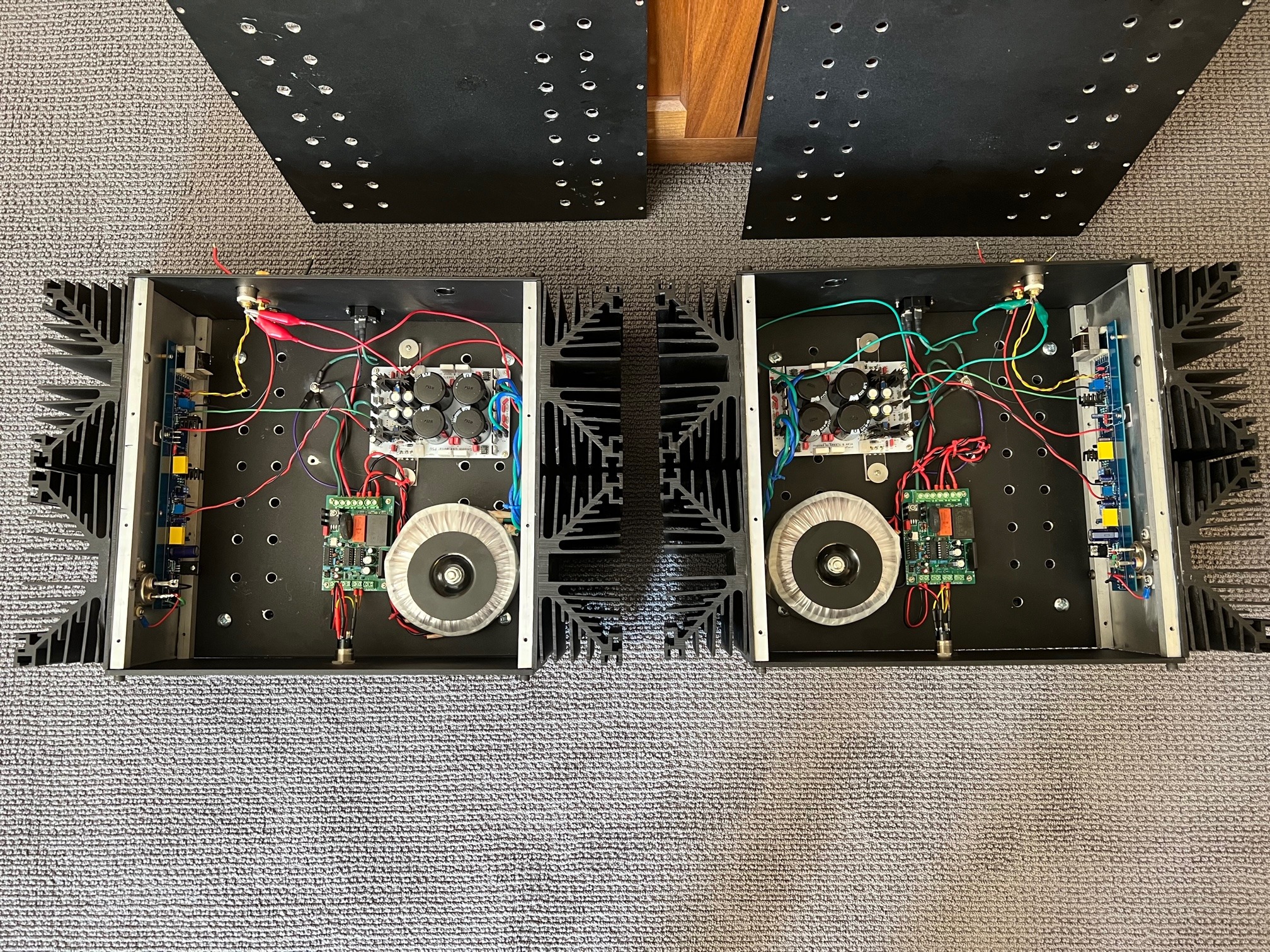

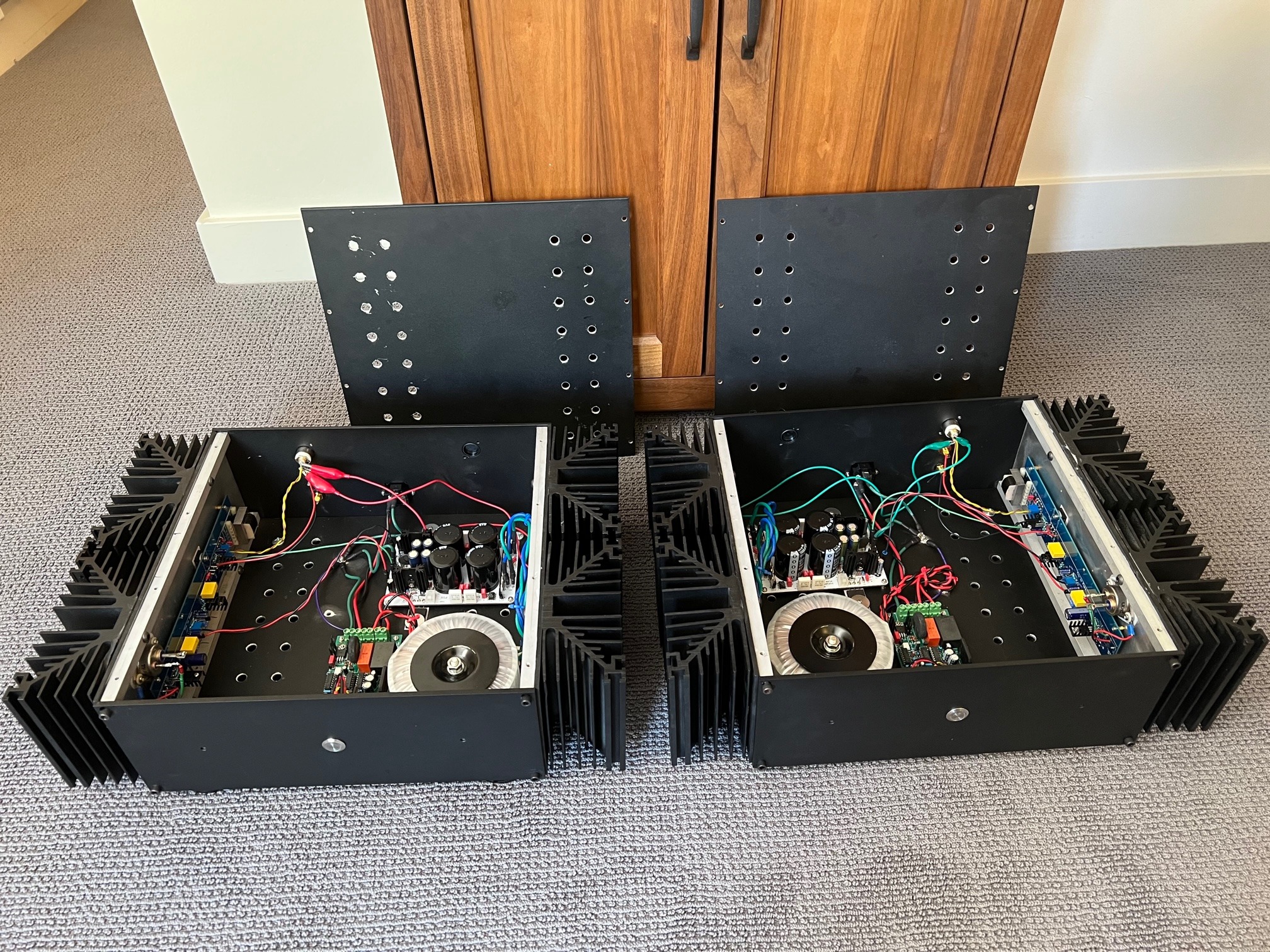

So the good news is that it works. Sounds quite nice on some ancient bookshelf speakers with iPhone as source. I realize that I can tolerate some DC offset but seems something is a bit touchy. Hopefully something can be done to tame this offset issue. Once I can verify that these are well behaved Big Sissys would like to have them play with my Harbeths and give my F5 a breather.
And for reading all this I present some pics. Many thanks to ZM for the endless support and answering the same questions over and over and over. If he could only answer why I can't remember the answers or why I forget to use the search function....... Also big thanks to Nelson for leading the way. I wouldn't have been down this path without them and the encouragement of all on this forum!

Left Channel measurements after reaching thermal stability
IRFP9140 Vgs=4.068 Voltage drop across gate Resistor R225=1.9mV
IRF 510 Vgs=3.386
Bias Voltage across R0R22 resistor =198mV
Voltage drop across Level Shifter R215 = 3.27V
3V27 across 120R means roughly 28mA Iq of level shifter Source follower ( IRF510)
now, present difference of Ugs between upper and lower mosfet is 4.068V-3.386V=0V682
which means - for equilibrium of upper and lover Ugs we need to compensate Level shifter resistor value for that voltage drop
so, R=U/I=0V682/28mA= 24R
conclusion - increase value of R215 for 24R, so just use first standard value - 150R
same logic applies for other channel :
Right Channel measurements
IRFP9140 Vgs=4.086V Voltage drop across gate resistor = 0.0 mV
IRF510 Vgs=3.515V
Bias voltage across R022 resistor =197mV
Voltage across level shifter R115=3.534V
3V534 across 120R means roughly 30mA Iq of level shifter Source follower ( IRF510)
now, present difference of Ugs between upper and lower mosfet is 4.086V-3.515V=0V571
so, R=U/I=0V571/30mA= 19R
conclusion - increase value of R115 for 19R, so just use first standard value - 150R
all that just to explain how to guild the lily, not because DC offset is critical - it is damn good already taking in account that setting output node level is strictly passive - with resistive voltage divider, no even slightest servo function around
